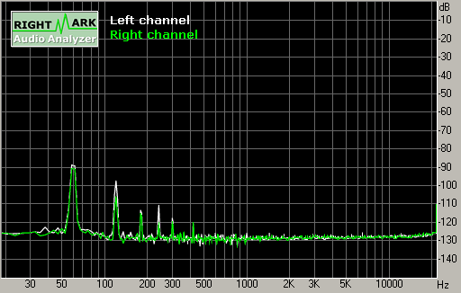

"I think that is to big and then susceptible to stray noise pick up...only for a output stage, I'm afraid."
Not at all! The internals are shielded and the terminals are actually quite close together, about 1/2" solder to solder between the inner tangs. Conicidentally I type this while listening to a single stage headphone amp using exactly those caps in an Ultrapath position around a very high transconductance triode, the 6C45-PE. Keeping in mind Ultrapath is reputedly more prone to PS noise than typical layouts the noise spectrum of this circuit constructed on open plywood looks like (hot off the press
