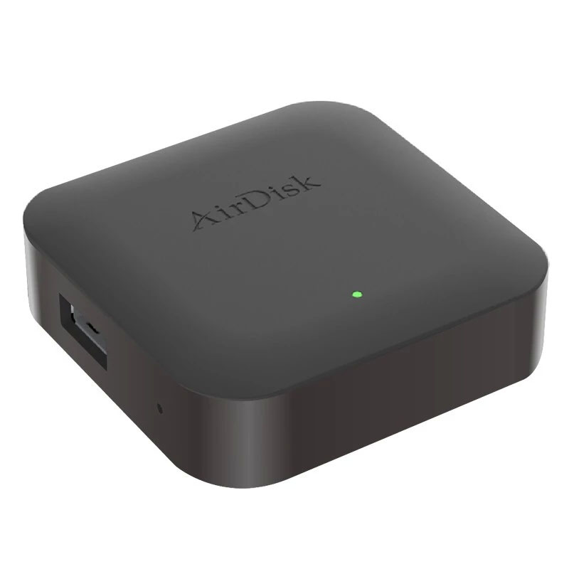

Or to keep your network storage even more flexible, get a network addressable storage device for music file storage. The only problem with this is that manufacturers of NAS boxes seem to make them bulky and expensive, possibly targeting high volume video storage users, not we hifi people. But I have found a small NAS that people here may be interested in - AirDisk Q1-USB NAS
Q1 USB NAS Adapter
It's presently available from AliExpress for US$45.
Indeed cheap, but presumably slow with a large library.
For example the WD My Cloud uses a faster 1.4 Ghz quadcore processor, WIFI and 1Gb memory and comes with an 2TB HDD for 170 $, but if you want several HDD's & Raid features expect to pay double or triple the price.

RAndyB, I see you have a working solution (of sorts) but my suggestion to use a NAS was actually directed at jwags818. I think that NAS unit I mentioned would provide an elegant solution in jwags818's situation.
Let's get some perspective here; we're talking about single-user access to audio files. Even such a cheap NAS in 2021 should meet this requirement satisfactorially. Heck, that NAS may actually out-perform the Synology DS115j which I bought in 2016, which was well reviewed at that time, and the Synology has served me well in combination with my music server for the last 5 years.
