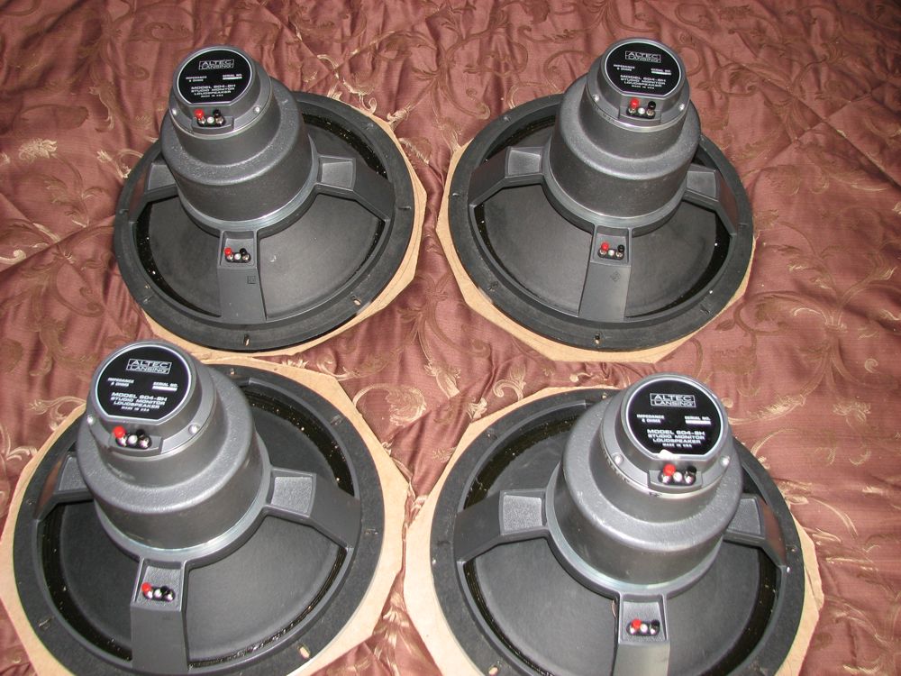

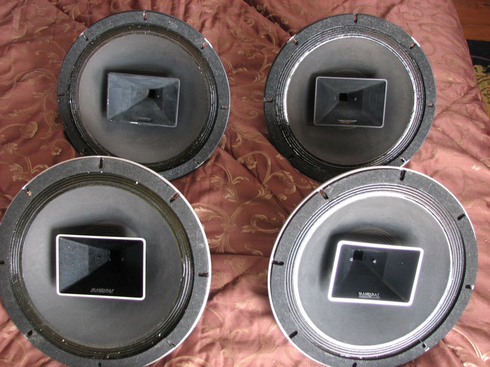

Arrggghhh.... spanner in the works! I've read, re-read and even listened to myself over and over again. This obsession is getting ridiculous! GPA tells me that both drivers sound the same, and the E series is more expensive and only exist because many buyers (myself included) just insist on Alnico magnets.

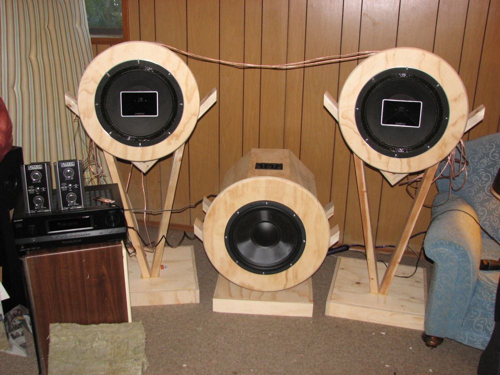

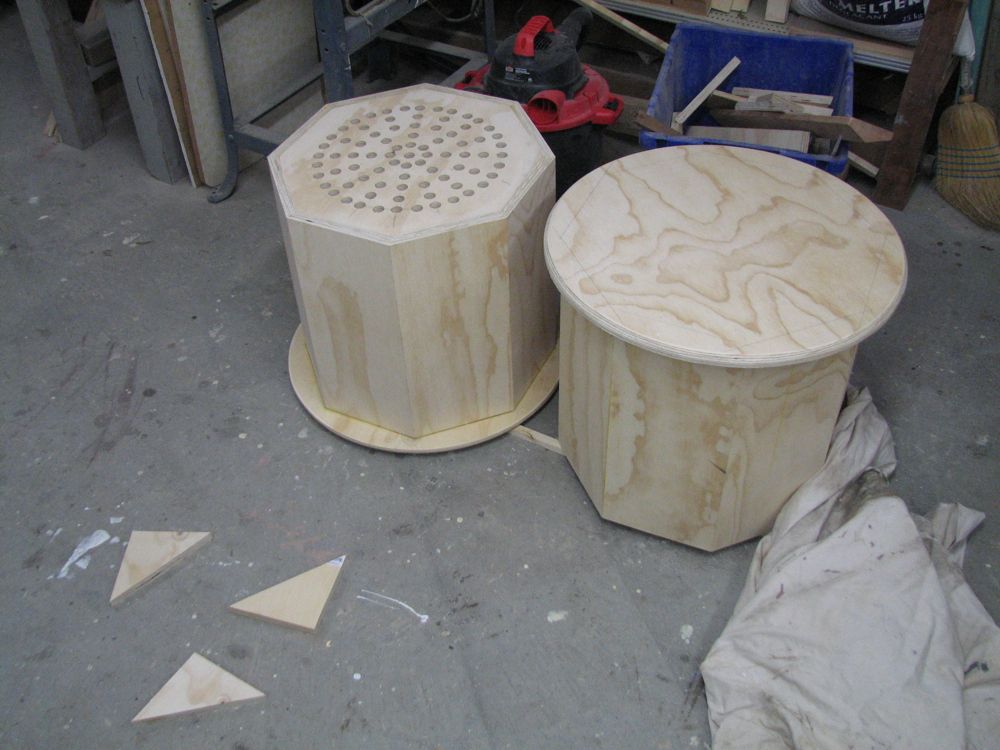

Here's where two of mine ended up (testing stage). Octagon cabs with the holey rears to reduce the boxy sound plus the addition of a helper woofer in a sealed box. Nice combo. Finish comes later. Much later. 🙂
