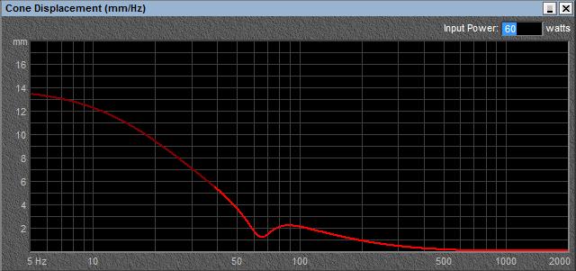

121db@1m with 350W is good however second-last graph of cone displacement shows 5.5mm xmax breached at 57hz and rising fast.
Do I need a steep high pass filter on the woofer at 60 hz to protect it from low frequencies at high SPL? How far can xmax be exceded before damage?
Running my MLTLs from a QSC PLX2402 i could not get the drivers to distort or sound bad with Yello and other electronic music. That is 425 watts to each driver and a lot of deep bas. I did not use any highpass-filtering. All the people left the room because the spl was ridiculous.
I dont use my speakers to play loud, but i wanted to test them. I built them to sound dynamic and "live".
Maybe there is less cone displacement using MLTL with the same SPL? Or am I misinterpreting the graph?
Not a lot of content below 40Hz is at 0dB so you get away with a little more than the sim shows.
I would however use a high pass as there is no guarantee that it won't cause a problem. I hate cones flapping in the wind.
MLTL won't give any magic excursion handling but it sure sounded nice when I listened to the above speakers.
I can't find a number for Xdamage on the 10ps26 but I guess they are pretty durable.
Every ported system unloads below tuning and excursion increases dramatically without a filter.Tried the cone displacement simulation with just 60W. It shows xmax is exceeded with signal below 40hz! What am I missing here guys?
