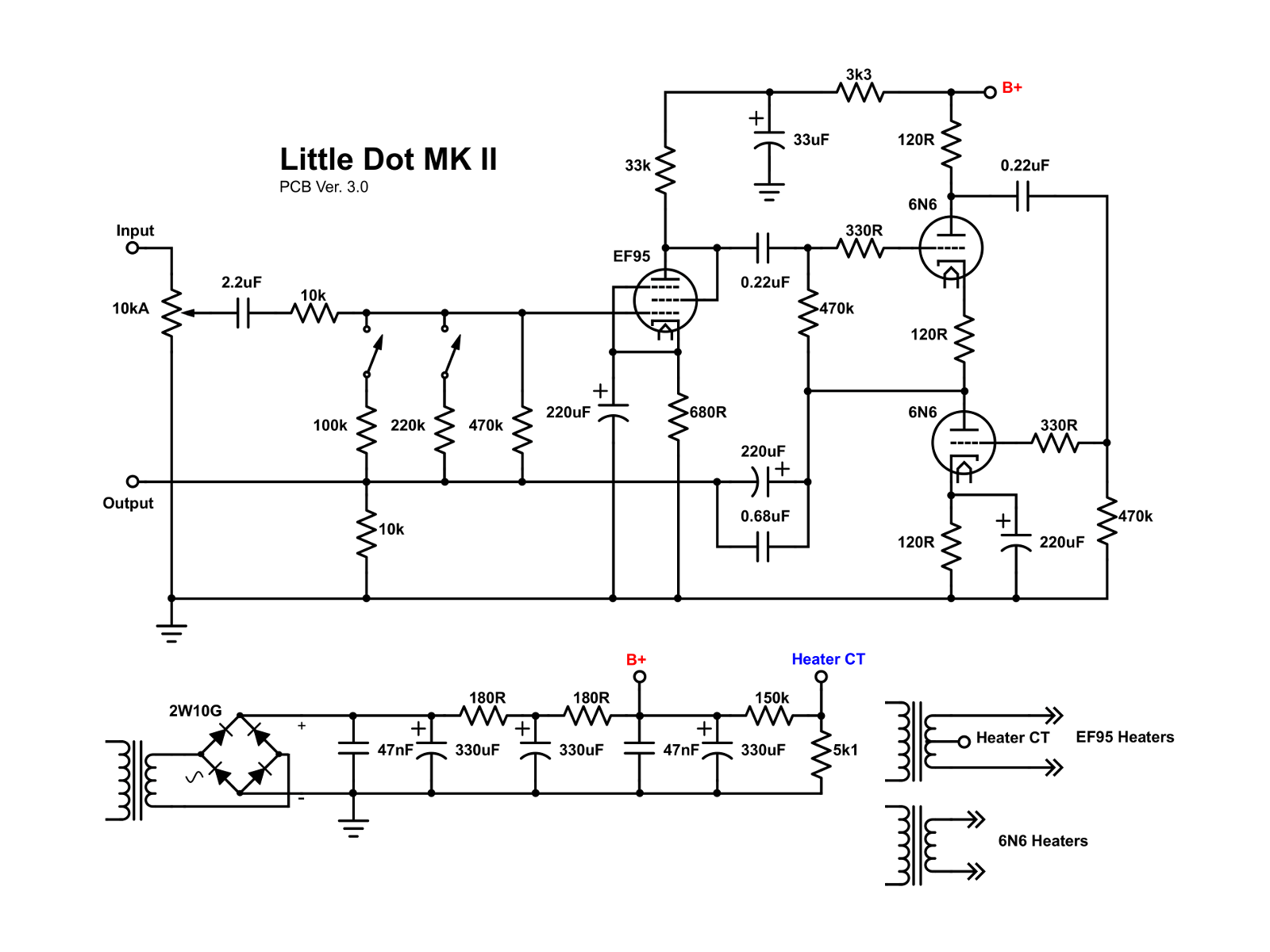

Hey guys need your help I have a little Dot MK 2 headphone /preamp. What I want to do is I'm going to take it out and put it in a different case I don't like the chassis that it's in.
Since I'm taking it apart what I want to know is based on the photo are there any audio upgrades I could do to this film capacitors coupling capacitors something like that you guys think would make a sonic difference in the amp?

Isn't the one in there 10k? If so, I would definitely not change the value.Seems rather pricey, thats on my list already is to upgrade volume pot with 100k
The schematic I've seen has the 10k pot included as part of the nfb loop.
A 100k pot would not work right in that circuit.

Get the amplifier working properly, and to original specifications; before you modify.
Or else you will never know what state it is really in.
An accurate and complete schematic would be very helpful.

No mods have done that i can see, she sits all stock. I use this as a headphone amp/preamp, so 50/50 usage. No schematic is available, well only the headphone section, not the preamp section.
I think for me i want strong bass, tight bass, and well tubes are all about the midrange for the most part, that dreamy, midrange. I'm not saying it's bad right now, it's pretty good, but like all of u,s i want to squeeze the last drop out of it. How much do high-end parts matte? Mundorf cap, good capacitors, how many quality parts better the sound? i can't answer that. Im using HD 6XX headphones, i just changed the cheap tube that came with it for GE tubes and it was a big change, so tubes make a big difference for sure. I love my HD 6xx headphones, I'm just trying to get the max out of this amp. I think the $100 i paid for its use, is the best bang for the buck i have spent on audio, I want to use it as a preamp and also, have a vista spark audio II.

How big are the output transformers?
How much primary inductance do they have?
What is the output tube type?
What is the output tube operating mode: pentode / beam power; Ultra Linear; Triode wired pentode / beam power; or Triode?
What is the plate current through the output transformer primary?
Changing output transformers might make the biggest difference on Bass; but that can be expensive, and there probably is not room for them.

But I do not expect any real improvements for less than $100; perhaps much more than that.
Too many unknowns about the amplifier circuit topology, the output transformers, and any/all negative feedback, etc.

Output is 3 330uf 250b capacitors.................It has a weird output, better explained in link above. Im willing to dump $100 into it, new transformer no problem, remember im putting it into a new chassis, so the new transformer can work., yes, a lot of unknowns for sure.

Those are sitting in the power supply stage.Output is 3 330uf 250b capacitors......
Not that they're not included in the output stage, last cap in the filter Always does.
