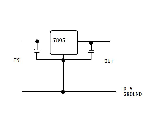

I just wanted to make it clear that the digital power supply board shown in the schematic with the dashed lines is obsolete. I have 3 regulated supplies in its place.
So I'm just dealing with the 5V supply on the board. A+ and D are getting steady +12VDC while A- gets steady -12VDC

Refering to your circuit, what is it you want to do ? Are you saying you don't have the bottom two regulators -/+5 volt in use. It's just the separate top 5 volt one that's the problem.

The part of the schematic that says "digital supply board" that feeds the regulator circuit has been replaced. Everything on the 5v regulator circuit is what we're discussing. I was just making a point that the original ps that fed it was unregulated and relied on the regulator circuit to do everything.

Couple of choices then. Either use the original devices and rebuild it to it's original spec. As these regs are integral to the D/A PCB you are limited with what you can do without major work.
You could still replace all the series pass transistors with IC regulators, and remove the other parts. In your position that's the best option IMO.
I'm better at analog circuits so please bear with me. Which are the series pass transistors? And which IC reg would you use. When you say remove the other parts (I'm always up for less parts) which specific parts do you mean?

The pass transistors are Q1/2/3. It's so easy to fit IC's in their place.
These need two resistors on each to set the output voltage. The data sheet shows how to calculate these, and gives a 5 volt reg as an example.
Even easier is to use 7805 and 7905 regs. Again get the data sheets. These need no resistors at all.

You would literally remove all the other components on your diagram, retaining just an input and output cap close to the IC as possible.
As you seem very unsure, the 78xx types may be the best choice. If you got anything wrong with the LMxx type the output voltage may be higher than expected which may damage components on the DAC pcb.
The 7805 is the positive reg and the 7905 is the negative version.

So then would it be:
Diode - C20- 7805 or 7905 - c26
Bypassing or removing the opamps and all resistors?

If you want to do the regs I can draw what you need to do.
You need two 7805's and one 7905. These should be available anywhere.
You don't really need any extra bits but if you are ordering specially get some small 0.1 mfd 63 volt caps, probably polyester.
The +5v is as easy as,
