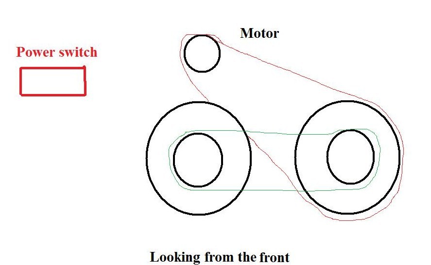

my belts have perished on my Aiwa ADF-770 tape deck after having it boxed up for a couple of years.
Anyone know where I can get a replacement set, and fitting manual as it looks like some of the mechanism has to be dismantled to change them.
Any help appreciated.

Sorry no pics but the run of the belts is straightfoward I remember.
Look down on the mech. Going from memory now.Theres an "outer belt" which is last on and first to take off. It runs in line with the motor pulley to the rim of the capstan nearest the middle of the deck (I think) The belt sits on the flat edge, dont worry it won't fall off, a flat belt like these- think they were about 0.8 mm thick and about 4 or 5 mm wide self centers due to the curvature of the motor pulley. The belt linking the two flywheels was slightly narrower e.g. 3 or 4 mm.
Try some thin strips of paper to get an approx size, then get a belt that is slightly too big, then keep cutting and glueing (super glue -tinyest amount ) to get the correct size, then measure and get new.

hi
wow mooly what a messy lad you are, 😀 the fingers are gonna be stuck to the belt, to the pulley, the paper strips and everywhere else.
bloody horrible stuff that super glue.
heres a method that i use, it is fiddly but not messy just takes a little patience. no a lot of patience
remove mechanism compleatly if poss, cant remember if the wiring is plugged in on this model
wrap a piece of sewing cotton around the pulleys as shown in moolys drawing, while holding it tight and square on the belt path. (try it a couple of times you will get it right)
mark a point where they meet (on both ends of cotton)
lay this piece of cotton out in a straight line and measure the distance from one mark to the other. in mm
i use white cotton and fine marker pen for this
this gives the circumference, divide by 3.142 (pie) this gives the diameter.
then buy 2 belts that are one size and two sizes smaller one of these will be perfect. Did i mention width as well.
do same for all belts. then go to the web site i gave you to order them by diameter,

😀 😀 The cottons a good idea. Have you seen the price Donberg are asking. 12.90 and 17.90 euros.
Get a few from somewhere like CPC or, what no one ever seems to do, approach the manufacturer. In the past I have ordered from Aiwa (for the 770) Sony and Pioneer and Denon. No problem and they are often cheaper far cheaper. The only one that ever kicked up a fuss was Teac. Also CPC are spares agents for Aiwa, tell them what parts you want and they probably have them on the data base.
The pinch rollers are easy to change but you have to take the deck out -- which is 2 minutes of a job. I remember now, you could remove the deck and actually screw it to the top frame with a single screw and work on it if needs be. The idler assembly lives behind the cassette door. That's the most tricky thing to work on. The whole door/flap will unclip (circlips) and hinge up out of the way for access.
