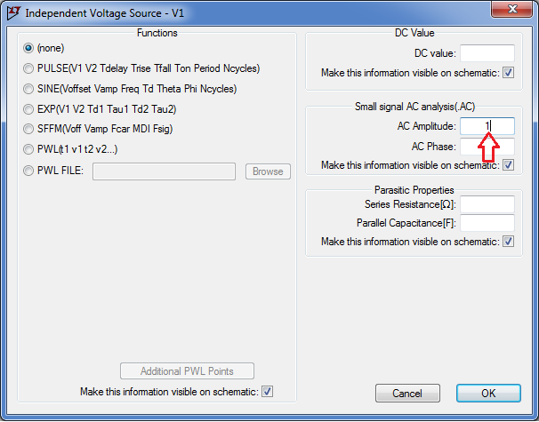

You get a rejection of 50dB instead of 70dB because you didn't use the normalized unity stimulus for the Bode plot: you used 12, which represents a penalty of more than 20dB.
Thank you Elvee. Copied your interesting suggestions and I'll be back for small details if you don't mind. I will redraw a proposed circuit for my particular needs and try to find suitable transistors and MOSFET.
I am really a newbie to LTspice and so, could you please tell me how to instruct LTspice to plot correctly the -70dB as your plot ? I couldn't find such a setting for
normalized unity stimulus for the Bode plot...
Is this an LTspice setting or is it that my input generator signal needs to be changed, when yo say "you used 12" 😕
You need to enter "1" in the amplitude box, unless you know exactly why you need to enter a different value, see below
