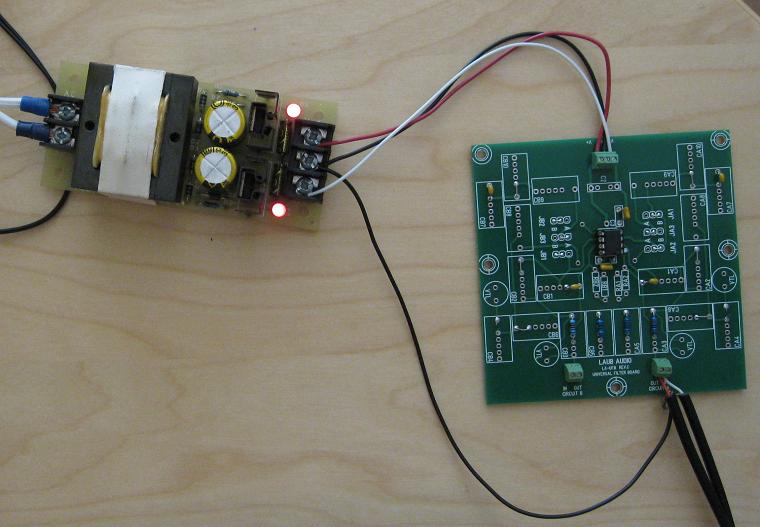

As Davey mentioned, I designed some analog filter boards that can be configured as many different types of functions, including a gain block. They look like this:

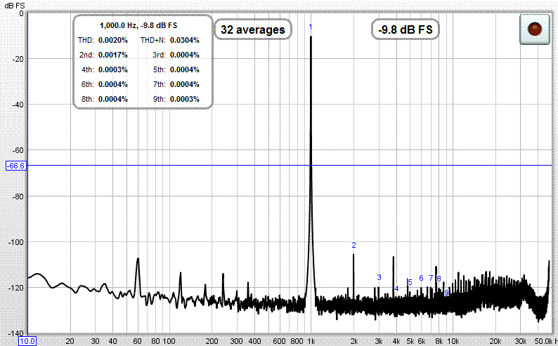

This topic has come up before in this forum. I built up one of my board to have 20dB gain and did some testing of the distortion and FR. See below:
361539d1374458348-4-channel-gain-stage-dc-servo-minidsp-10x-gain-measurement-317-337-ps.gif
361548d1374467654-4-channel-gain-stage-dc-servo-minidsp-10x-gain-stage-frequency-response.jpg
The advantage is that you can set the gain using 1% or less tolerance resistors and it will be consistent from channel to channel.
Each board has two independent channels, so you would need four of them for 8 gain stage channels. Feel free to contact me if you want to buy a couple of these. You can use a simple LM317/LM337 power supply that you can get on Ebay, assembled for about $25 IIRC. I used this to power the board while doing the testing shown above, with everything just sitting on my desk next to my computer. In a metal case the noise floor should be lower still.
