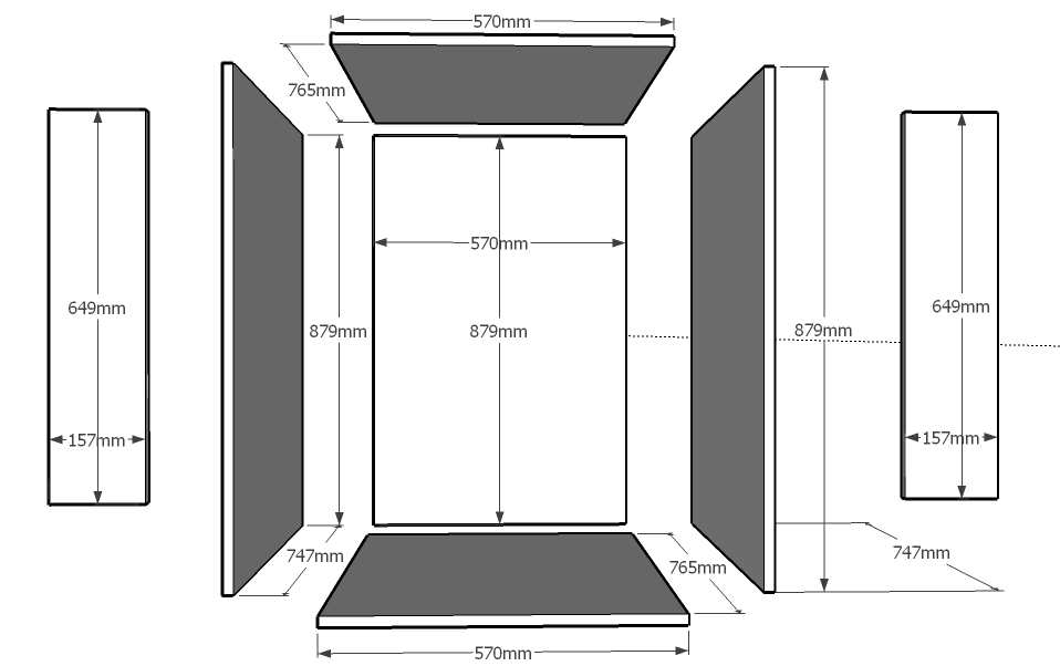

I live in Canada and have decided 2 attempt (lol) to build some manifold style bins for my brothers production company, they will primarily running drum n bass / jungle through these so I will need to get the most bang for my buck. I have been having a hard time finding decent plywood locally so I beleive I will be using 3/4" MDF. Weight isnt too much of a problem, although portability rules out the 4x18" units I would love to build. Most of the events they will be utilized at are outdoor parties so I would imagine I will need to use them in multiples.
Thats kinda the background.... now for the real questions.....
1) does anyone know where to find good drivers in Canada ( slightly north of Toronto area ) ? or should I just order from Parts express and brace myself for the shipping costs ?
2) unfortunately my build budget is fairly small for the time being, does anyone have recomended drivers that wont break the bank and could almost be considered 'disposable' ?
3) how hard would it be to modify the plans to be usefull with the drivers I ultimately choose?
4) with the small budget in mind I could even handle the thought of using 15's or even 12's, but to me that translates into a requirement for even more multiples of boxes.... should i stick with 18's (or 21's if I can find them at a good enough price) ?
These things will need to be able to handle huge amounts of almost continuous heavy bass so they will need to handle being essentially run for 12hrs at a time nearing their mechanical and power handling limits (our djs dont seem to be happy unless the bass essentially feels like the ground will open up under you from the earthquake like vibrations )
Any information / suggestions welcome.....
I have primarilly in the past built systems ranging from small studio monitors all the way to competition car audio ( I like to build my boxes from scratch ) so I like to think I have the woodworking skills required for a job this LARGE

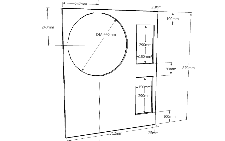

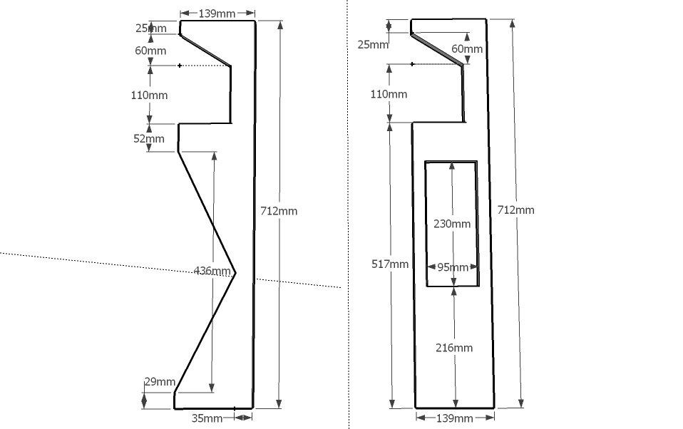

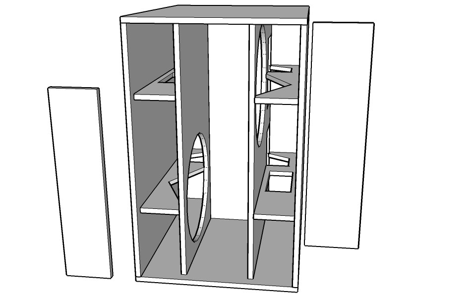

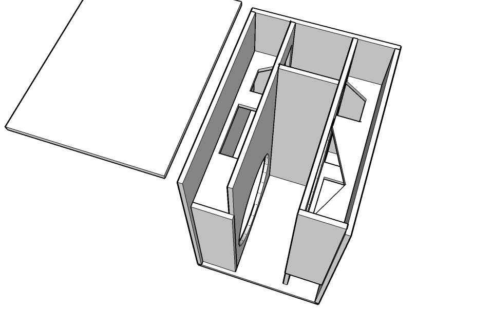

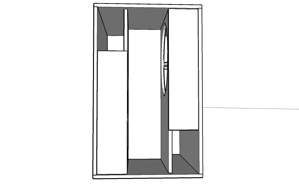

Hey there.
I have some questions.
1. Will af driver like Beyma 18G40 do any good in this cabinet???
2. When I hear that it is a 6th order bandpass cabinet, I picture a driver inside a box with ports in front and rear of the driver.
But here, I can't see the port at the rear cabinet(at the magnets of the driver.
Can anyone help me???

Ive built 4 of these already
the are no vents on the magnets side
I have tried the 18g40 and paudio 18g
and i am more than satisfied with the results
hope that helps i have the plans and mesurements if u need
i built mine out of 18mm ply wood
