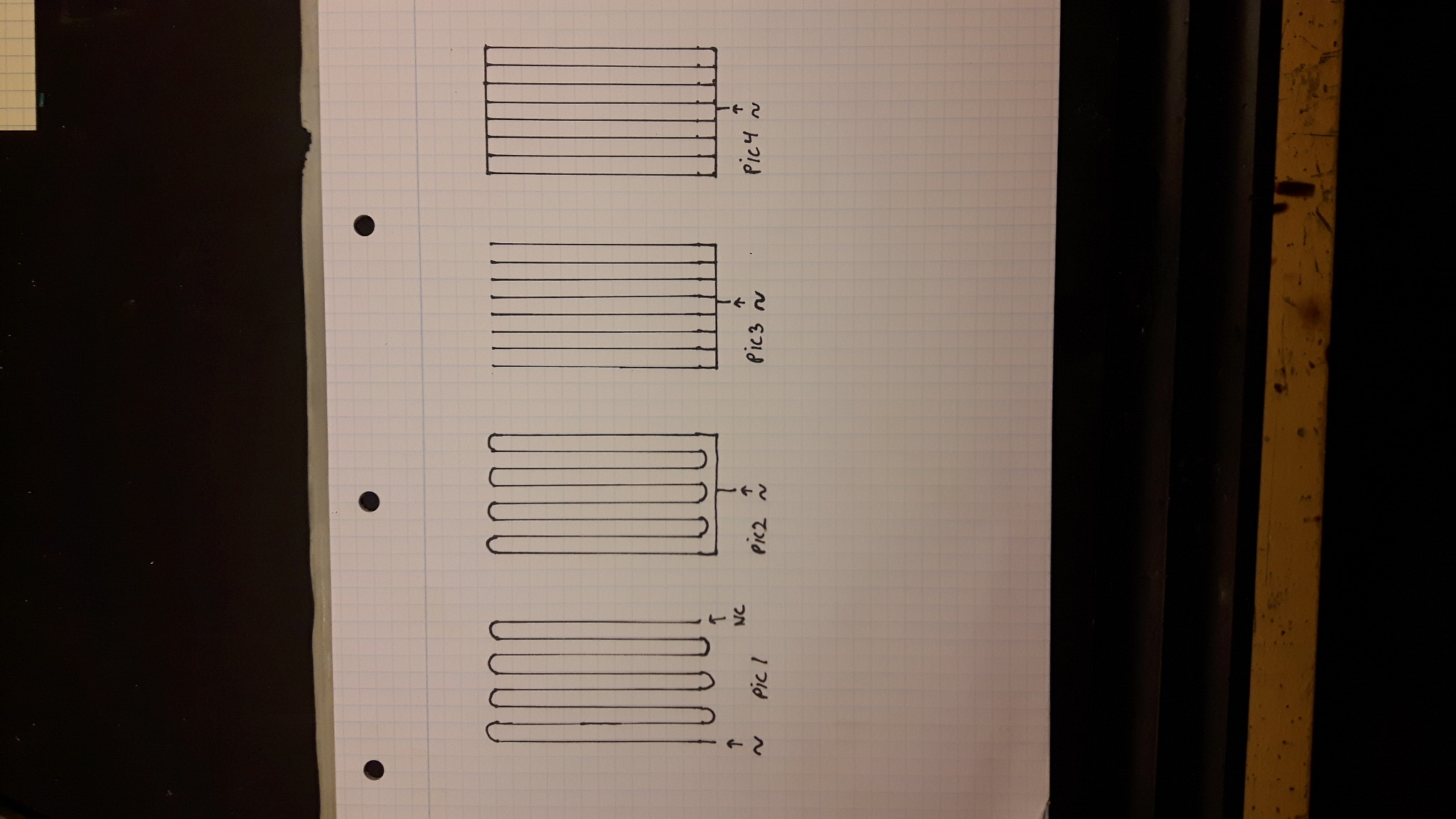

first what is the best way to connect the wires? i have take a picture of differents connections methods of the wire but what is the best way?

From a theoretical standpoint, the connection methods you show are equivalent. Having more connection points helps if you have a break in your wire though. Also, if you are going to segment your panel through resistors to adjust polar and frequency response, having more points to tap in is useful in case you want to try different designs.

Pic 1 would be the easiest, which is the way that I've done it on all my wire panels.

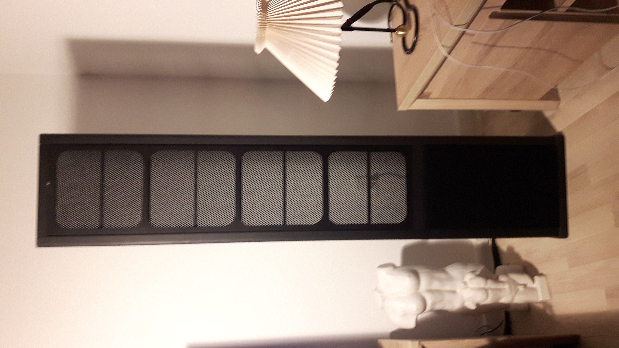

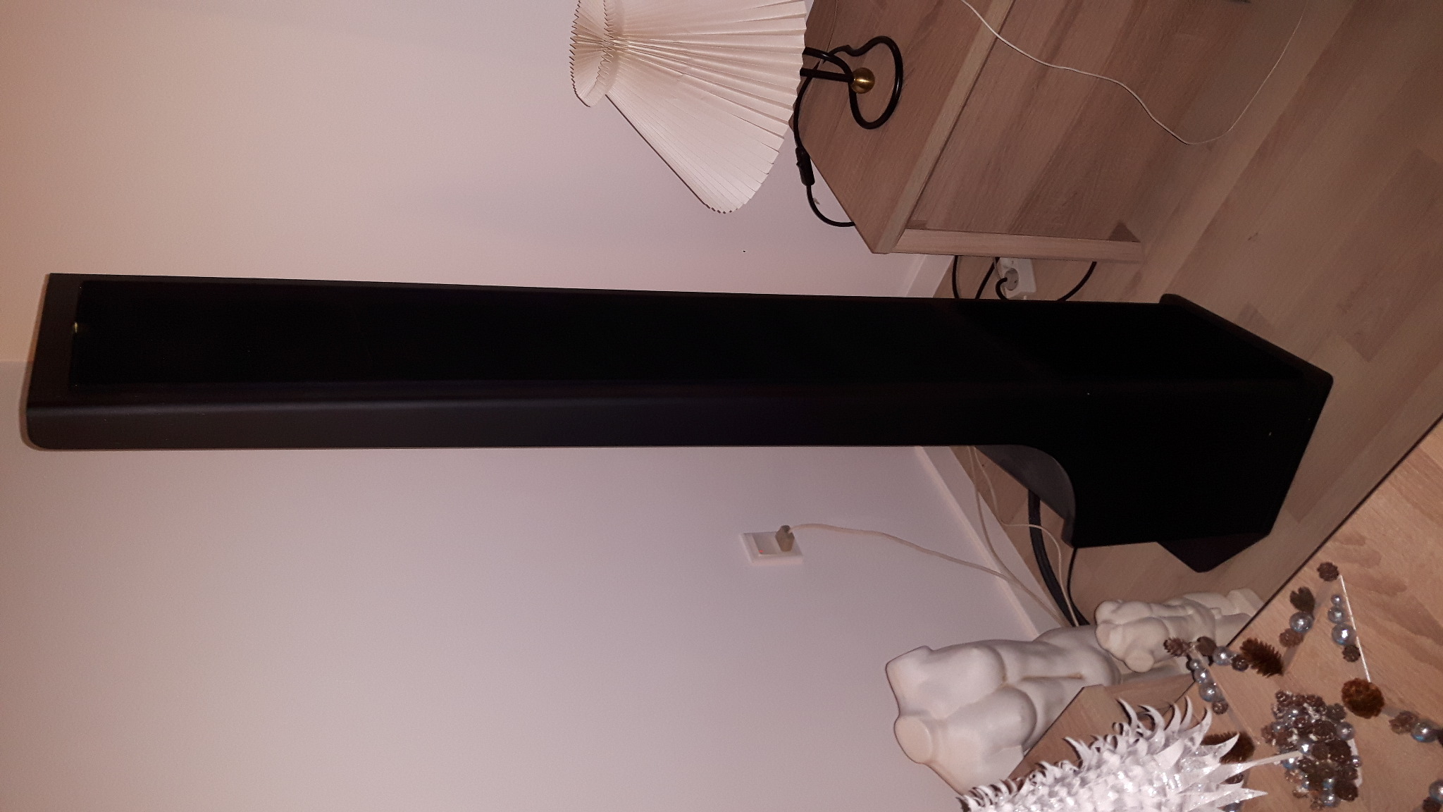

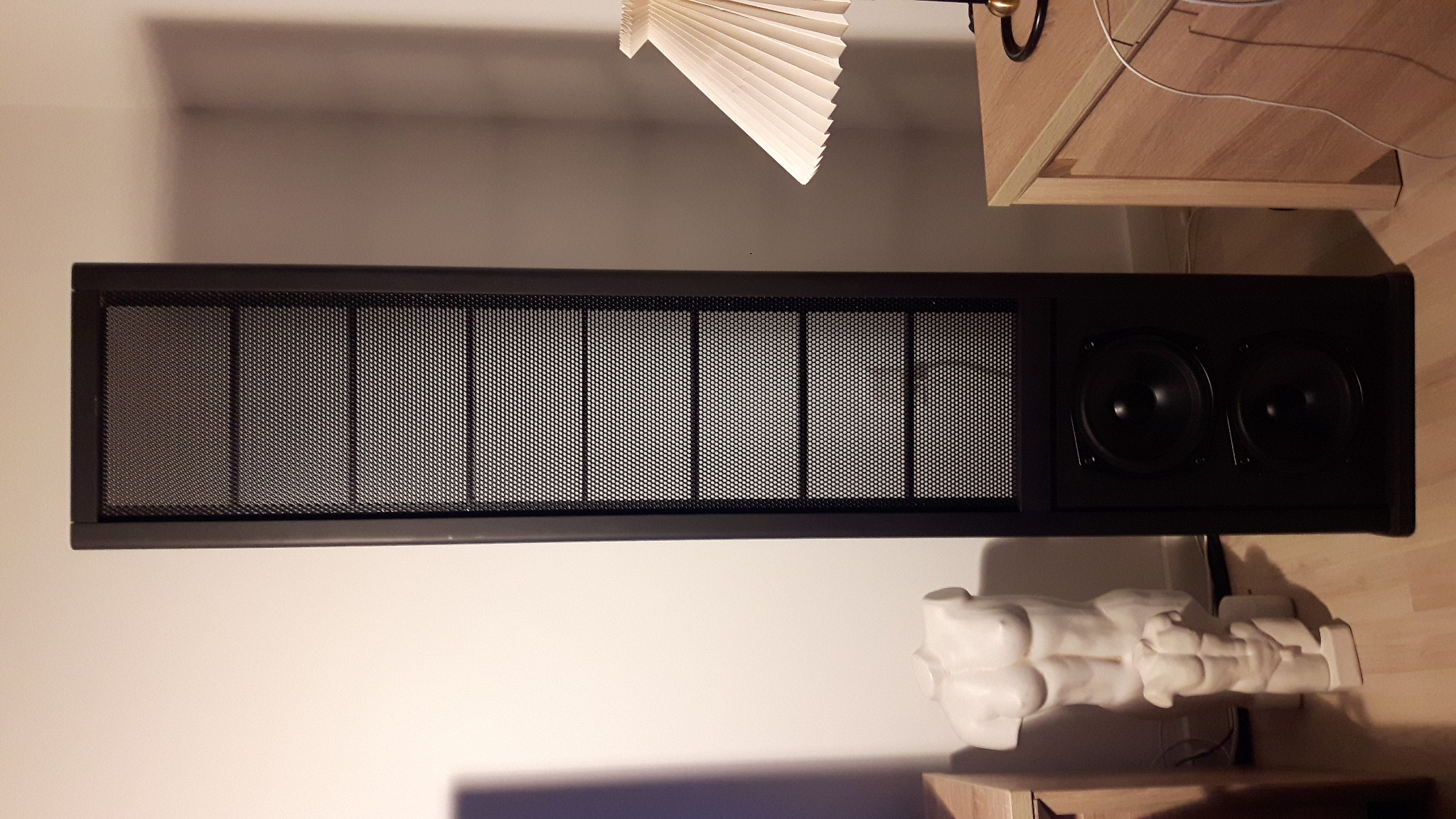

7 years ago i promise to upload some pictures of my speakers that i build with help from all your guys, sorry i never do that but here there are (better late than never🙂) the 2 woofers in the botton are some old 6 inch mission speakers mounted in a closed box of around 15 litres and they go surprising low and i will use them again, the stators are powder coated.
