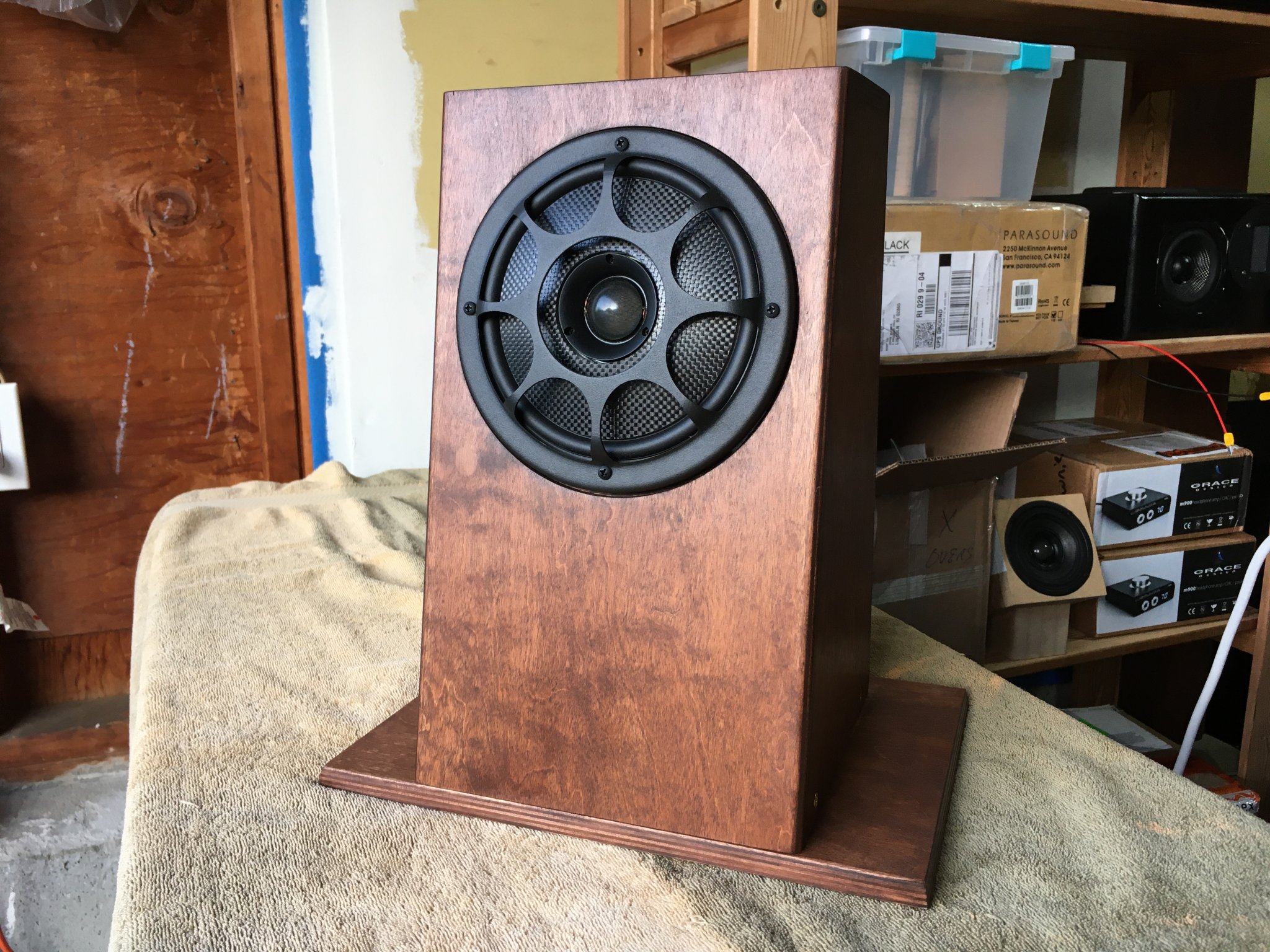

Morel makes a coaxial driver designed for the (I am not making this up) luxury yacht and private jet aftermarket sound markets. Its "Unique Selling Propositions" start with, because its cone (not the tweeter dome, the woofer cone) is inverted, the mounting depth is less than an inch. And when you visualize the task of upgrading the sound in a private jet, that makes sense. Also, the woofer is designed to operate semi-open baffle--again, mounting in yachts, jets, or cars.
(BTW, a little birdie told me that Morel is the OEM supplier for the drivers in the 9-channel autosound system in the Italian supercar by Pagani that costs $3.4 million.)
https://www.parts-express.com/Morel-PowerSlim-6-Integra-Slim-6-Coaxial-Driver-4-Ohm-287-042
The "real estate" dedicated to the tweeter takes away from the pushing area of the woofer, so for a 6-inch nominal woofer, the FS is a rather high 75Hz. I built a design with a .25 cuft sealed box with a 6-inch rear-mounted passive radiator. The design aesthetic is something like, an “Ethan Allen” Colonial- or Federal-era Mantel Clock. However, a Mantel Clock updated to Scandinavian or US Mid-Century-Modern style (as exemplified by Charles and Alexandra Eames). The cabinet was my design, executed by Corwin Butterworth.
Here's a YouTube of it playing:
One nice thing is that you can buy a car kit of two drivers plus two assembled crossovers with adjustable tweeter level from Crutchfield. Perhaps not what you want, but others might be interested.
https://www.crutchfield.com/S-9AKKekuF4yh/p_210VNCIN62/Morel-Virtus-Nano-Carbon-Integra-62.html?
My crossover was LP: 2nd order Linkwitz-Riley crossing over at 2500Hz to HP: 3rd order Butterworth.
Best of luck
john

If I felt the the need to add wings to my listening room I would
certainly consider this direction.
I assure you that it is a wonderful-sounding coaxial driver!
I have experience with Morel's 424 and 524, and I think there is just something so musical about the carbon-fiber cone.

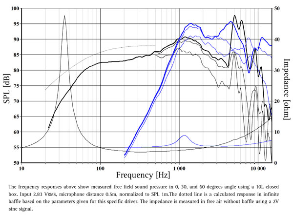

Seriously--what are your other options? Danny @ GR Research told me that the famous SEAS transparent-cone coaxial (H1353) measured terribly.
Morel's 624 gives you more oomph, but it's a trade-off.
SB's coaxial drivers are "affordable,"...
The SEAS Graphene coax is nearly $600 each (for a 5-inch driver!)... and look at its graph!!!
