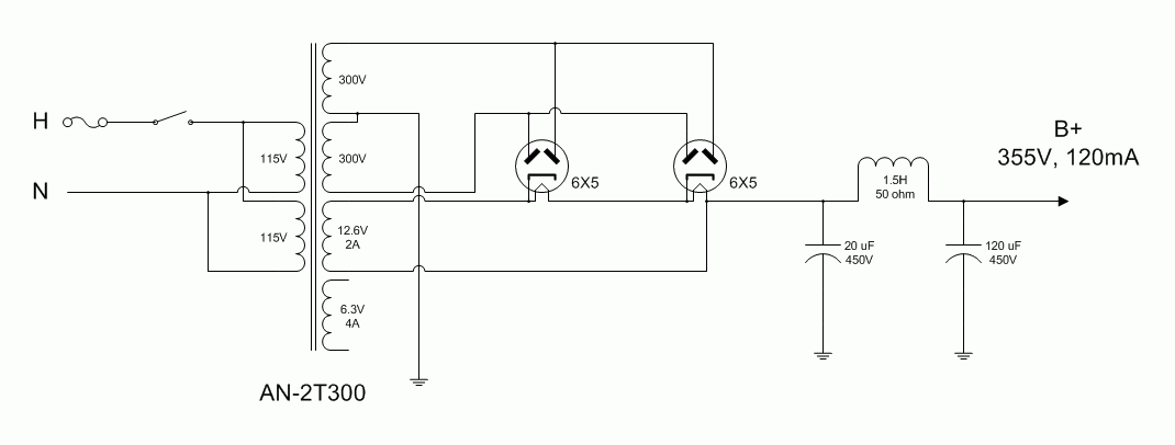

Need ideas - 6L6GA & 6X5GT
Like this?
The topology looks correct, but the 1st filter cap. is too big. Use a 4.7 μF. part. An even smaller value initially may be a good idea. If the rail is too "short" under load, add a little capacitance to the 1st position.
Do you think the 600VCT transformer is the right size to get about 350 VDC, 55 mA per tube (110 mA total)?
By starting with a smallish 1st filter cap., you should be able to tweak the rail voltage exactly.

I guess a lot depends on the power transformer's own source resistance. I don't really know what it is for the Antek toroids, but I've got to expect it's pretty low.
I wonder about the heater cathode limit in the circuit above... if the voltage divides equally (not a given...), there will be 300V AC from each 6X56 cathode to heater. Connecting the cathodes together in the "conventional" connection (plates to ends of HV, CT as negative) will put both cathodes at the same voltage, and there won't be any voltage to the floating heater winding. Would probably be OK with damper diodes, but the insulation in 6X5s is not that good.
A quick sim in PSUD says that the 300V transformer will give about 330VDC - close enough, I think. But 325V might be closer to what you wnat...

...in the circuit above... there will be 300V AC from each 6X56 cathode to heater. Connecting the cathodes together in the "conventional" connection (plates to ends of HV, CT as negative) will put both cathodes at the same voltage, and there won't be any voltage to the floating heater winding.
In the suggested circuit, you'll have 300 VAC H-K, because you're applying 300 VAC to the cathode? And with the "normal" method the H-K eventually ends up at zero volts because the cathodes are at DC and the heater winding floats up to meet it?

They will fit the board, but the 6X5 doesn't like much over 5 uF for the input cap. I have experimented with the 6X5 since I have a few hundred of them. A 47uF input cap, and a transformer with a low winding resistance (like the Antek) WILL lead to a fireworks display inside the tube. The 6X5 has a higher voltage drop than the typical 5AR4. If you want to use the circuit that you show use a small (4.7 uF 450 volt) leaded capacitor, for C1 and a big (150 uF 450 volt) cap for C2.

...but the 6X5 doesn't like much over 5 uF for the input cap. I have experimented with the 6X5 since I have a few hundred of them. A 47uF input cap, and a transformer with a low winding resistance (like the Antek) WILL lead to a fireworks display inside the tube.
Thanks for the informative and helpful reply. It's got me wondering if I'd be happier in the long run if I just give up on the 6X5 idea and go with the 5AR4. I've already got the 6X5 for "free", but I'm sure I've got an extra 5AR4 laying around somewhere too.

I don't think there will be a problem with 6X5 heater to cathode insulation breakdown. Look at the data sheet. The design center limit is 450 VDC. 🙂
Agreed... it's rated +/-450V ... but which is better... 300 or more VAC heater - to - cathode... or essentially zero? LOTS of '30s-'40s Zenith power transformers died from H-K shorted 6X5s - ask any old-time radio repairman!
I just simulated it with 55 mA - half the load. Transformer drop will be double with 110 mA, but it will be small in any case. Make sure your input cap is good for 150 mA or so ripple current - not all small caps will be. You can get the ripple current from PSUD, but a first approximation is same as DC load current.
That would be my choice since I have toasted a few 6X5's and I am still using the same 5AR4 that I started with about 6 years ago. I decided that the 6X5 just isn't really suited for power amp use except for maybe a 6V6 amp. It does impart a unique sound to a 6V6 guitar amp.
