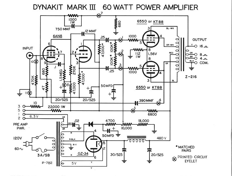

I have just entered the testing phase for a stereo version of the dynaco MK III that I have made.
OK, heres the thing. Connected the first channel up using EL34 (as I have a couple of old ones hanging around and didn't want to smoke my new KT88's). Cautious power up measuring the bias voltage across a 10 R resistor (adjusting for 0.7v = 70 ma). All the tubes light up, no smoke, no funny smells etc, all looks good. Put in an input signal from CD player through a 100 K pot and fantastic clear sound - a great victory!! All looks good, listing to the music and very pleased with myself. I decide to crank up the volume, goes OK but as I am cranking up the volume, the bias voltage shoot up to about 3v and at 'midrange' volume, I get a sudden abrupt, loud and disturbing buzzing through the speaker and about 2 seconds later, bang, the 3A fuse blows.
Hmm, so I let everything cool down, replace the fuse and give it another quick go. Hey presto, all seems well at low volume - amp working fine. I then shut it down, not game to crank it up for fear of damaging something!
I have attached a circuit diagram. All is the same except I was using EL34's instead of the KT88's. Should also mention I was using a 6R test speaker on 8R tap.
Any ideas?? Maybe just too much current for the EL34's? As I mentioned, sounds great at lower (not quiet but not loud) volumes but the response to cranking the volume was quite spectacular.
Rob

Some further info - I did try the KT88's. They worked OK and did tolerate the higher volume but as I turned up the volume the bias voltage jumped from 1v resting to over 3v. This was a dramatic jump not a slow climb and represents 300mA cathode current - too much for these tubes and that was just at medium volume. I did not push it any further but have shut the whole thing down.

A bit more info
A little bit more info -
Tested the other channel using the same tubes, and the same power and output transformer - no problems at all. Works fine with acceptable cathode current (as determined by bias voltage) at all volumes.
I guess this eliminates the tubes, transformers and my basic interpretation of the circuit (ie my wiring in one channel is fine). So this leaves -
1. Faulty components - but all brand new (including caps) and tested during construction
2. Incorrect resistor value somewhere - but unlikely as all were double checked and were matched with the other channel
3. A wiring error - most likely but it must be a small problem as the channels were made concurrently (and very carefully) and they are a mirror image of each other.
Now, I need is some advice as to where I should begin looking apart from the obvious (double check everything) which I will begin to do this evening when I get a chance to sit down and look at it properly again.

Try swapping around the anode leads to the output tubes, you might be getting positive feedback.
Also you could try disconnecting the negative feedback resistor from the output transformer secondary and see if the problem is related to that or not- also check your feedback cap is 750pF (MMF = 1x10-12 or picofarads)
Also double and triple check all your component values and solder joints.

Problem solved
Thanks Shifty,
Great advice, Problem solved - In my original test configuration, I had the anode leaps connected the wrong way. Works perfectly well now - both channels up and running. Shifty, I would love a brief explanation of the positive feedback issue if you have time but will be satisfied with having just solved the problem.
I'm not Shifty (at least, I try not to be😀 ) but I can explain the problem. Put simply, global negative FB is used on your amp to lower output impedance, reduce distortion, reduce hum and noise, stabilize the gain and broaden the audio frequency response. Another result of NFB is reduction in gain.
A fraction of the signal from the secondary of the output transformer is fed back into the input at the cathode of the first stage. This fed back signal must be out of phase with the input signal for the feedback to be negative.
If you have the connections to the primary (or secondary) of the OPT reversed, the feedback will be positive, with exactly the opposite effects listed above for negative FB. If the amount of positive FB is sufficiently high, the amp will oscillate as soon as it warms up. In your case, the fraction of signal fed back was evidently too low to cause that, but the amp was on the verge of instability and it only took a large enough signal (when you turned up the volume) to send it over the edge into oscillation.
