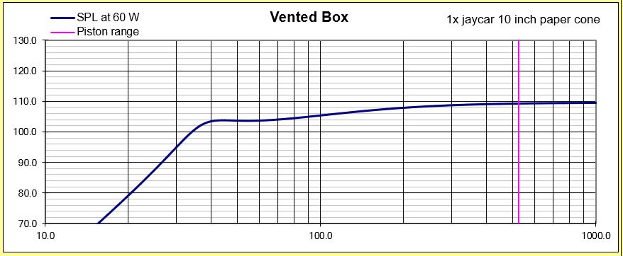

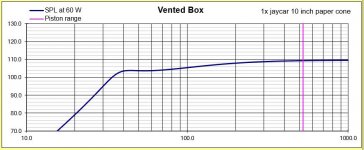

I have these in ported enclosures ~32 litres tuned to about 40 Hz if I recall correctly. The bass is surprisingly good. The response forms a sort of shelf, so you can't just look at the -3 dB point from the midband. They are running in an active speaker crossed at 150 Hz so I have some leeway in setting the levels correctly. I know they look pretty bad on paper but I've had them since 2010 and haven't felt the need to change them out yet.
The actual measurements were a fair bit different to the specs, but didn't change the overall response much when entered into the calculator. Usable output down to 30-35 Hz.
