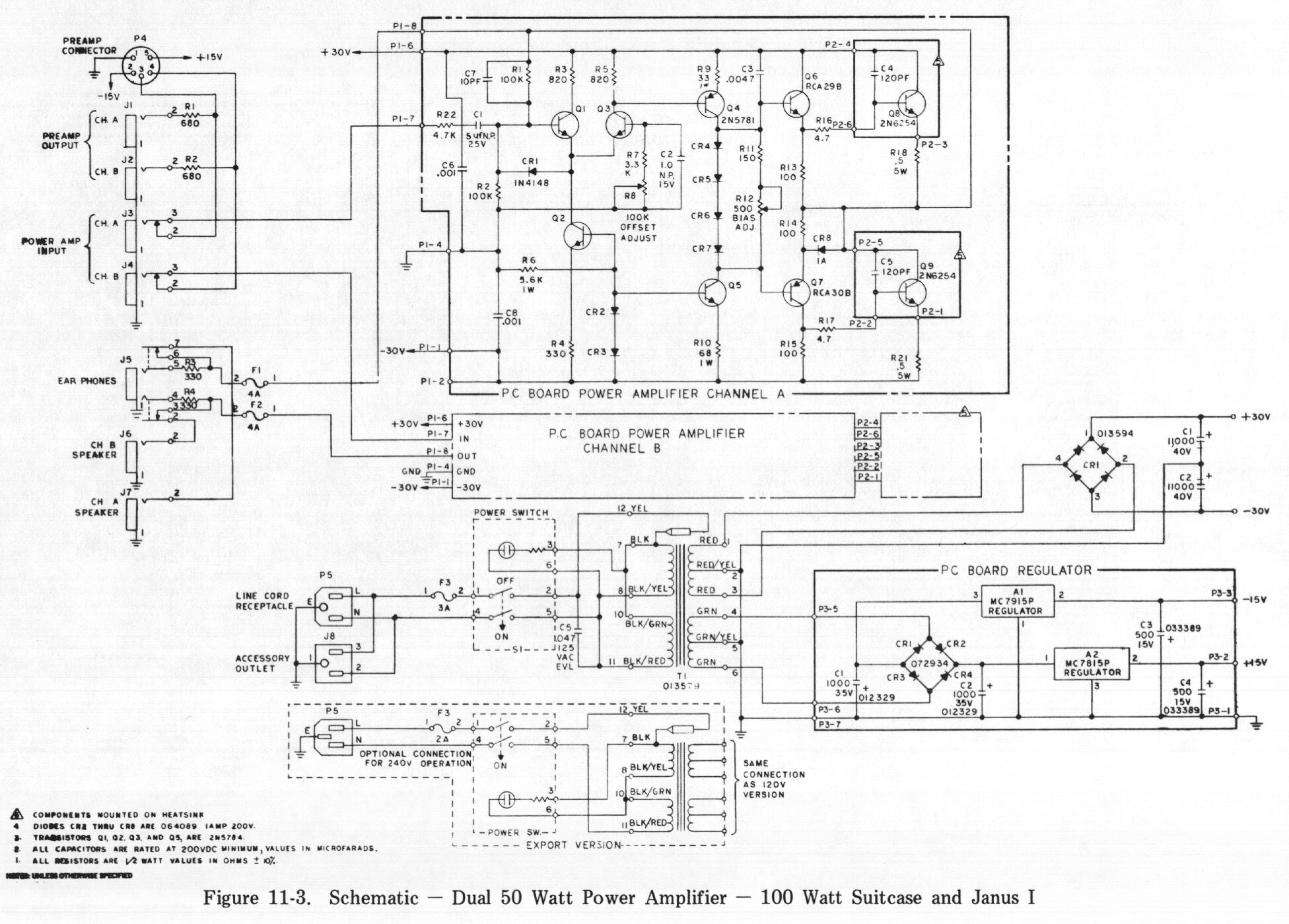

Hey all. I'm back on a project I had to put on hold for the past year and a half. I have a Fender Rhodes keyboard amplifier model FR7710.
I need some help selecting a substitute power transistor(s) for a RCA 2N6254 Si, NPN. I would rather not use NTE if at all possible. On Semi would be nice. I am attaching the datasheet that I have for the 2N6254. Any other info needed, please just ask. Also, if this post is in the wrong place, I apologize and please move accordingly. Thanks.

Thanks for all the input. I went to OnSemi and I wrote them asking if they had a substitute/equivalent/replacement for the 2N6254. They guy who wrote me back sent a couple datasheets of possibilities. If you would, take a look at the one I'm attaching and tell me what you think. Personally, I don't think it looks bad compared to the 2N6254. Thanks.
Here's a diagram of the circuit I forgot to included in my Op if it helps or matters. That 2N3773 looks good, too.
