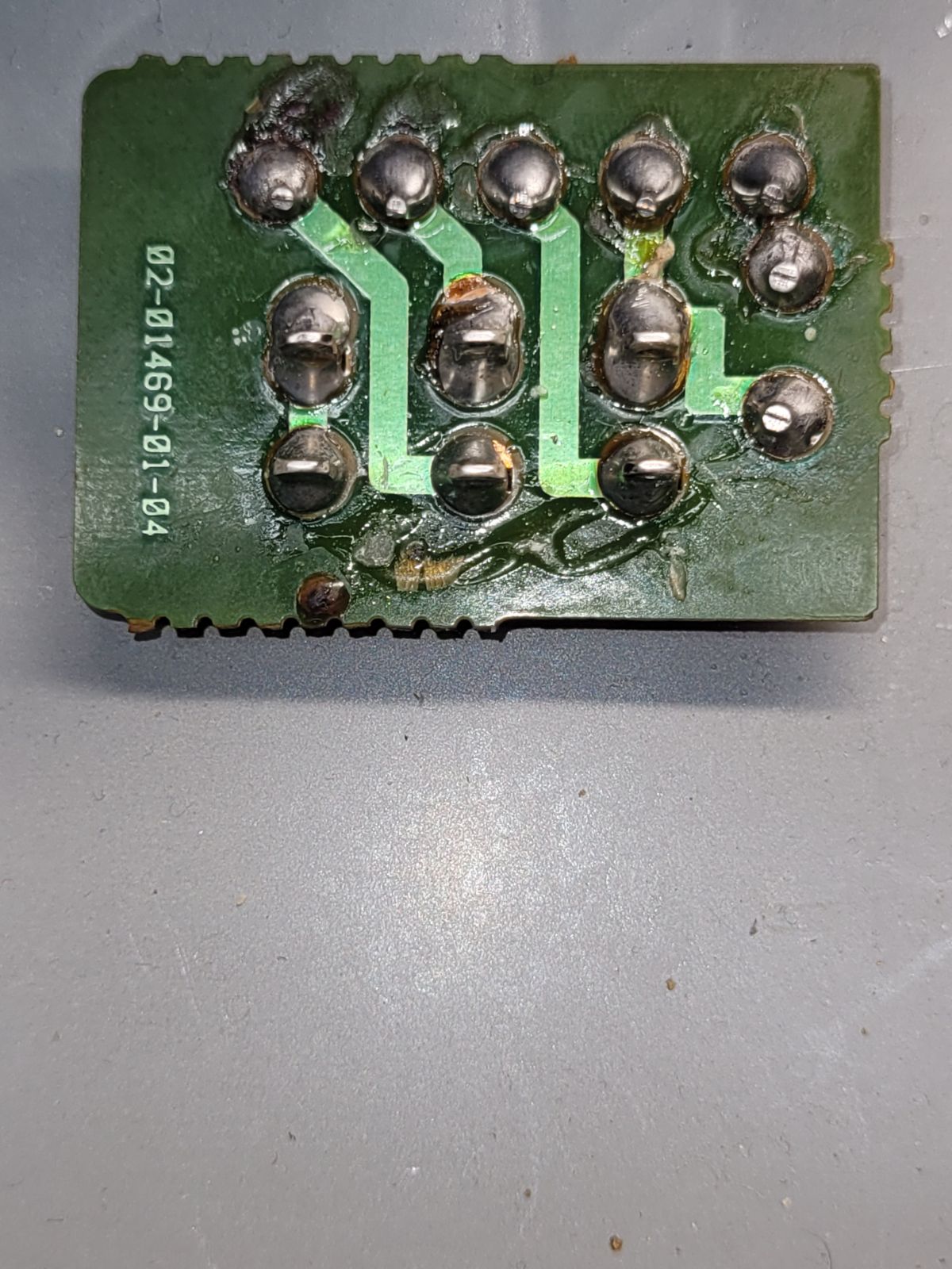

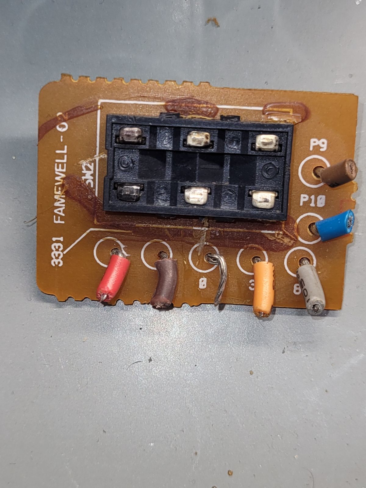

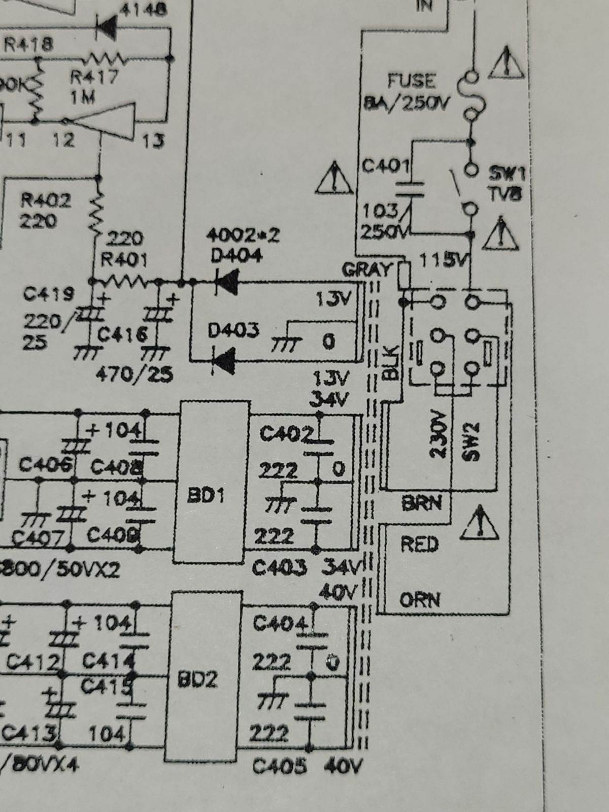

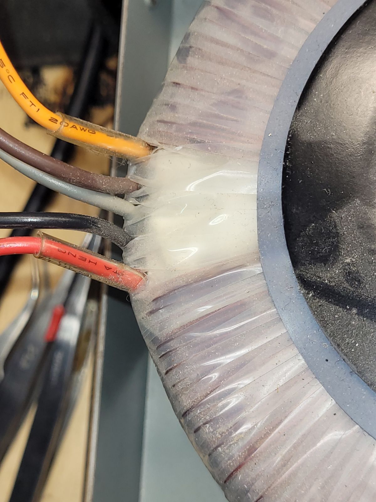

I need help to wire a repurposed transformer from a carver av-405.
Would orange brown be in, while grey ties to neutral.
Red and black tied together.
This was a dual primary transformer, 115v and 230v.

The gray wire is probably a thermal fuse connected internally to the black wire.
To wiring it for 115VAC mains:
Ties red and black wires together,
Gray wire go to Neutral.
Orange and brown tied together go to Live.
