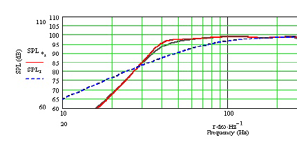

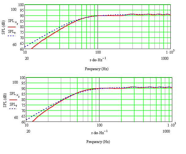

on the "flat to 40" point, and tuning to taste, in the same FR125 design, I have adjusted the low end output by adding stuffing in the last part of the line, see the attached graph (red line is base design, black with additional stuffing)

check, for example the CSS FR125 I have used in a TL tuned below 50Hz (fs=70Hz).
That's nice. Out of interest, do you mind if I ask what driver specs & power input you used? I assume, looking at the IB curve on your graph, & the factory specs for the current FR125SR, that it's for two drivers, paralleled, with about 3w input, as the IB response is far above the 85.5db 1m/1w sensitivity of a single unit, and the basic response curve is somewhat different as well. Or was it using the older FR125S model with a different power-input?
Best
Scott
I used the factory specs for the FR125SR, and had the power so far up that the cone excursion would hit Xmax at 40HzScottmoose said:.....what driver specs & power input you used?
Scottmoose said:b/ the 125 doesn't have progressive rate suspension AFAIK, so you're going to be bouncing the VC off the back-plate if you go much further

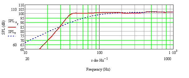

Blast. What happened to the 2nd paragraph of my last post? The graph's still there. Ghost in the machine, that's what it is. Anyway, near as I can remember, the gist of it went something like this:
'I got similar results from a cab. design I did shortly after the FR125S was upgraded to SR standard; the response plot attached (now attached above ) is from that box, with the wick turned up so it's hitting Xmax at Fb. That's not to say I'd recommend this alignment per se. a/ as we're at Xmax at these SPLs, there's no dynamic headroom left (although at more modest levels, in a small room, it should be pretty decent for an FR driver based system), b/ the 125 doesn't have progressive rate suspension AFAIK, so you're going to be bouncing the VC off the back-plate if you go much further, and c/ a max-flat alignment is not in itself usually a good idea in-room; I use it for DIY boxes on the understanding that the end user will tweak things to suit their own system / room / preferences.'
