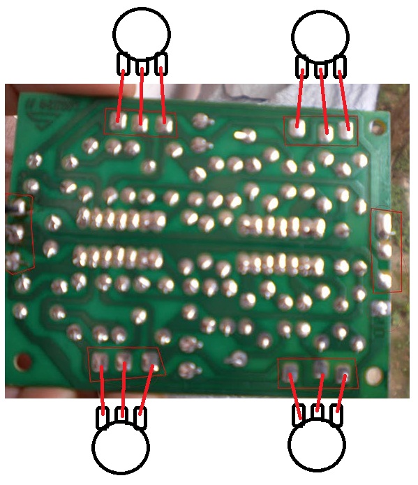

'Need help with STK4142 amp circuit"
you can user dual volume and connect then to the back side of BT pcb where it's marked BASS and TRE..
