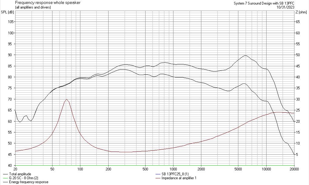

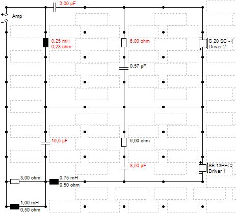

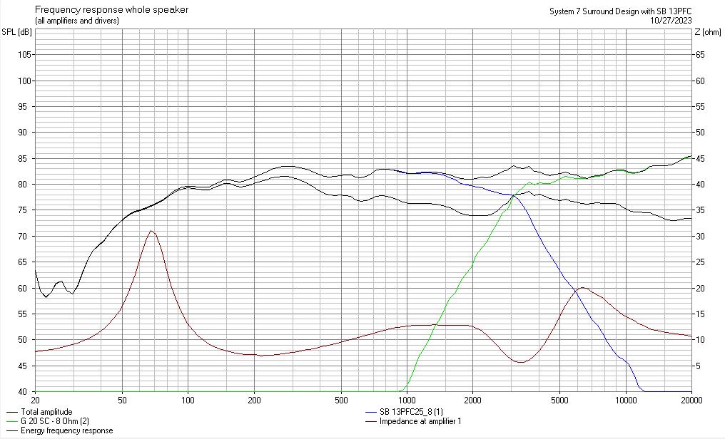

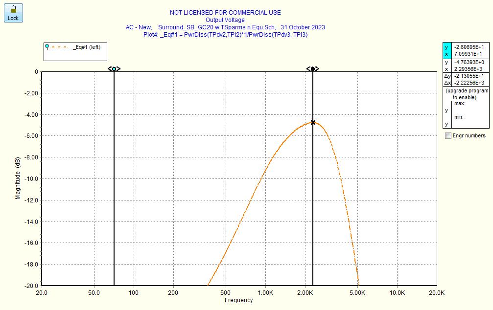

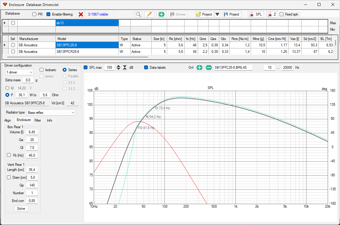

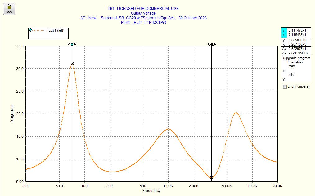

Hi, I designed a 2 way series crossover speaker system a while back (Fig 1 based on System 7's concept giving very good phase alignment) and was just going back over the design trying to determine the power that the drivers and resistors will see. Original design was with Vision's BOXSIM program. I replicated the crossover in 5SPICE (Fig 2) and took in the BOXSIM equivalent circuit for the drivers. Using that equivalent circuit gave a pretty good match of the calculated impedance curves between BOXSIM and 5SPICE (Figs 3 and 4). Based on BOXSIM the woofer SPL looks to be more than 4dB attenuated in crossover/box (Fig3) based on raw output of driver being 87db but seeing ~83dB or less in the box. Using 5 spice I calculated PwrDiss (Speaker Driver V, Driver Current) divided by PwrDiss(System Input V, Input Current)(Fig 5). This shows much less attenuation - more like 1.5 to 2 dB for a good part of the range. (I also ran the calculation just multiplying V and Current rather than using the PwrDiss function in 5SPICE and got similar results)
Why the large discrepancy? For this 40W rated woofer can I put in 100W like BOXSIM implies or only 50W like 5SPICE implies?

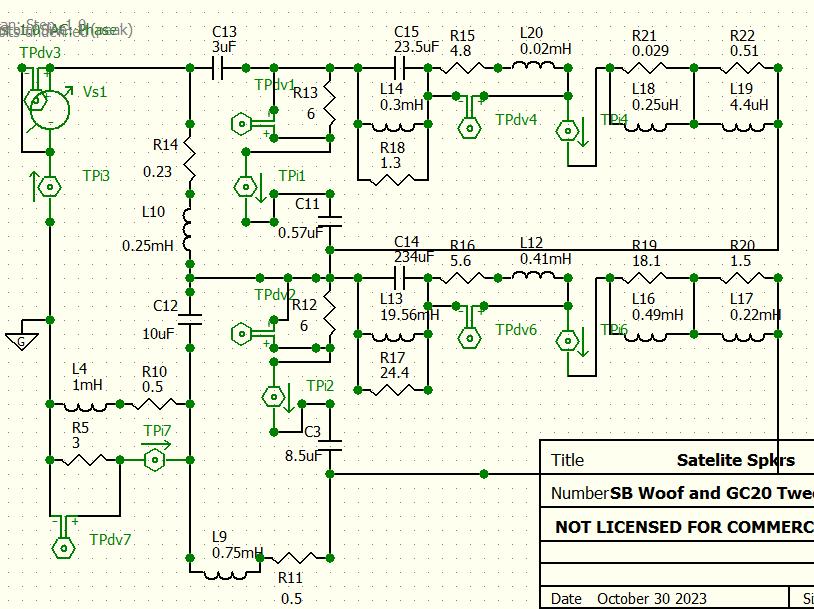

Then for the resistors - I used 5 spice to calculate the power dissipated as for the driver. For the 6 Ohm resistor in the woofer circuit (R12) it sees a peak of -4.7 dB or about one third of the input power at around 2.3kHz (Fig 6). Do I have to size this resistor to handle 1/3rd of the input power even if it is not over a broad frequency range? Should I even believe this calculation based on the discrepancy between BOXSIM and 5SPICE on the Woofer driver above?

wolf_teeth - I just ran BOXSIM with no crossover (amp straight to woofer but woofer still in same enclosure) The result is shown in the plot below.
Relative to the result in Fig 3 above there is still significantly more loss than predicted by the 5spice simulation, and they should both have the same B-S loss right? So I'm still at the same place wondering which is correct and how much power I can apply from the amp. 🙁

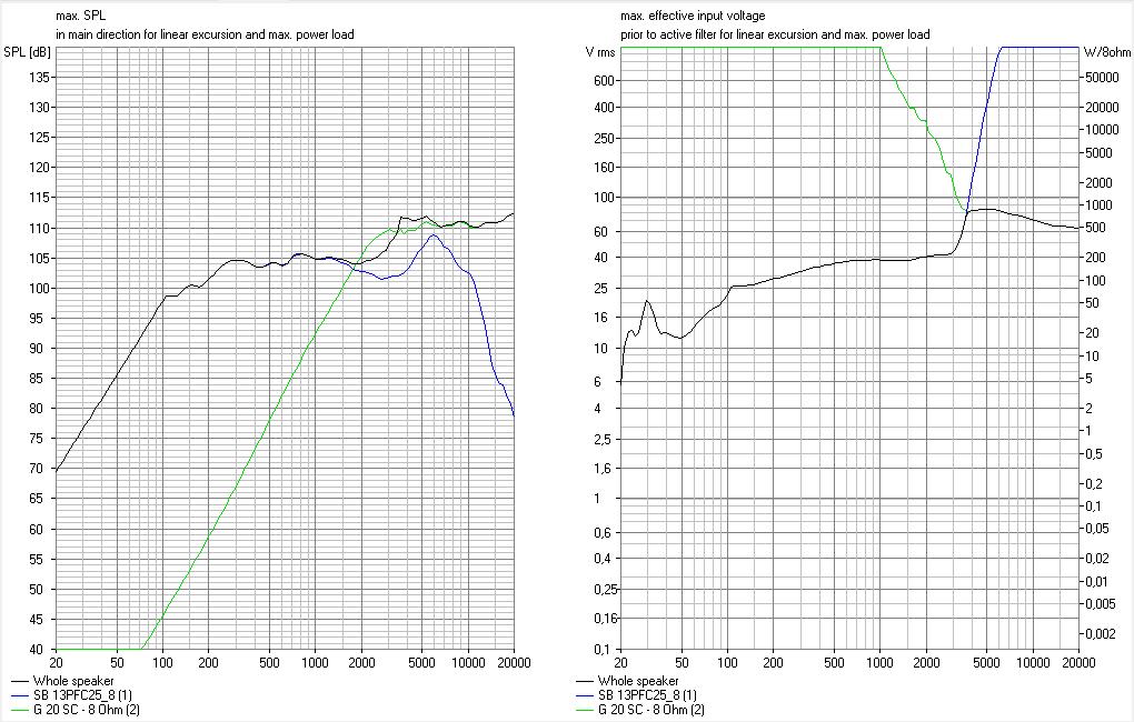

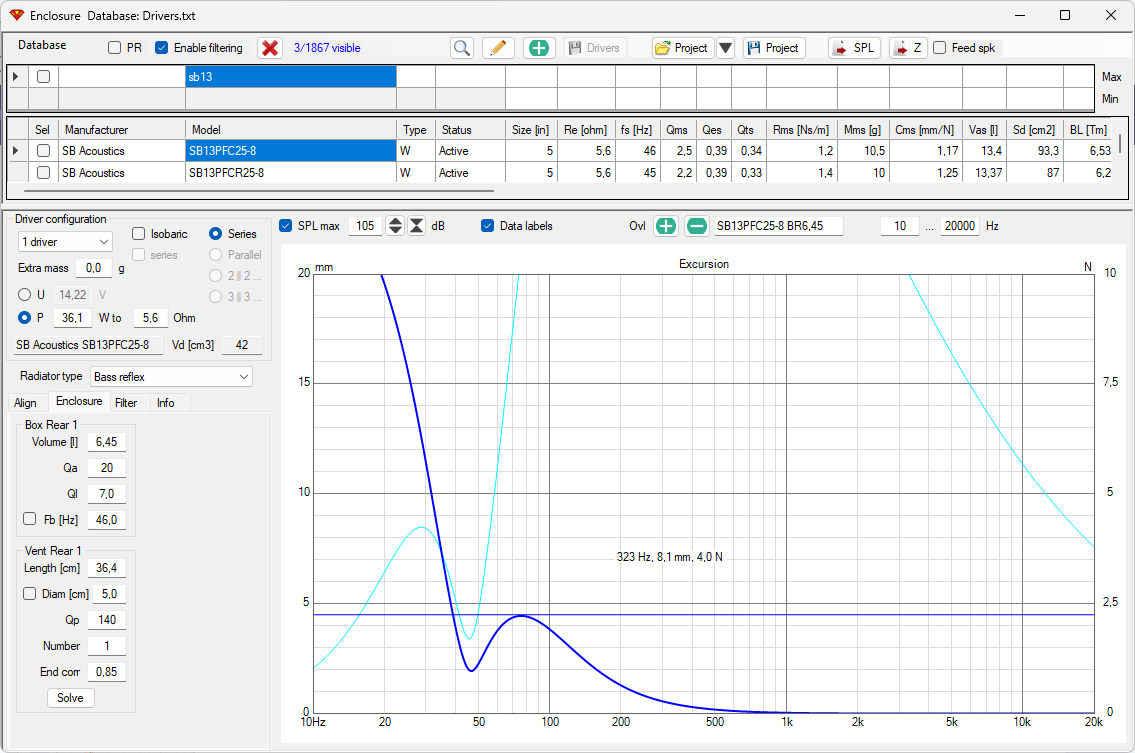

Thanks for the guidance and for pointing me back to BOXSIM for the Xmax, there is actually a max V/Pwr for linear excursion plot I never paid much attention to before. I've included a shot of it for this set up and like you said, the problem is below 100Hz so if this were used as a Midrange it could handle much more without distortion.
As you suggested I can see how that part of the curve is not impacted by the two way crossover design and only by the box.
Exactly how do I interpret this plot though? I presume it applies exactly to the case of a single frequency being sent through the amp and getting the full power of the amp? If you had your amp set at 40 Watts does all the power ever go to a single note instantaneously in practice? (Other than maybe dropping a phono needle for instance)

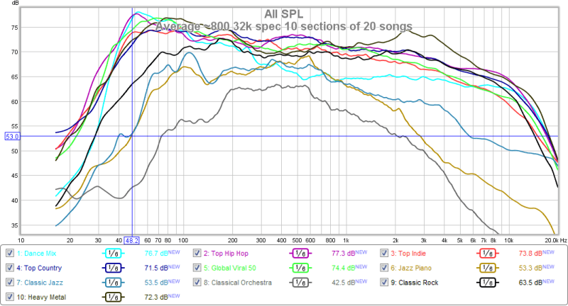

I took the SPL for various music genres from a post by Pano (I actually used the curves by Msibilia pasted below). I broke the spectrums manually into 10 octaves and then determined roughly how much power would be in each octave for 100W total power. I then convolved those numbers across the woofer or each resistor 5 spice curves - posted in original post - of (Pwr dissipated(F)/(Pwr Input(F))
From this approach I could see that the 6ohm resistor (R12) would never see more than about 5 Watts but the 3 ohm resistor (R5) would see as much as 12Watts for some types of music (Classical and Classic Rock) where Hip Hop and EDM had more power in the bass where this resistor was not absorbing much. Based on this approach I also concluded that the driver itself would see anywhere from 36W to 60W RMS for a range of music genres. So based on this an input power of 66W would be at the thermal limit for these drivers and R5 in this ckt, though of course there would be much distortion.

At 36W this driver outputs 100dB SPL over 100Hz but it also reaches the maximum cone excursion limit (thin blue line).
