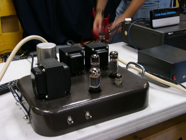

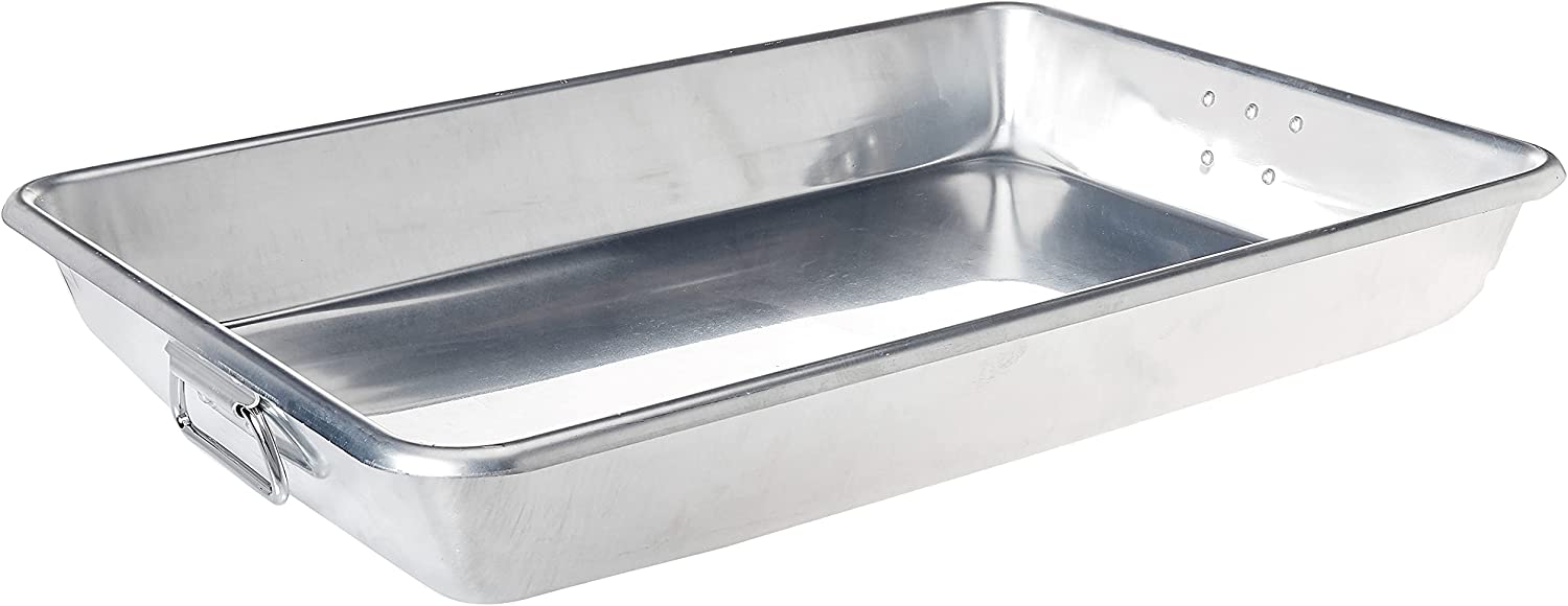

Kinda sounds like you could go with the "frying pan" route for a robust type chassis...
BTW, this thing is huge, twenty six inches long...
---------------------------------------------------------------------------------------------------------------------Rick...

This is an example of a "small" amp built on such a chassis. Peruse a large well stocked "kitchen supply" outlet...
-------------------------------------------------------------------------------------------------------------------------------------Rick...
