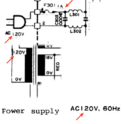

I'll post a schematic of the power board and pic of the transformer arrangement shortly.

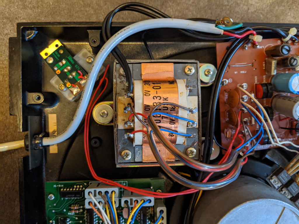

I also promised to post a pic up of the tx. Something that looks odd to me is the 18V brown secondary with the 0V tap on the primary side and the 18V on the secondary. Perhaps this is just an odd winding pattern/configuration but I thought I would just point it out.

> The unit I have is 250V/50Hz according to the label on the TT.
> The schematic shows a 110V/60Hz supply.
All three places the schematic says "120V" have a halo like someone pasted-in a change. Like 240V is the base design, a 120V model was sold in the US, and the scan was taken from a US manual.
Your transformer shows a "240V" winding so you are probably OK.

BTW, the solder joints on the transformer primary look a bit crusty to me, the 0 V in particular. That clearly wouldn't be helping matters. Any change of output voltage if you wiggle the cable? A bit of flux and fresh solder may be appreciated.
Is the power switch delivering a decent enough contact resistance?
A flaky primary connection or power switch are about the only reasons I can think of for why unloaded voltages were higher than loaded. Well, either those or a flaky thermal fuse... At times these have been known to go bad all by themselves, but here the potential short on +12V might just have sort of degraded it. Maybe try getting a resistance reading on the primary and observing whether tapping the xfmr changes anything.
Worst case would be some shorted turns. That would make the transformer get quite warm though.

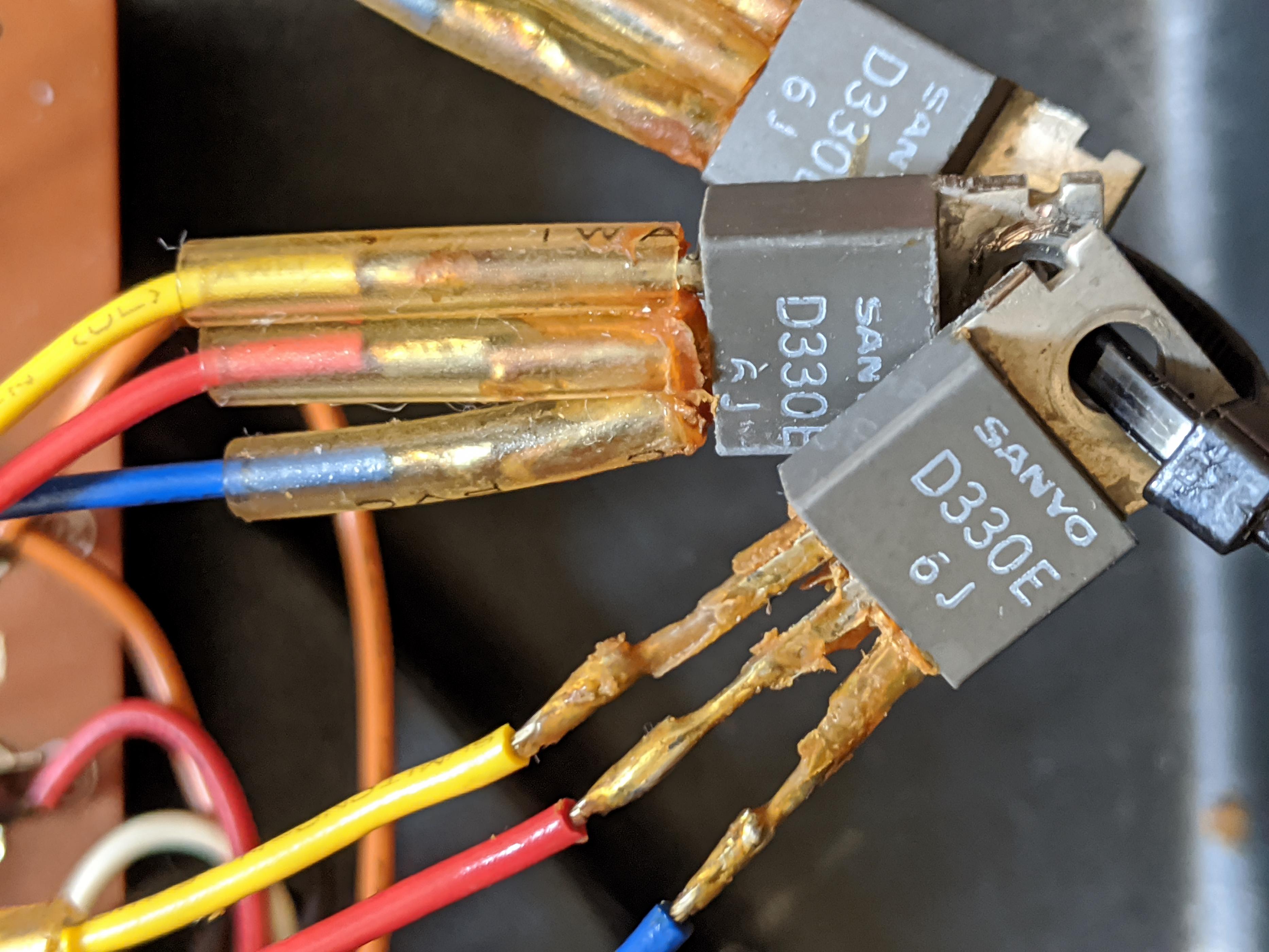

No joke rayma. I just followed the power to these 3 transistores and found what I found.
if it's any consolation they were sheathed in old plastic tubing.
Does that look original, or did someone do that after the fact? Terribly shoddy practice.
Check them unpowered with a dvm on the diode function. At least one is good.
