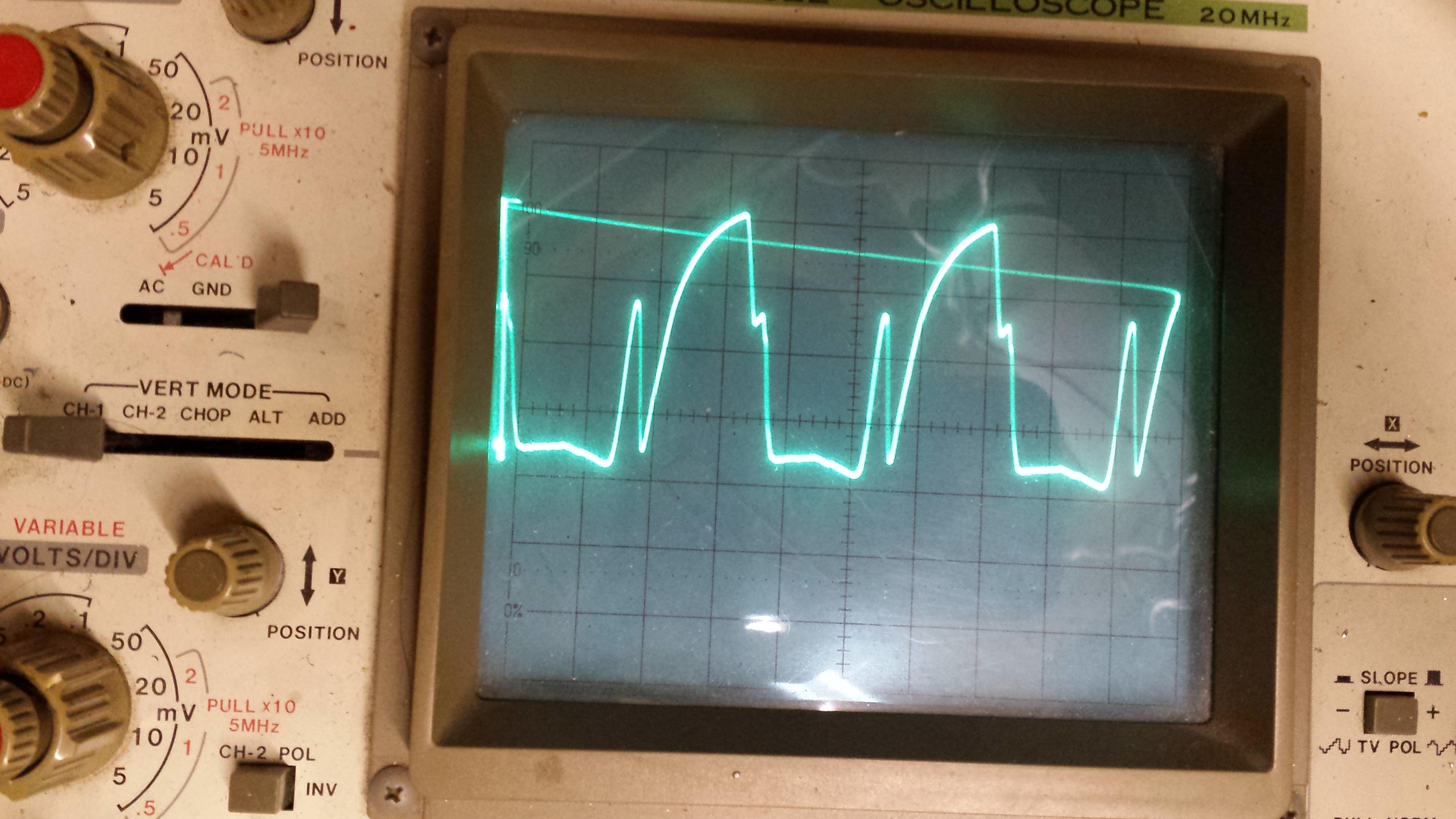

Need help with Planet Audio BB150.4
Bought this broken with blown supply fets and the output RC filter caps and resistors toasted. Got the supply up and running but it's drawing 8A no load when the driver board is installed. Anyone familiar with these? Here's a scope shot of the output gates.
