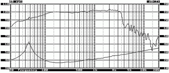

After looking at the freq. graphs, and if it were me with this project, I would set the crossover point between 1,500 HZ and 2,000 HZ. And I would use a 12 db per octave setup. You can risk going with the Yamaha crossover at 1,000 HZ, but I think that it is too close to the free air resonance of the high freq. driver. If you cross it over below 1,200 HZ then I would suggest having 18 db per octave, to protect the high freq. driver.
