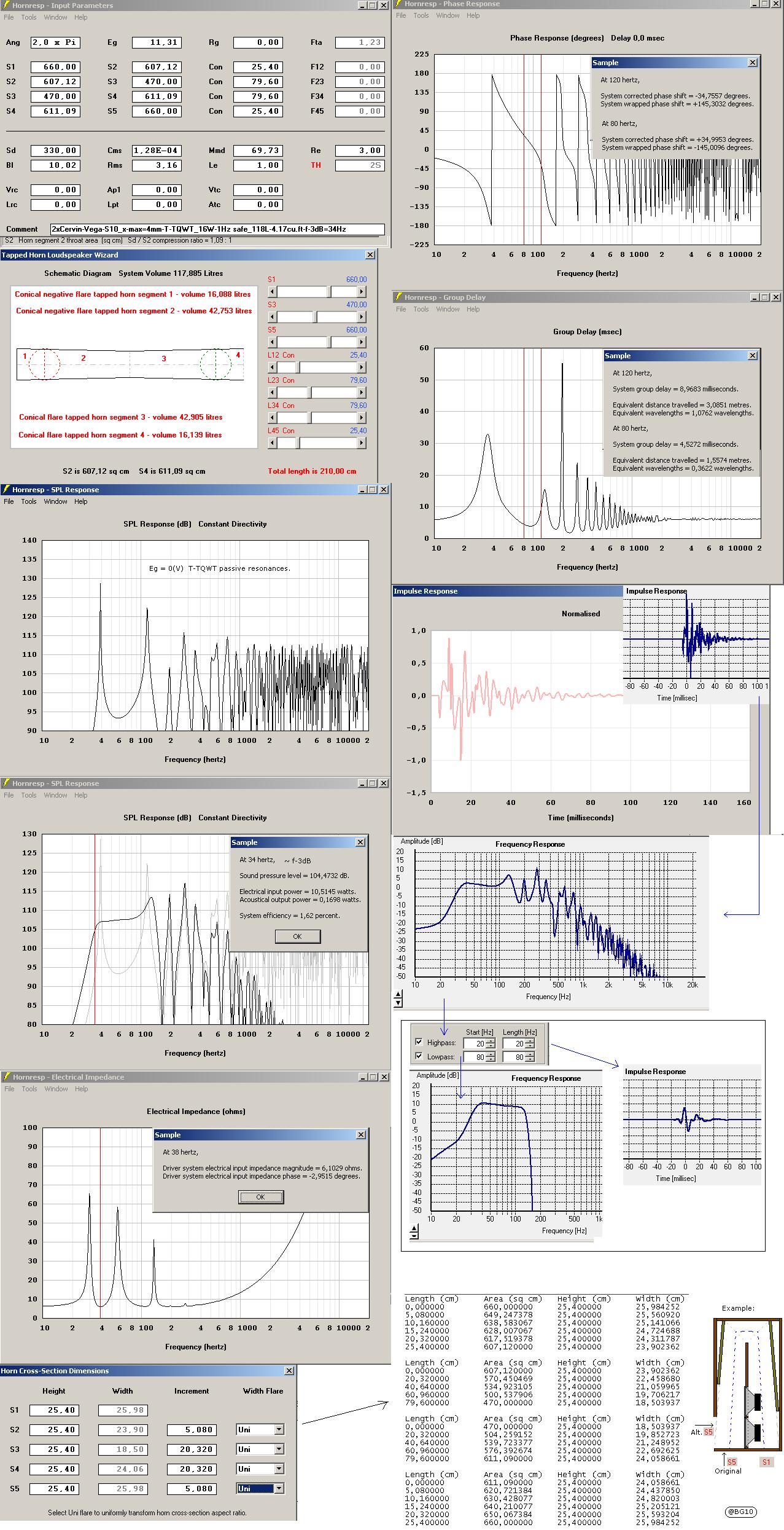

Hi gvimhoof,all
😉If the H-Frames fails performance-wise, after building the proposed quite large sized quarter wave design, there is of course a possibility to revert to other types. See the picture:
This suggestion would really pass the E-string bass without x-max strain while covering the mid-bass and half of the upper-bass to about 120 Hz.🙂
Two CV-S10 in a H-Frame with 10 dB marginal is only reaching 92 dB SPL-max at 42 Hz, corresponding to a low 60 dB phone loudness level (bedroom level?😱).

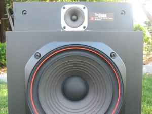

OK, well. A friend of mine acctually has the CV 10.8 woofers at his house and I just found out that he is in Europe for a week. So, I am still moving forward with this cheap OB project but using a pair of Technics 4500a cabs with the woofer that came with them. I've was going to use the 4500a in my garage but it can wait until Joe gets back. Should be interesting. Here are pix of the 4500. The no longer have the tweeters so that is not an issue. I will just make a small baffle board for the mids and tweets I am planning on using. Cheers.
.. So, I am still moving forward with this cheap OB project but using a pair of Technics 4500a cabs with the woofer that came with them.Hi djn,
Here is a quick H-Frame simulation to be considered in case..:

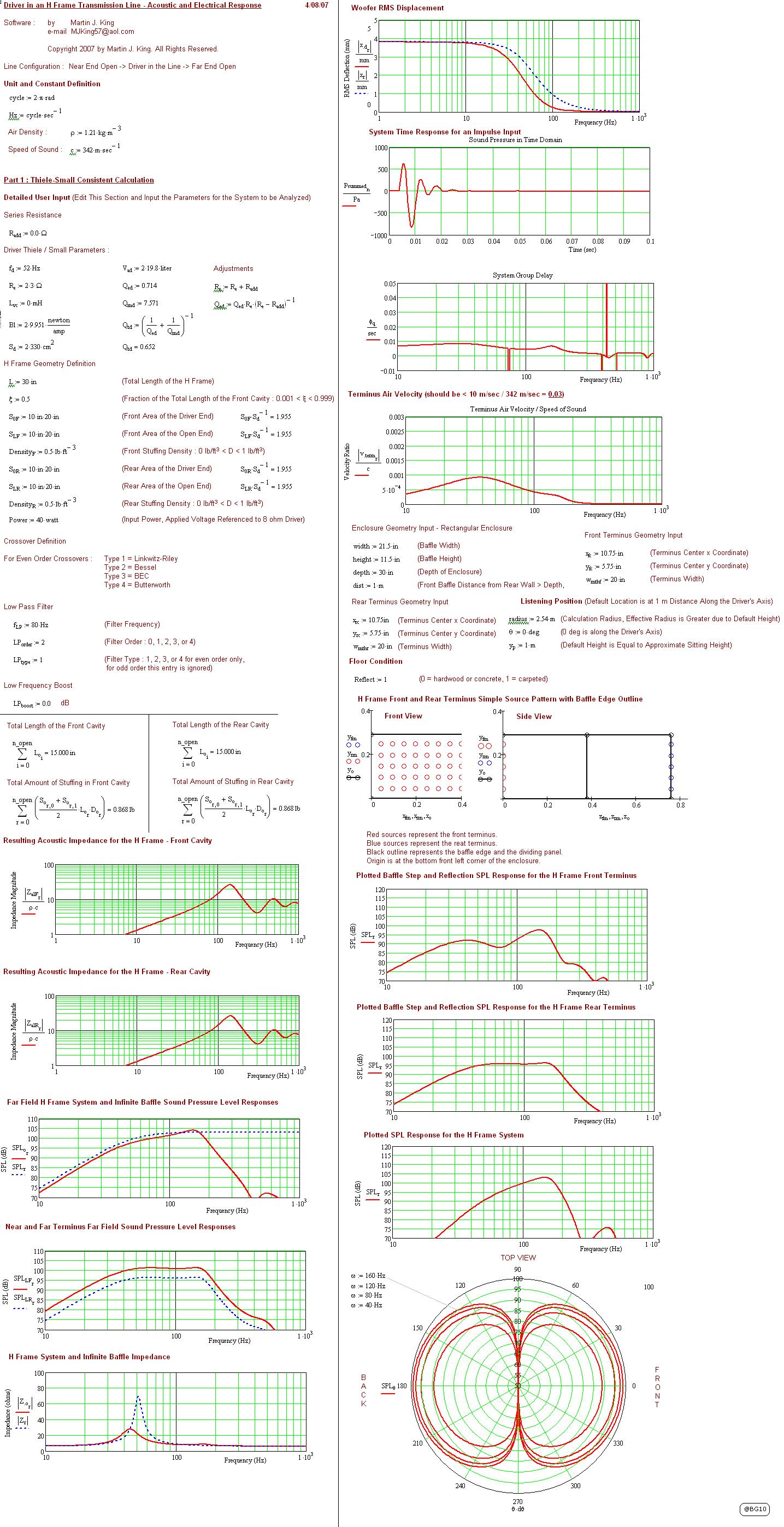

Yes you can reverse with almost no performance differences, see the picture.
The program can be found here:
Quarter Wavelength Loudspeaker Design
The H-Frame simulation uses 2 drivers as seen in the T/S data.

Hey Bjorno, I got all tangled up at work and am just now getting back to this project. When I am looking at your last post about the plots, it shows that the front goes down low with a little bump in it and the back terminous goes low and is flat, but the whole system peaks at around 150hz and rolls over below that. Is that the total bass responce will look like (sound like)? My midrange drivers go down to 70hz or so, so I am confused if the bass box will do anything for the whole system. Forgive my ignorance. Cheers.
I think the 150Hz bump is due to the H-frame resonance. Linkwitz describes it for example and I believe he avoids it by crossing over at 100Hz.
