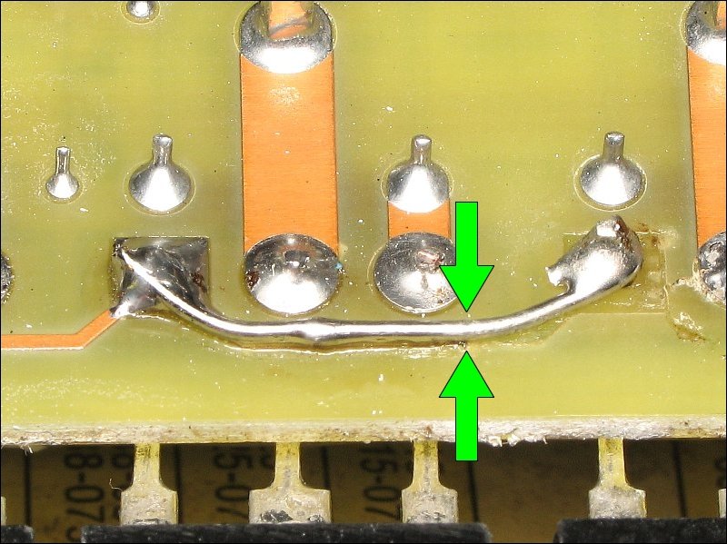

Now i really messed it up!
I was going to put the driver transistors
back into the board.
And i think one of the legs got stuck
and lifted the pad of the board.
I tryed to pull it down and weld it
but the hole thing fell of.
Now i dont have any pad to weld the
transistors leg to =/
Is there any good way to fix this?

If you use a small jumper wire like the one in the image below (leg from a 1/4 watt resistor), it will be reliable. Scrape the solder mask off of the trace and solder the wire to it. Try to go back far enough to reach another solder pad (for added strength). On this board, the original trace ends at the green arrows. The wire is soldered to entire length of the trace.

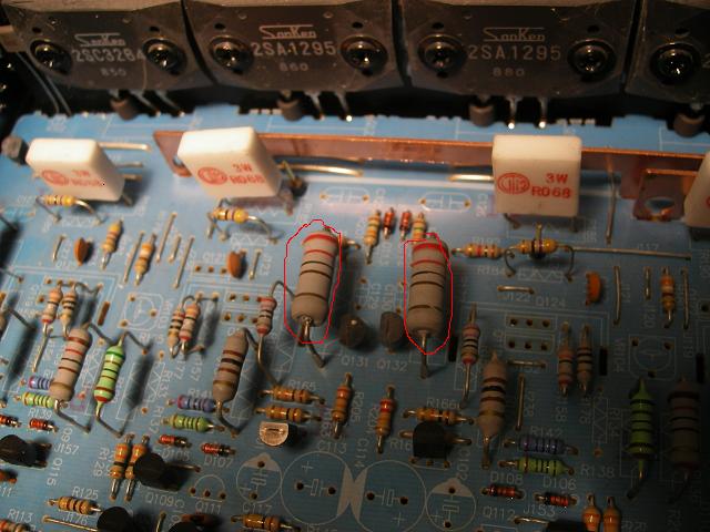

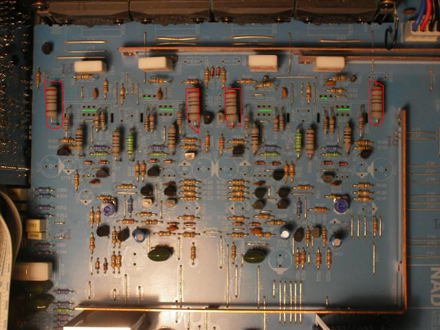

This is the case, by mistake I swapped one of the
drivers and the fuses blew.
And now some parts getting warm, i have removed a lot
of componets checking them for shorts.
The big Outputs i desolder, they are just screwed to
the heatsink pins 4mm over the board.
Havent found any bad componet yet.
But something is wrong.
I have marked 4 resistors, they get very hot
after just 1 minute. Strange.
Even after removing that much componets as you
can se on the picture.
None of the smaller transistors get hot.
Just two of them, but i removed them and they
are ok. Resistors still get Hot!
Everything so far is OK.
What should i do!? This makes no sense.
All the diodes are OK.
I do not understand why the resistors get so hot.
Bic current, but from where?
Anyone?

I don't have the schematic for the C350 but looking at the one for the C320, I'd guess that the resistors are connected in series with the 4.7v Zener diodes. This would mean that current would be flowing through them whenever the amp is powered up. They used large resistors because they are required to dissipate significant power. This means that they will run hot normally.
They appear to be 2 watt resistors. Measure the voltage across them and use the formula P=E^2/R to determine if they're dissipating more power they they should be.
Unless the Zeners are shorted, It's unlikely that they're running hotter than normal.
Didn't you previously have one working channel?
ok but after 1 minute my i burn my fingers if
i place my fingertip on them for a couple of seconds.
And i think it got worse after removing some
components.
But what is the most likely think that have blown?
Something has happend. Any tips? 🙂
Just looking at the board what would you do?
