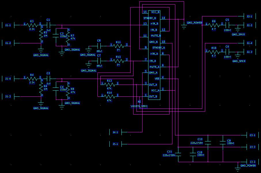

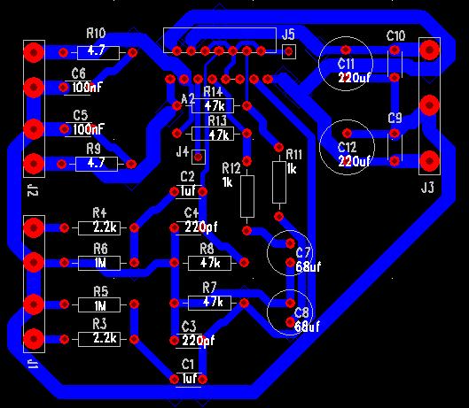

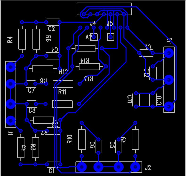

I'm now trying to design the PCB and got somekind of design. All traces are the same width because I didn't know what would be a good size for signal, ground etc.
I managed to pull all the traces but I'm a bit sceptic will this work in practice, so if one of you amazingly helpful experts could give me some advice.
I'll probably need to draw the PCB again, I know 😉
And forgot to mention that I had to change the design software... I'll post the new schematic also.
It's a mess! I know 😀
Need to do a couple of things:
-do some grounding work in the PCB to connect grounds
-make wider power and ground traces
-make right sized decals in some of the caps
and maybe move the speaker terminal next to the chip, so that the output traces can be as wide and short as possible.
How does it sound? Or can you understand anything of my messy sketch?

OK, since no one else has replied I will try to give you some pointers.
1. Power, ground and output tracks need to be alot thicker. At least 50 thou. Somewhere in your CAD package it will be possible to change the track width. Most of the tracks could do with being thicker. 20 thou for low level signal tracks is probably ok.
2. C9 and C10 need to be allot closer to the chip.
3. C11 and C12 should be as close as practical.
4. I would put J2 near the chip amp rather than run the output past the input as this could cause oscillation.
5. You currently have a voltage gain of 48 this is quite high. I would recomend changing the 47K resistor to a 33k or even a 22K part. As the lower gain will reduce the sensitivity of the amplifer reducing noise (hiss) at the ouput. They usually sound a bit better like this as well.
6. I would recomend looking at some of the other PCBs on this forum as it will give you a better idea of how the PCB should look.
Thats it for now.
Andrew

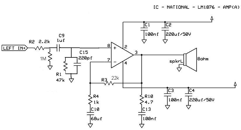

I think that the values for that resistor are between 27k (gain 28) and 44k (gain 45).
Andrew's suggested 33k option gets the middle ground with gain of 34.
However, the current picture with 22k (gain 23), gives me a question: Where is the active preamplifier circuit?

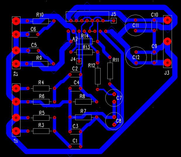

And I've made some changes to the layout also...

So, do you define the application as "without preamplifier"?
That will be more difficult to voice for hi-fi results, but its possible with LM1875(6) chipamps.
If no preamp, do you have a line level source or do you have a headphone (ipod, computer, etc) source?
Which one?
If you say (define the application) then there's no guessing. Or in my case, "less" guessing. 😉
Hey, it would be really helpful if the PCB had the component values written on it. Then it would be instantly recognisable as to what the components are doing.
