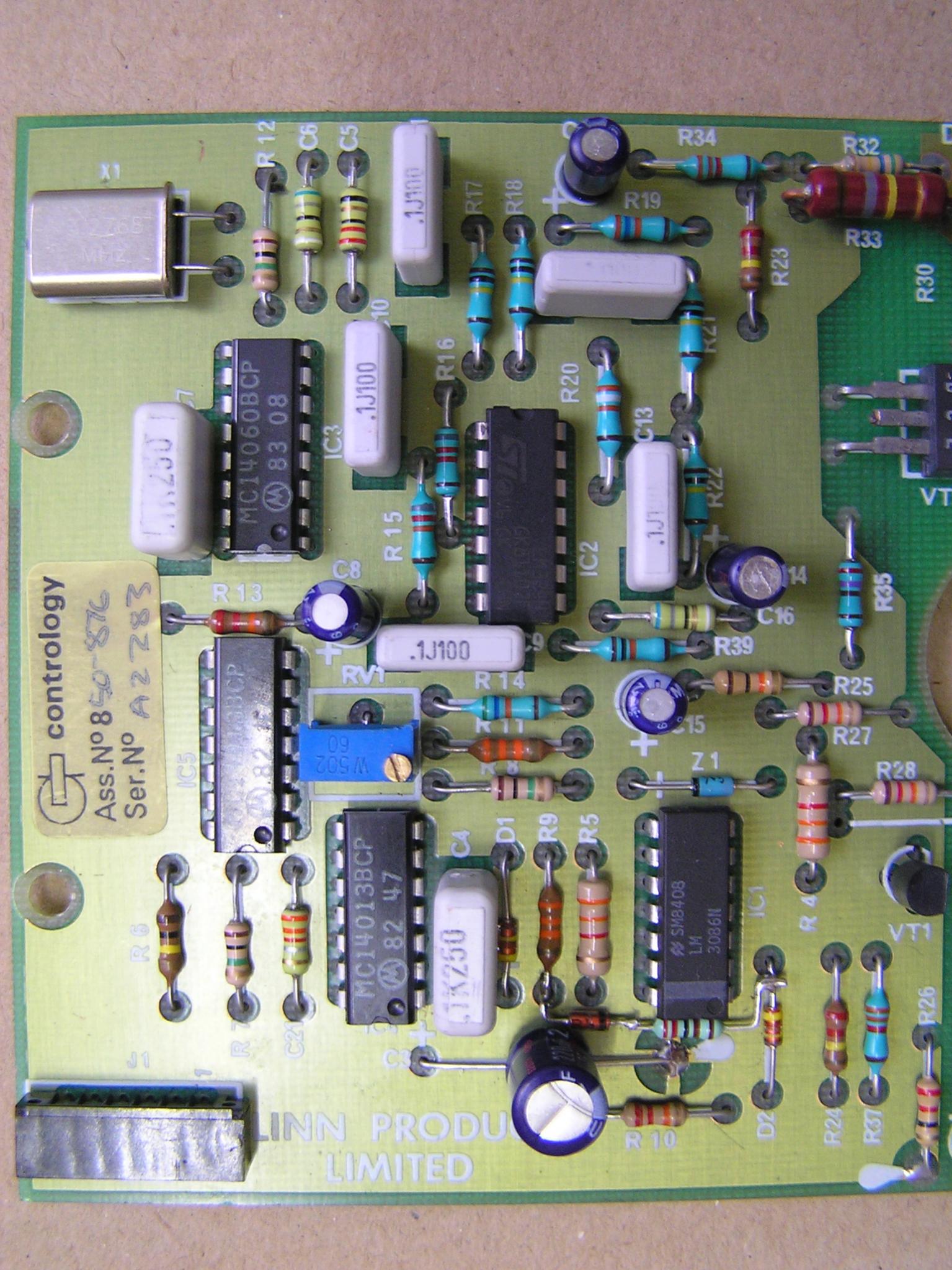

This is a picture of mine from quite sometime ago. Its show C3 soldered to the upper plane.

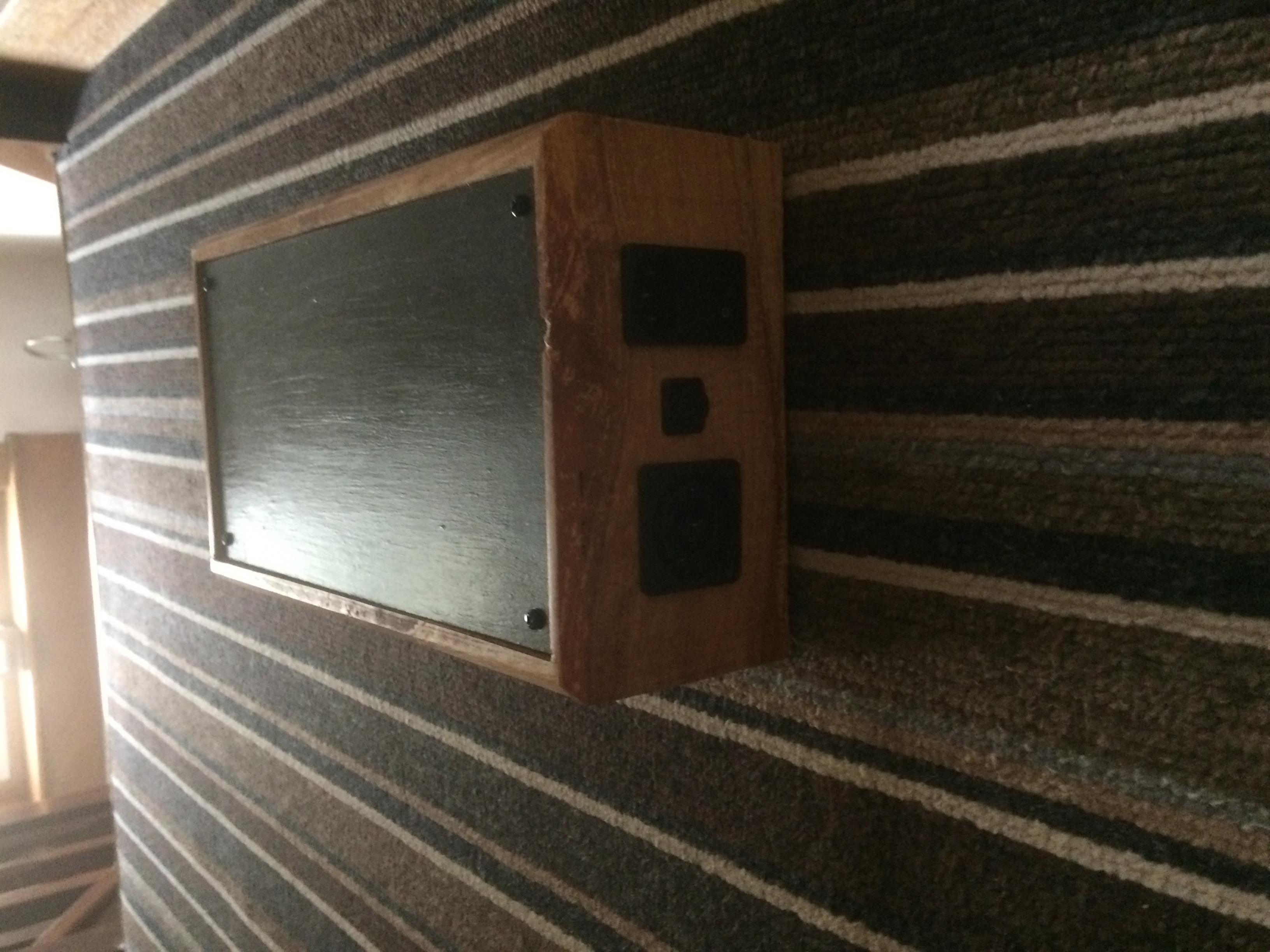

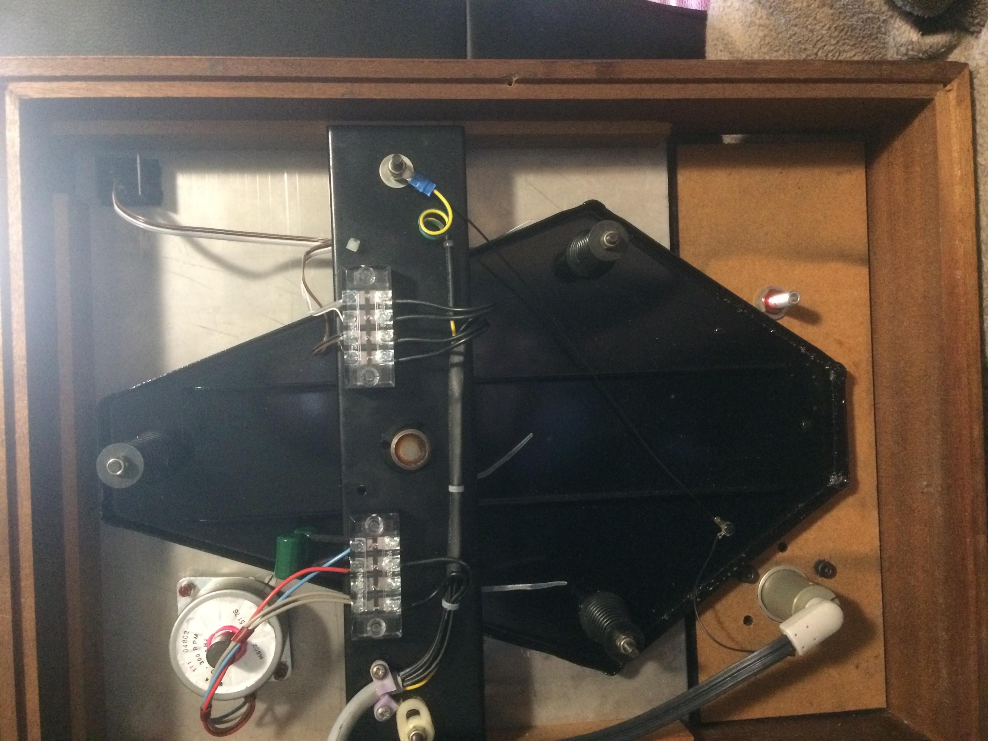

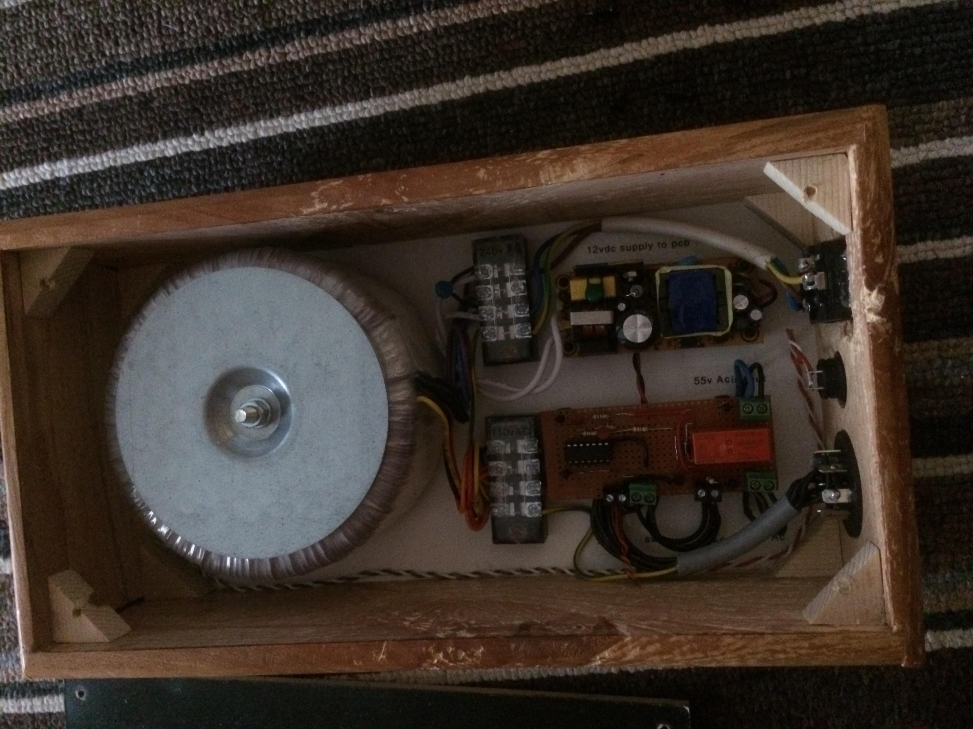

Update on my previous post.
While I am deciding what to do with the Valhalla, I built an Armageddon clone.
Got it hooked up yesterday to test it and with a bit of capacitor matching it’s up and running.
I’ll test it for a few weeks, while I work on the wooden enclosure.
First impressions are really good & I might not go back to the Valhalla!
Valhalla update
Just thought I’d update my post.
Hopefully I’ve managed to include some photos, two of my Armageddon power supply and the other of the LP12 wiring conversion.
More than enough happy with the performance, so I’ll leave the Valhalla repair for now!
