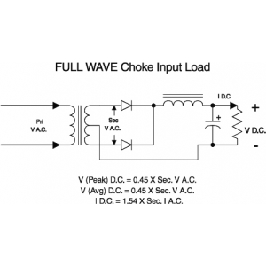

The absolute maximum capacitor value on the cathode of your 5Y4G is not to exceed 32uF and it should feed a choke before another 32uF capacitor.
340 0 340 will give you about 380v off load through your valve, due to about a 90volt drop in the valve.
Why are you placing a 470n in there, this is not a semiconductor power supply!
You cannot successfully simulate a valve circuit. All valves, even of the same type, are different ... build it and see what really happens. Get your fingers wet and gain experience like us seasoned engineers did.
Reactions: rayma
You need a L-input filter, + a bleeder resistor combined with a full-wave rectifier. With silicon diodes, you should arrive at ~330VDC, which can be tweaked with one or two additional RC cells.
With a tube rectifier, the bleeder can be lighter and RC cells shouldn't be required, for the voltage at least: you may want them to improve the filtering, in which case the bleeding can be even lighter.
In your case, choke input is practically mandatory

If you go with a L-C-R-C .
You will be able to drop a lot of voltage and get a nice stable B+. The C1, C2 do not need to be large, in the 22uf range is fine. The L is doing the heavy lifting in this design. The R is used to fine tune the final B+
You can approx the load with a 3K ~ (312V/ 112ma) 30W ~ (.112A x 312V) resistor or a string that adds to about that. It will get hot but allow you the get the B+ in the ball park.
The unloaded B+ is always way different from the loaded. Because the transformer has inherent poor regulation. It is flapping in the wind as they say.
I hope this helps

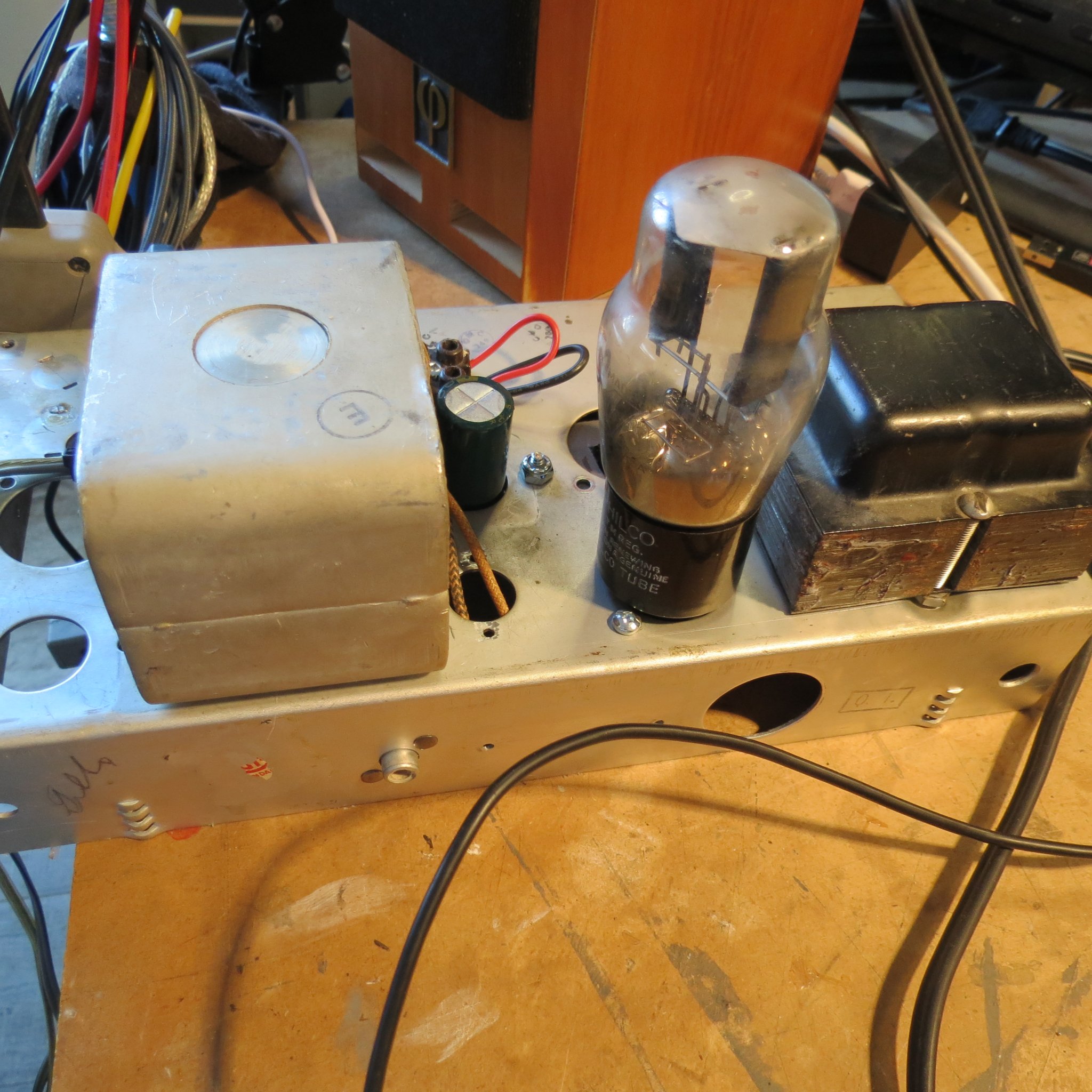

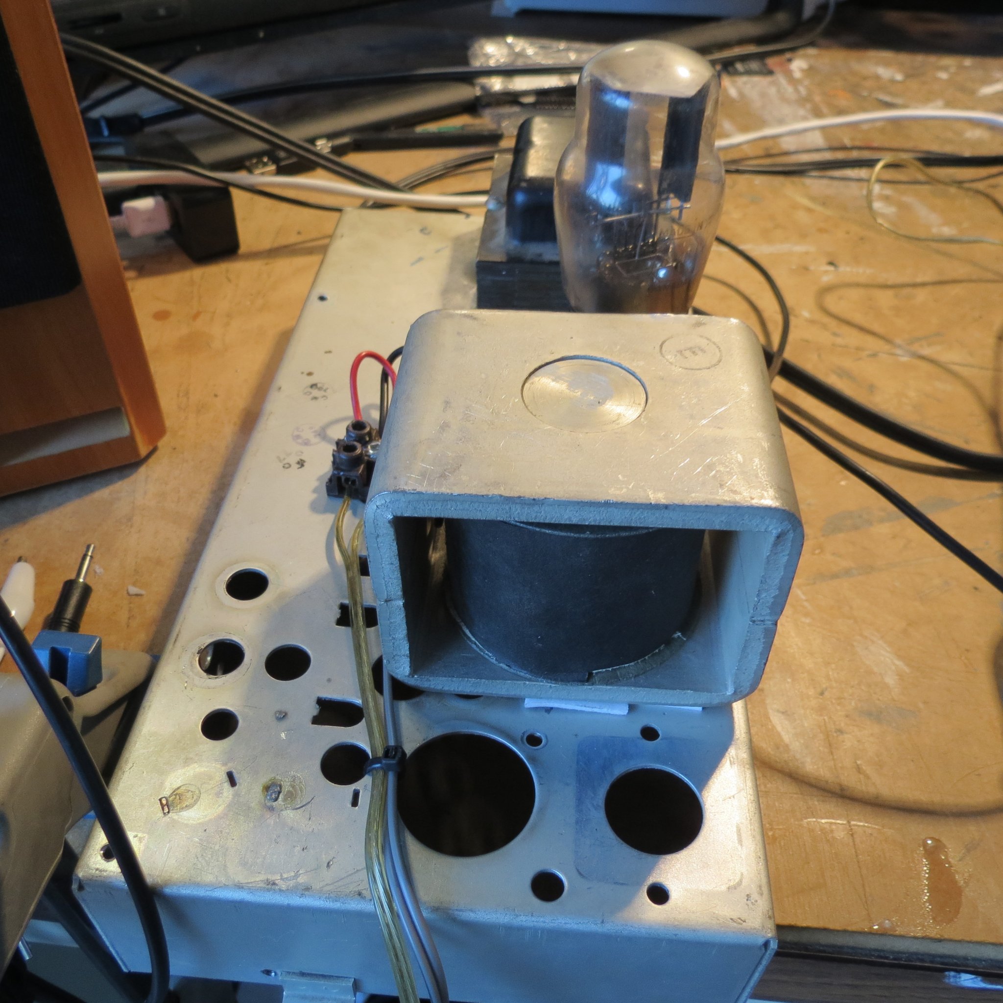

So... I thought you guys would get a giggle out of this. Here I am whimpering about being too broke to afford a 5H choke (shipping is 2X purchase cost).
Then it struck me - the Marconi radio I salvaged the PS parts from used the coil of the speaker as a choke in the original design so why can't I do the same.
I got out the mini grinder and cut the coil away from the old speaker frame, mounted it on the PS chassis and connected the circuit through the coil.
Guess what... it works! What's more, the EL84 amp sounds great and there is NO HUM - not very little hum, NO HUM at all.
Anyway, thanks for all the suggestions and ideas. All good now. 😊
