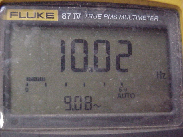

thanks for the links and the quck reply... read them up but still quite puzzled... right now it looks like a good choice for my needs would be the Fluke 89 IV... which I can probably get on ebay for less that $200 but from the data sheets I can find on this and my understanding it doesn't measure AC voltage at frequencies lower than 45hz... is this so? What else should I be looking at that would be able to measure AC voltage throughout the whole 20hz to 20khz range?
Now, really? Don't believe what's written on websites.
Go to www.fluke.com and download the PDF.
The model 87's frequency ranges from 0.5Hz to 1000Khz.
Just go and buy one, you'll be happy as a clam*.

Don't get confused between frequency measurement and voltage measurement.
Most of the Fluke DMMs measure frequency over a wide range, but when they measure RMS voltage or current, the frequency range is much more limited.
The maximum frequency when measuring voltage is usually much lower than when you measure frequency.
You're generally better off with a 'scope for doing that.
Remember that unless you're dealing with pure sine waves, the 'RMS' voltage will be pretty meaningless for most purposes - and even then, you need a 'true RMS' meter for accuracy.

the spec for the frequency range of voltage reading ability should look just like that for amplifiers. eg. 20Hz to 500Hz +0.5db -3db or something much superior to suit your requirements.
If you arrange to make comparisons of almost identical voltages then the response errors of the DMM can be almost eliminated to quite high frequencies. I use mine upto 200kHz but it's spec is to only 500Hz.
Asumming my sine wave generator is putting out nearly constant voltage as I sweep through the frequency range, I find that a 1990mV signal at 100Hz appears to have fallen to about 160mV when reading a 100kHz signal, but comparison negates that big apparent error.
