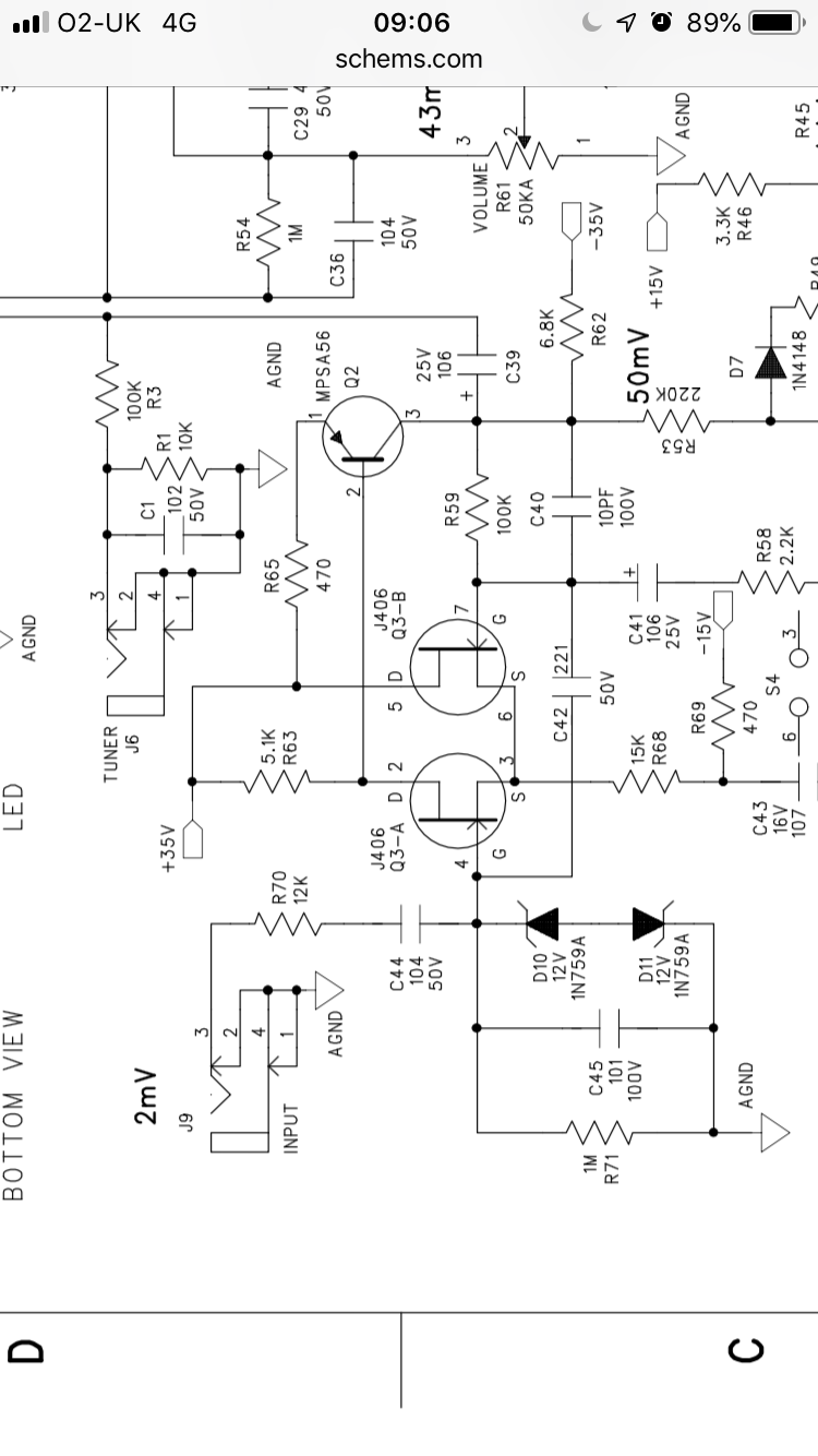

I fed a 200hz 100mv signal into the input. I can trace it to C44 which is not far in after the input. . Then I loose it completely.
I can’t see it anywhere after that. The signal should be available at the other side of c44 right?
I’ve checked the electrolytic capacitors and they test ok. Can’t find any shorts on the diodes. Resistors all test ok. I’m not sure about testing the FETS yet. I Will look at that later on this evening.

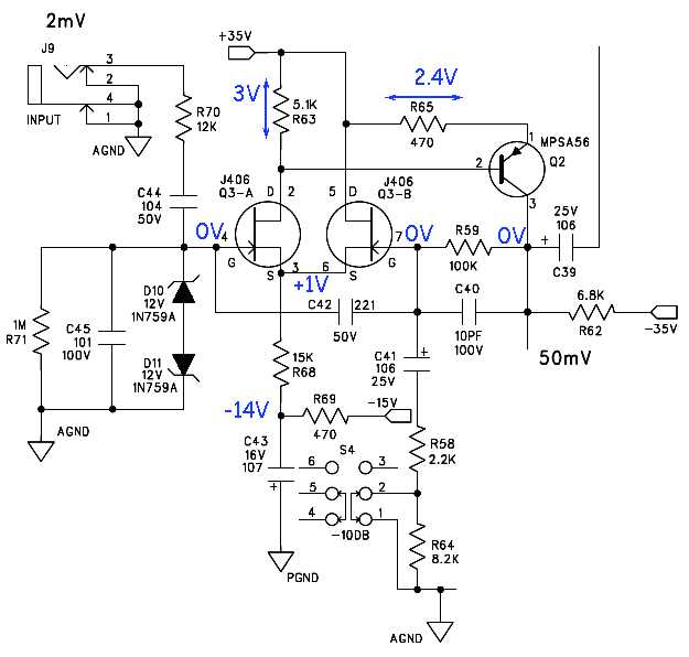

Hi everyone,
I have the amp plugged into a variac @120v.
I’ve noticed that there is -15v missing from the Source of Q3A and Q3B (R69 voltage point indicated on schematic of the preamp board).
I’ve tested R69, R68 and C43 and they all test good.
Voltage on the Drain of Q3A and Q3B is +28v. On the schematic it states +35
Voltage on the Gate is -28v and at voltage point on schematic which s -35.
I’ve tested the JFETS with a multimeter and they seem to test ok.
Wondering now Would this be the reason why the preamp isn’t working.
The amp is working ok when I play through the return jack. But nothing when I test through the input jack.
I have 13.9v on all of the opp amp ICs.
Hope someone can give me a hand here.
Many thanks
Paul
PRR
Joined 2003
Seems unlikely.
35V versus 28V *could* just be general low voltage.
I've marked-up the expected voltages. Which ones are different on your victim? (If possible, crayon your voltages on the image.)

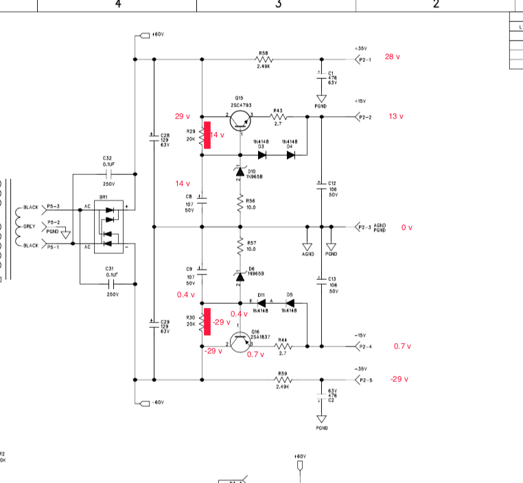

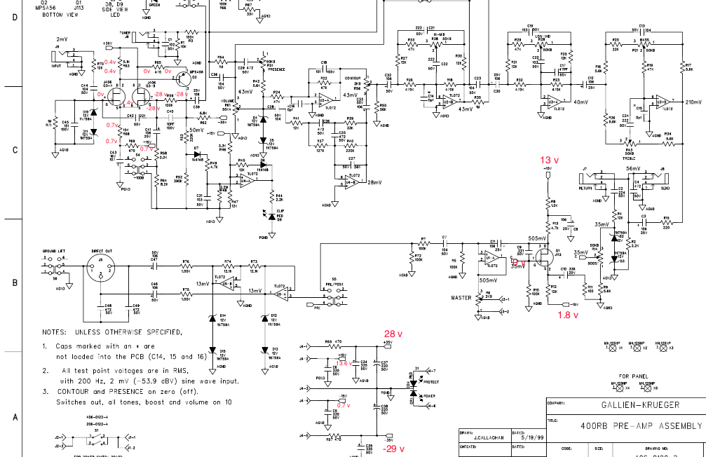

I have taken some readings and entered them into the schematic attached.
Ive a funny feeling the -15v is not being sent to the preamp board from the main board. Might possibly be that cap c9 cap or D11 or D5?

So after disconnecting the preamp board from the main board I noticed the -15v is not there at P2-4. I tested All the components around Q16 and found R30 Open Circuit. I replaced this component and straight away all voltages where present at P2 1 - 5
The amp is back working again and seems to be performing ok. I will run it for a few hours and hopefully it will be ok.
