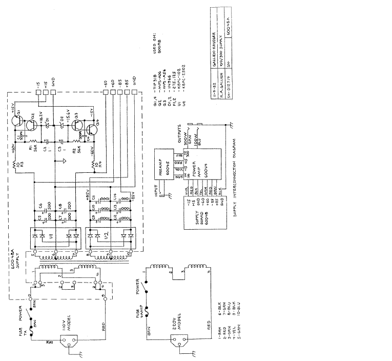

hello, does somebody know the value of C1 and C4 that I don't understand it well in the supply schematic?
Kinda' hard to see but on the 400rb the supply looks the same C1 and C4 are 561pf, looks like they're there to prevent oscillation.

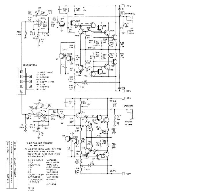

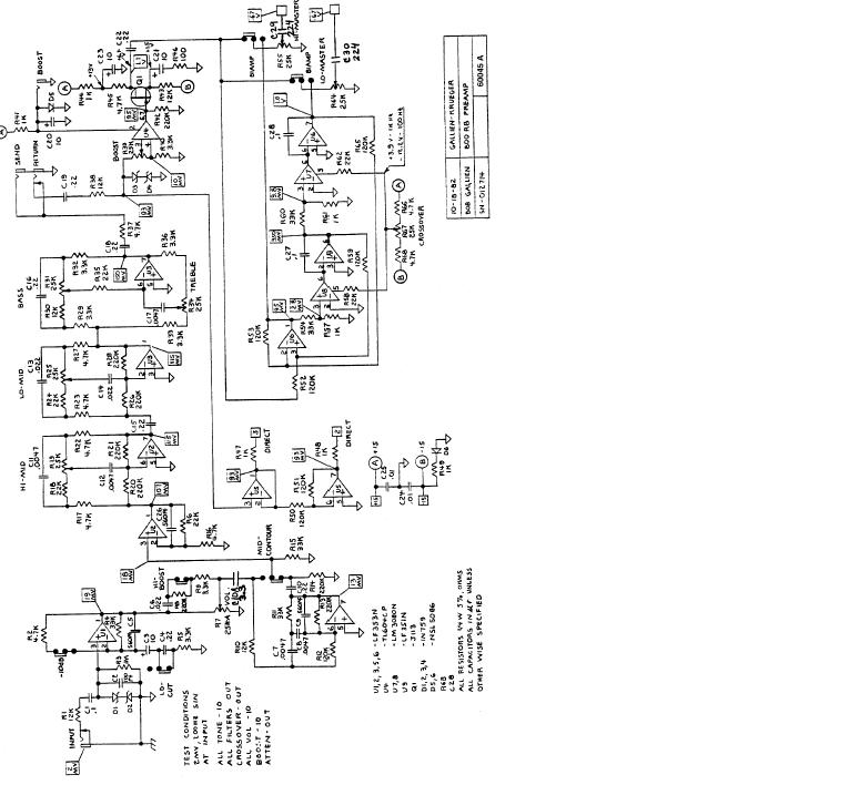

GK 800RB schematic request
Hi
Not sure if this is the correct place to post, but does anyone have the 800RB schematic please
Hi
