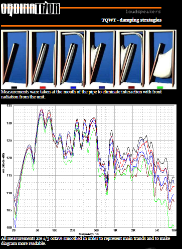

Unfolded pipe with properly designed pipe vent still not as smooth as a MLTL: Voigt Pipe
Damping schemes:

The small TQWT will perform similar to top most driver location, but with a lot of added 'ripple' [deep notches in the response] unless heavily damped, so from mine and some other forum members experiences, the shorter MLTL is much preferred and no doubt in my mind why Supravox is now offering them.
