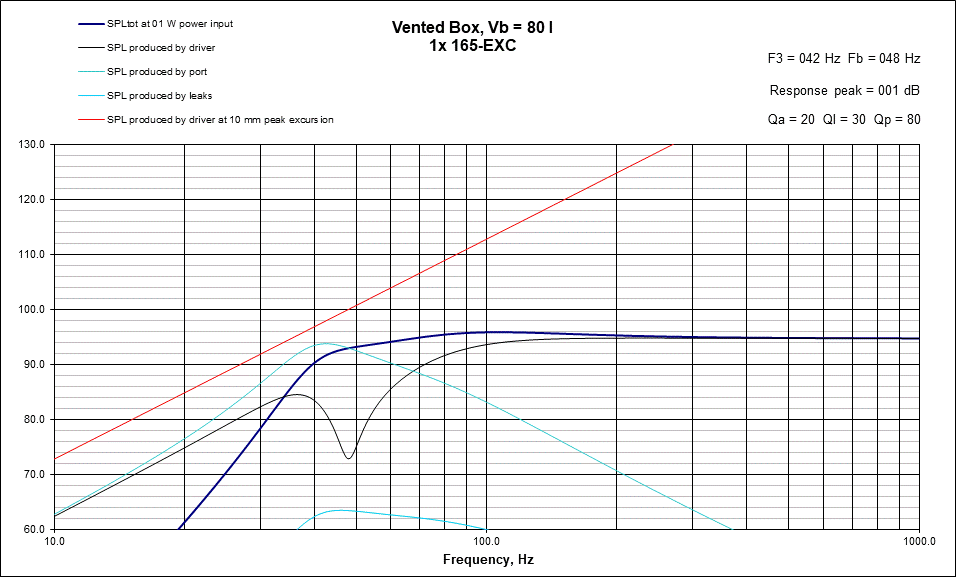

The size of a vented box, whether reflex or QW is dictated by driver Fs, Vas & EM damping (Q), or more accurately, those characteristics largely determine its behaviour in a given volume & tuning. One of the advantages of Novak, Thiele & finally Small's work is that they allowed you to quickly determine a minimum practical box size, i.e. get the most from the least. Unfortunately, they can't change the laws of physics. The Supravox units are quite traditional in design terms (no bad thing) & tend to want a larger cabinet than the 'modern' fashion, like most of the quality classic units up to the late 1960s.
If you really have to have a small box you could try vented, 80 litres tuned to the high 40s. Lightly damped LF rolloff with a bit of additional gain through the mid-upper bass due to the undersized box -that can in some cases be helpful in adding a bit of extra 'slam' to rock, some classical etc. recordings. The box output is fairly narrow band so careful damping would be needed. Otherwise, sealed or leaky sealed it would need to be. 80 litres, with light damping would give you a box Q roughly in the mid 0.7 region.

thank you scottmoose.

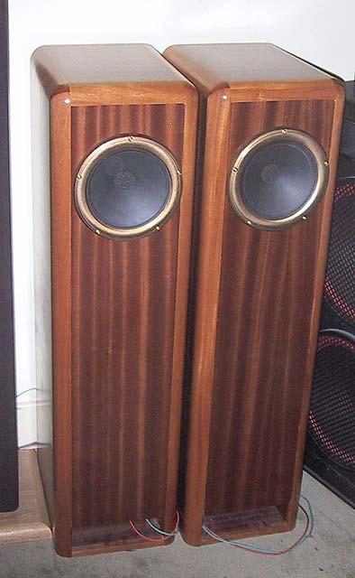

supravox sugested tqwt enclosure is about 46.6 Litres. an is made for 165lb driver. but may work and with EXC.

ok i try to make some paper work, and visualize your measurments😉 one more thing. MLTL internals how is made? maybe some photos ? becouse most pictures in web , looks like bass reflex inside, only port an nothing more,exept few bracings inside enclosure. so some picture samples would be nice😉
