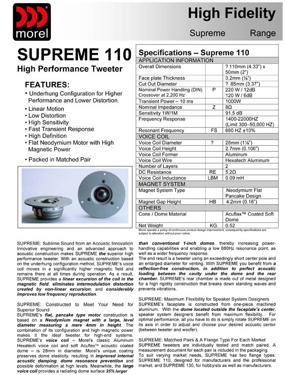

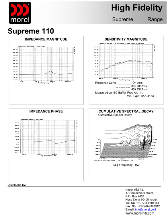

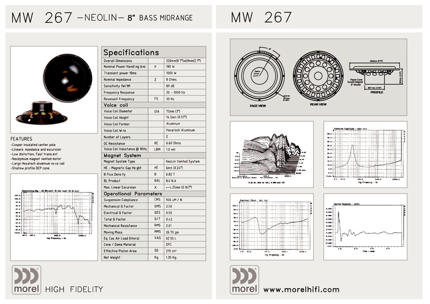

I'm building a two way speaker with the following drivers(files with specs are attached):
Tweeter - Morel Supreme 110
Woofer - Morel MW267
I have already built my cabinet (designed after the magico's).
I have tried using Xover Pro to design a crossover. I have no experience design crossovers and I'm not sure if the results are good. I have used theoretical results given from the company and have not actually measured my speakers.
The crossovers are also provided here in attachment.
Are they any good?

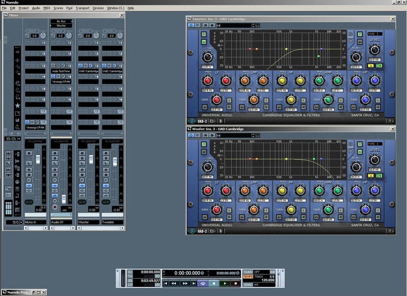

Not sure if you're willing to get wrapped up in much multitrack audio software mess right now (or if you aren't already), but I'm going a weird route on mine which seems promising:
I've got my hi/low drivers temporarily bi-amped with direct feeds to each from the amp's left and right channels. I keep a mono source track in an audio program which is routed out to two separate mono output busses (one outputs to the left channel, one to the right). Each of those output busses contains a plug-in EQ set for either a high or low pass filter. I can either place an audio file on the source track, or insert a virtual tone generator on it and spit out sines or pink noise, and the signal gets split and filtered to the two drivers. While it's playing, I can sweep around on the EQs to audition different crossover frequencies, as well as changing the slopes for different filter orders. There are also usually a few places where you can easily flip the phase to see how that does, but I haven't generally liked it. Note- Much of this stuff depends on whose audio program you're running and which EQ plug-ins you've chosen, but it's no problem rounding up capable free stuff in both areas today.

However, you are both shooting in the dark without acoustic measurements of the drivers. While the generic responses of the drivers from the manufacturer are an OK start point they are for infinite baffle and will differ from the performance in your cabinets.

In a bit of a rush tonight, but I'll try to describe it. I'm running Nuendo (by Steinberg, similar to Cubase), but I've also got a project setup in Reaper which does the same thing. Also, the two EQ plugs I've been using are part of Universal Audio's Powered Plug-Ins system, which requires hardware, but there are about a million parametric EQ plugs with similar functions and layouts. There's also a free VST plug out there called "Rubber Filter" which does nothing but filters (which is all I'm using my EQs for here). Audition or whatever you end up running probably won't be exactly the same to get this result, but I'm sure there's a way.
In Nuendo, you can create multiple output busses (either mono or stereo) which your audio tracks can be routed to. These in turn, need to be assigned to physical hardware outputs. In my case, they are two mono busses named Woofer and Tweeter, routed to the left out and the right out. Nuendo allows for plug-in effects on these bus channels, so there's a Cambridge EQ on each of mine doing the filters. Then you just need some source channel to feed the two output busses. I have one mono track in the project doing that. I can place audio on it, but it's also got a test tone plug inserted which I can switch on to output tones and noise. That's coincidentally a freebie called MDA TestTone. To get the source channel to the two outputs, I'm actually using the channel's "sends". Nuendo gives you eight of those per channel, and they can be set to "pre-fader", so I can keep the volume for the source track turned down and keep it from double routing to anywhere else in the mixer.
That's about all it is, and again, it would probably be different instructions for another app. Again, just keep the volume extra low at first and test by muting or turning down one of the outputs to make sure you're getting the correct filtered signal to each driver and nothing else.
There's a whole slew of ways you can achieve that same thing with the EQ plugs and outputs too. My Reaper project isn't configured the same as my Nuendo one, but they both work. You can even just use two mono audio tracks, with the same exact file and an EQ insert on each, then pan one hard left and one hard right to a regular stereo output with no plugs on it. I chose the single source track thing as it was easier to drag files onto it and run the tone plug.
I'll attach a picture. The mono in channel is what I was using for the measurement mic, but as I mentioned, I got more feedback from just listening to material. If you can make out the text, those plug inserts that say "Voxengo SPAN" are a free analyzer plug I was using to compare the source signal to what the mic was picking up from the speaker.
