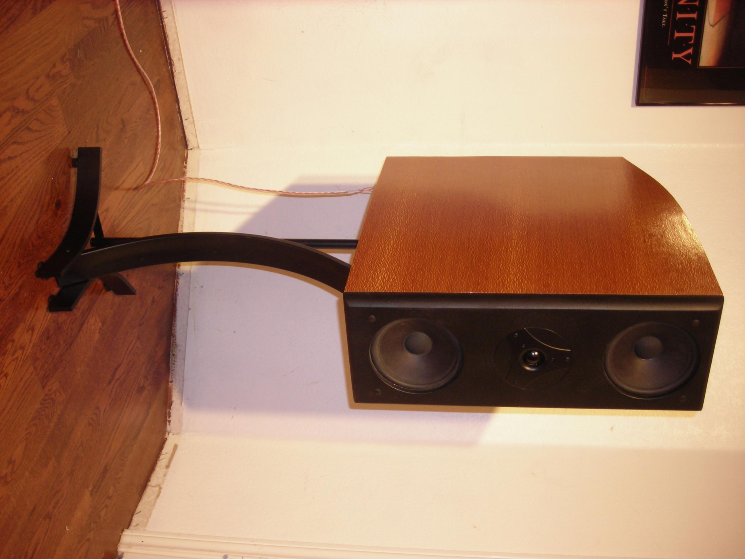

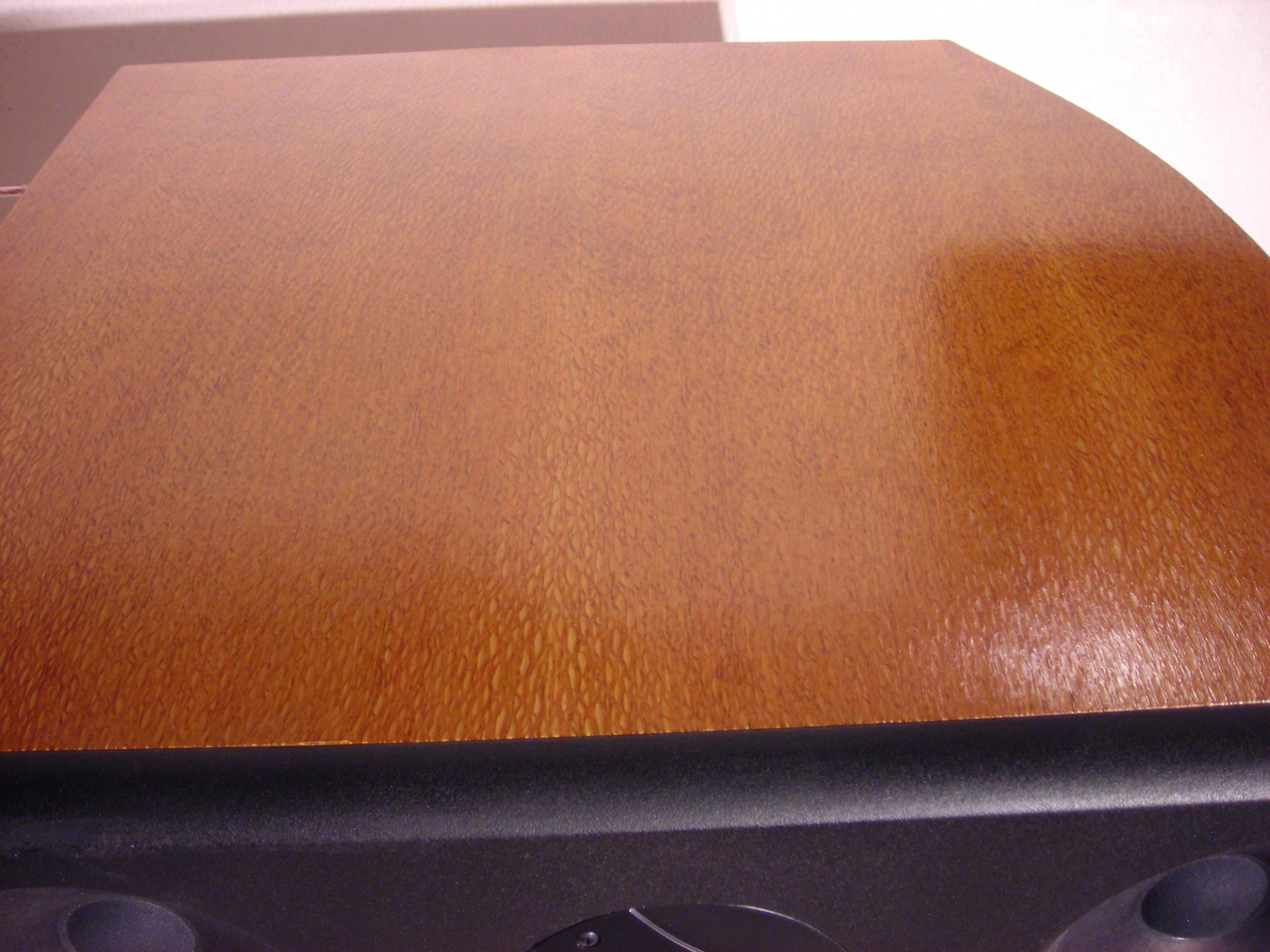

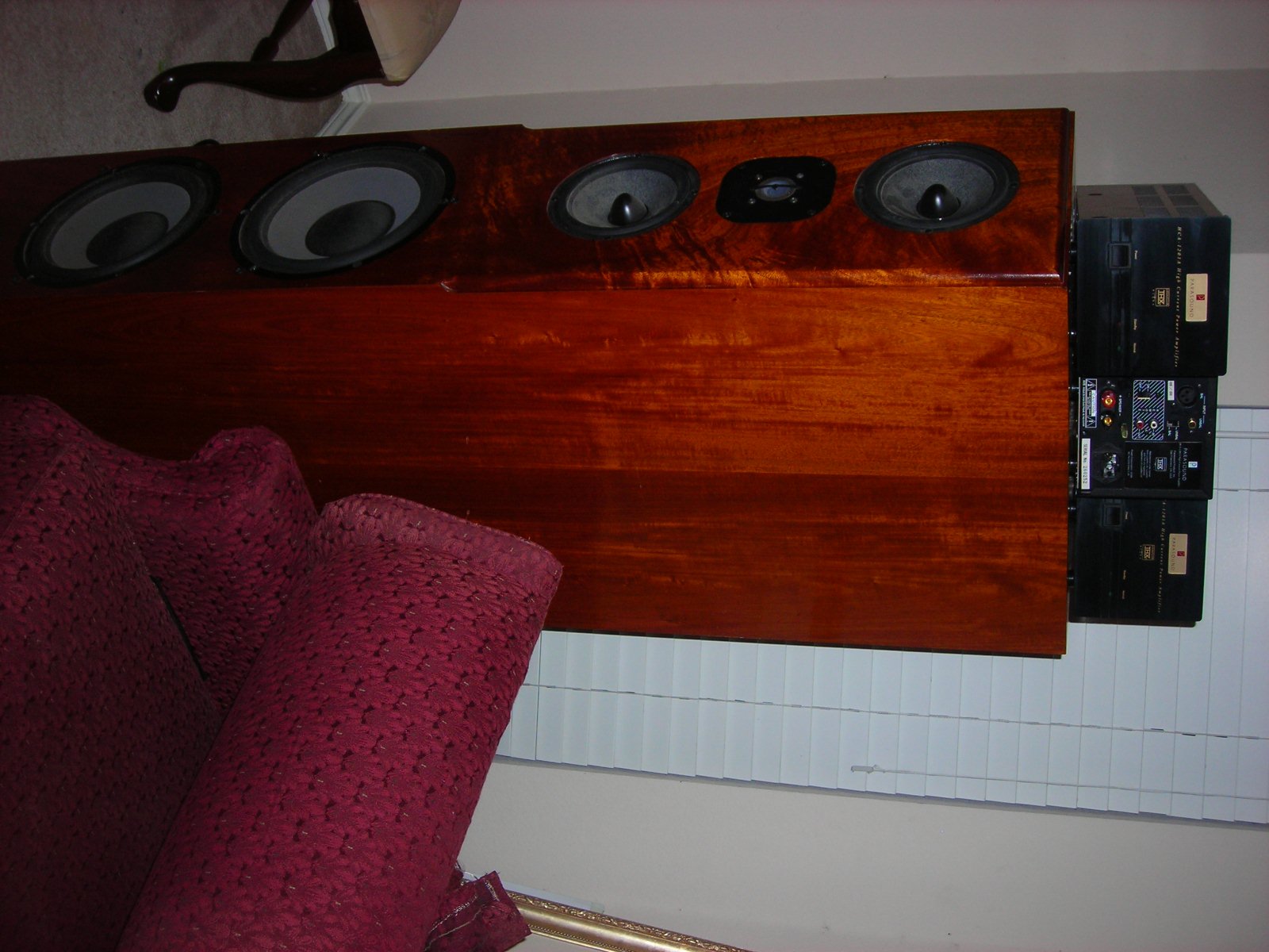

The MTM, Lace wood and truck bed liner paint with poly over the paint, is 2 Focal paper drivers, $20 ea, with a K-1 tweeter, $12 ea. Sound is very good for a budjet set up, excellent bass. The other was all Focal drivers using the older TC120 tweeter. Nice bright sound, hard dome tweeter, done in Mahogany
