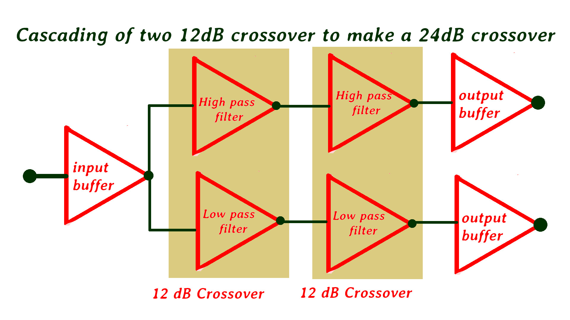

I will check out more about cascading those 12 dB filters and report you back with my findings.
The Rod Elliot circuit is basically the same but for 310Hz, that could be easily scaled by 10.

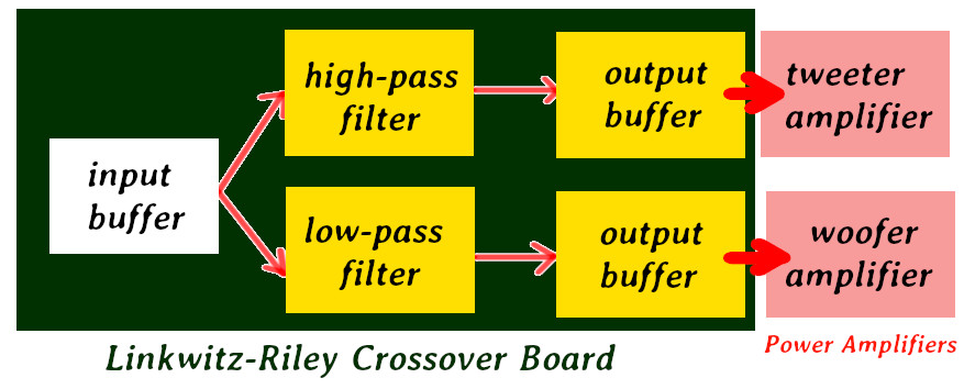

I need to learn more about these up-scaling. I saw in the documentation of the readily available kits on the international shops that they mentioned this scaling by 10 option. Could you kindly elaborate on this?
I posted two images in the attachments about my findings and progress. Could you kindly have a look at them and correct me if needed ?

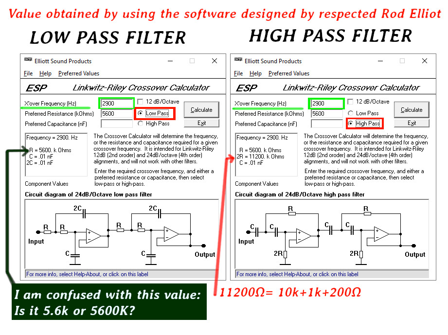

On his website, Rod Elliott has a downloadable calculator for his crossovers;
https://sound-au.com/software/esp-lr13.exe
I used it for the P09s I bought and use.
Thank you so much!
I tried that as per your recommendation and obtained some values for my desired x-over frequency @ 2900Hz. I have some confusion which I mentioned in that image. Is 2900Hz a good value or I should go up a bit higher? But my concern is the availability of the components. Kindly have a look at the attachments of this post and my previous post.

I used Rod Elliot's Cross Over Calculator to obtain the R values in the Linkwitzlab actual circuit.
Here is what I got:
Crossover Frequency = 3000Hz
1. Low Pass Filter :
R = 1.71K
C = 22nF
2C = 44nF
2. High Pass Filter :
R = 1.71K
2R = 3.41K
C = 22nF
Kindly check this too and give your much needed valuable advice.

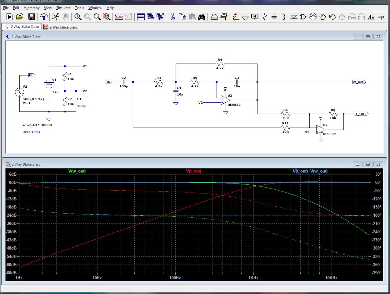

If you are looking for a simple to build and easy to tune crossover, the circuit below might just do your job. But do note this is not a production circuit, it will need a bit of debugging to get it perfect.
The woofer out is an active low pass filter.
The tweeter out is developed by subtracting the woofer out from the input.
The overall circuit is unity gain.
To change the crossover frequency simply change C3 and C4 keeping them equal.
Frequency response curves are in the lower panel.
Note that depending on driver time alignment it might be necessary to reverse the tweeter connections after amplification.
The LTSpice file is included.
