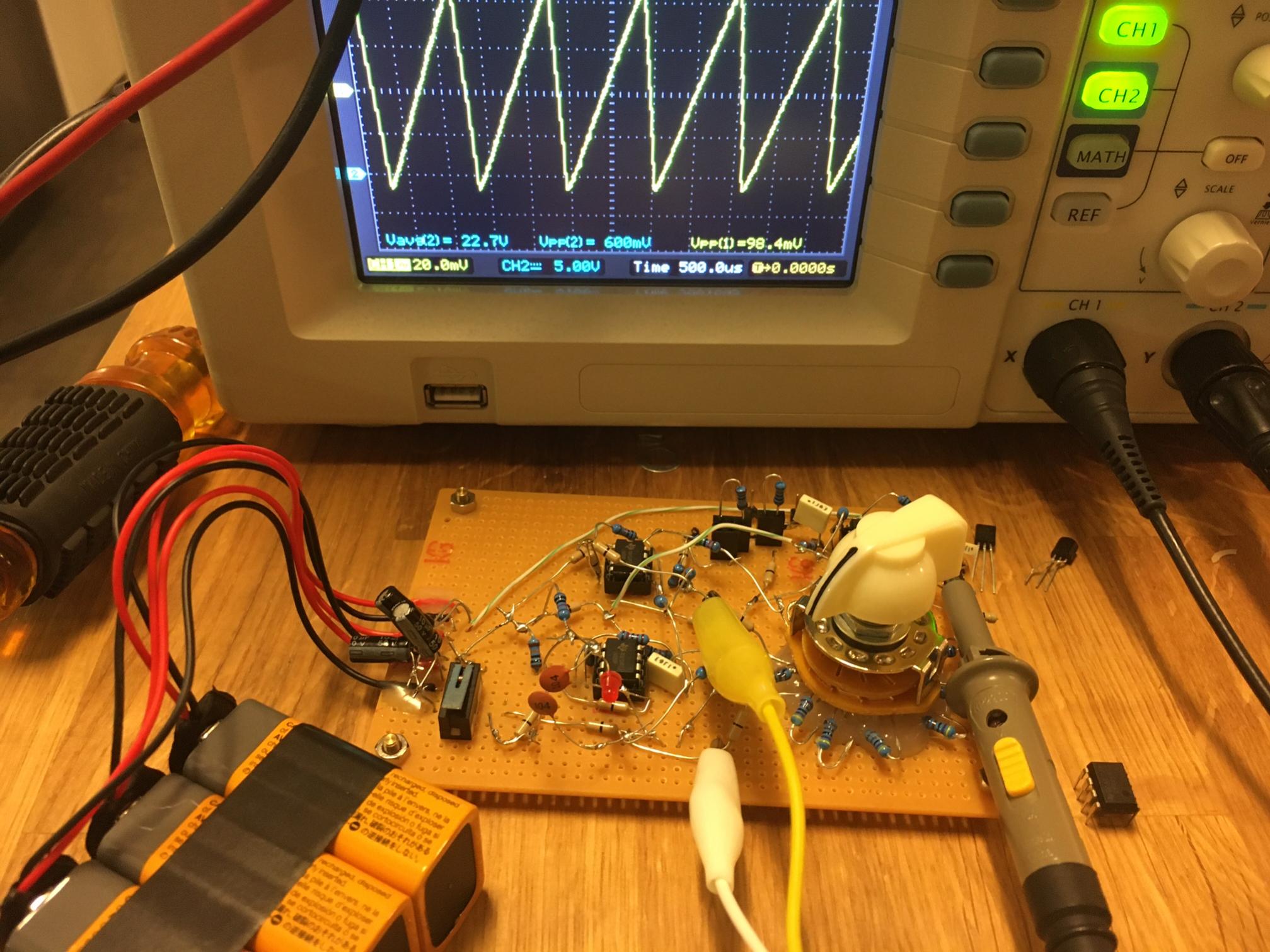

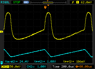

Another consideration: You may want to run all the opamps from the same power supply. That will limit the issues you have once your stack of 9 V batteries (which I'm assuming you're using) discharges. Currently the batteries will discharge at different rates, which could give you some rather 'interesting' behaviour.
Tom
