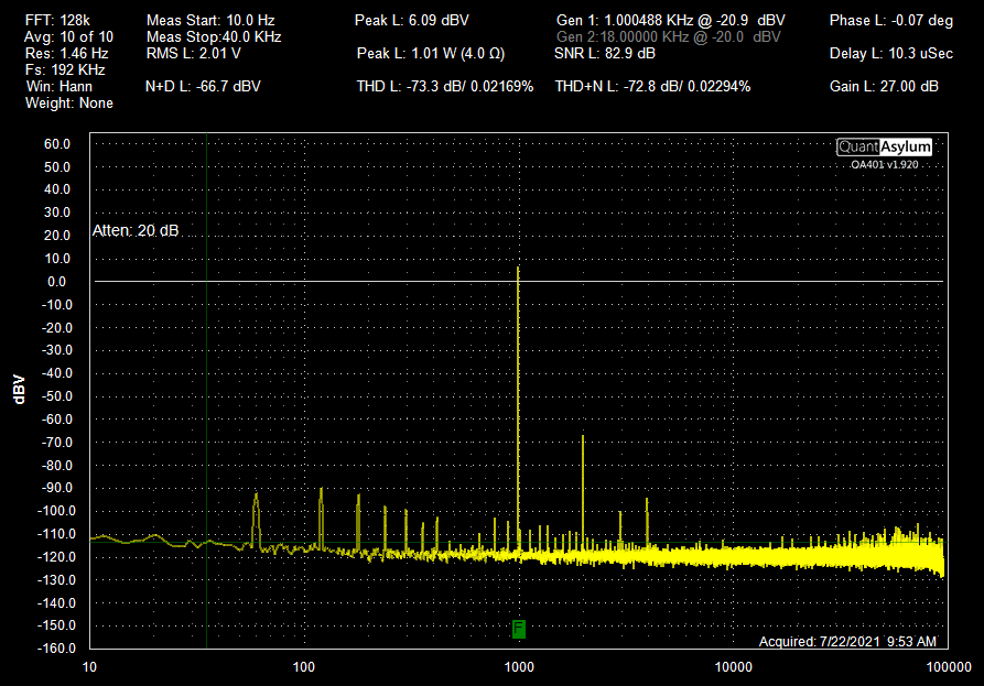

I increased the resistance of the gate stopper resistors to 1000 ohms on Q3 and Q4, the P-channel devices.
That did stop the oscillation bursts. To maintain a circuit balance, the gate stopper resistors on Q1 and Q2 were also increased to 1000 ohms.
The large difference in bias between Q1 and Q2 still exists, but as stated previously, my best guess is that it is a function of the specific devices on this PCB.
The distortion spectrum now looks much better, see attachment.
So, this amplifier is probably as fixed as it is going to get.

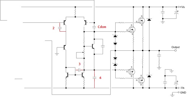

Hi, I think your oscillation comes from input stage, to high gain in VAS and non adequate Miller compensation. Try increase Cdom capacitor. Second put same capacitor on position 2 or position3, or put compensation capacitor of 100-330pf on position 3.
