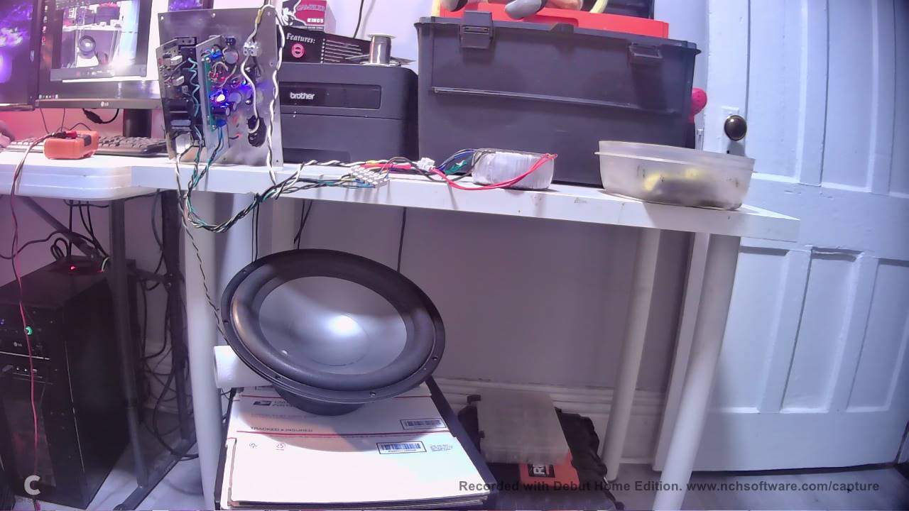

I don't know the T/S parameters of the Polk XT-12. It works , but I heated up the VC - I was a dummy and Xmax'ed it with my DIY plate amp. (photo 1) .
Amp worked TOO good @ 14hz , I smelled the VC after 20 minutes. I just wanted to see the worst case load for the new amp.

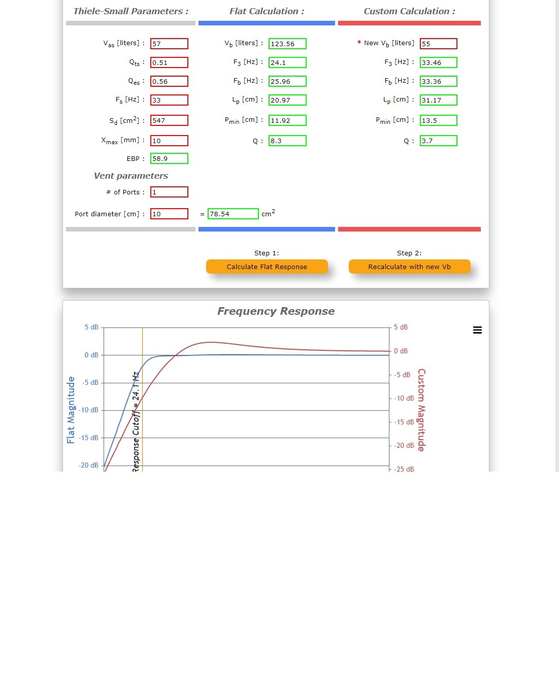

In (photo 2) I plugged in all my T/S parameters and get roughly a 32hz F3 (with the smaller Vb). I actually get gain between 40-60hz. Is that normal ?
I would not mind some free output at 45hz , I listen to classic rock mostly.
The Dayton can also be wired as a 2R in parallel , I have a 30-0-30 trafo , I'm sure my REAL amp could drive that with this lower voltage. Would running
at the lower Imp. change my T/S params ?? Running in series (8R) , I'm not too displeased . The original XT Polk driver does not seem to have much output below 30hz

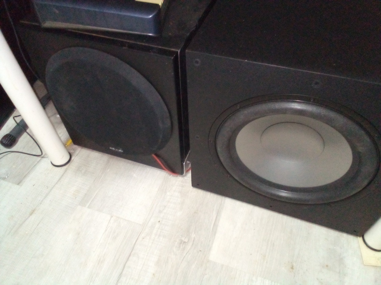

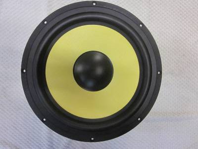

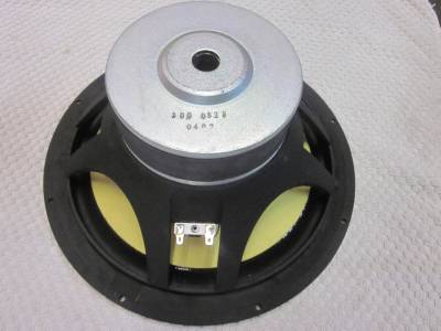

I now bought a KRK cast frame V12S woofer - part # (12inc.WOFK12202.bajo altavoz.WOFK12201). 55$ overstock.
I know the ...
Qms 1.6 / Qes - .78
Qts - .53 Fs - 33hz
Re - 3.2ohm , same as the Polk.
I wish I knew the Vas.
The complete V12S sub is commercial , and it's OEM box has an internal volume of Vb/70L. (it's vented).
Ohhh , it even matches my yellow Kevlar 5.5" satellites. I'll try it.

The Polk did not blow , but I smelled the voice coil (very little) while testing it. it still works good , and measures 3.2R. I don't see any coloration on the VC.
If like the KRK , I'll sell it (polk) for 10$ instead of burying it. I think my amp is just a bit too powerful for it. I must of ran 200W+ below the Fs , where the impedance was low. I won't test the KRK at 10hz/200W for 1/2 hour , I learned.

I tried to find out more about it (the woofer). The KRK 12S HO is the same woofer with a larger VC (75mm). By KRK's Vb and port config ,
I did get F3's close to OEM specs with Vas's (70-100L).
No manufacturer size specs. By the picture , I would estimate 240mm of the yellow Kevlar.
