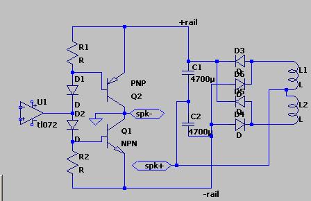

unclejed613 said:
uh, guys..... i hate to point this out........ look at the original post, and carefully at the drawing....... uh, EF output, with the PNP collector connected to the positive rail, and NPN collector connected to the negative rail........ doesn't that look a bit odd? that might explain why the magic blue smoke refuses to stay inside the transistors............
not just a bias problem, but it's a reverse bias problem.........
Look even closer, Uncle Jed. 😎
The diagram shows 2 PNP transistors, but he mentioned he made a mistake in the drawing and the top one really is NPN. That sets things right again methinks.
..Todd
I also put a new set of transistors in and run the thing off the +-15v used for the opamps and it ran fine, not entirely sure about the sound quality, its good but there are previous active filters, to get rid of the high frequency as I am using it for a subwoofer.

yeah I know what you mean, I really should have done that in the first place, but I think ive acquire sentimental value to try and get it to work correctly. Theres always going to be easier ways and ones which get the results quicker, but I'm going to keep trying when I have time making subtle improvements as I go along. In some ways its another way of learning what works, what doesn't and how all the individual section of the amplifier work together.
I'm going to buy a lower voltage transformer so that I don't keep blowing up the transistors.
In the physical design the diode would be glued with thermal cement to the transistor packages so that they heat along with the transistor to compensate for the thermal runaway and alter the bias. At the same time since the opamp follows the output it will also compensate for any shifting in bias. How good these compensations are I don't know.
my real annoyance is that I didn't want things to be too complicated and so I figured this design wasn't too complicated it had good sound quality and is quite efficient.
Ive learnt loads in the past 3 years on this project and my design has changed greatly, but ive learnt so much because of this.

learn to use the features of the SPICE software that monitor device currents. you can run a 2N3904/3906 output pair at 100A idle current in SPICE and they will still work. if you use the software to tell you what the device currents are, you'll probably find that even the circuit simulated well, the collector currents were probably way too high...

unclejed613 said:
just to have a look at it i ran a sim of your circuit. your output transistors start at 110mA idle current. that's high even for much larger output devices.
your problem as somone said earlier is overbiasing the output devices......

Sure, but you won't get a whole lot of output out of it. You could just keep the whole thing running off +/-15 and be done with it - and you'd have a whopping 9 or 10 watts.
It does sound like you're overbiasing - as you increase Vcc the voltage drop on the 51 ohm resistors is too much. It really needs to be a pot so it can be adjusted.

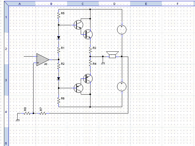

shown below is how a QSC type amp works. notice that the transistor collectors are grounded, and the power supply for the outputs has a center tap but it's not grounded. instead, the center tap and the power supply common float. the whole power supply is floated from ground. when positive-going audio is applied to the input the NPN begins conducting and pulls the negative rail towards ground, this in turn makes the positive rail and the center tap go more positive. negative going audio causes the opposite effect, making the PNP conduct and pulling the positive rail towards ground, and so the power supply and the center tap go negative. the speaker output is taken from the power supply center tap. i have shown the power transformer, bridge rectifier and caps in this drawing.

furlow said:
Okay I built a push pull amplifier, there are other various filters before this part, but this is were the problem lies. The problem I get is a large current flowing through the two transistors, from 56+ to 56-.
I've done a design that's very similar to what you're showing here: Audio Strip. This being part of a longwave receiver. Even though it doesn't use a +/- supply, that doesn't really change anything. I never had any problems with poofing transistors here, since this design includes the emitter resistors to set the idle bias current. I would definitely include these.
I would also get that rail voltage down. While having some headroom is a good thing, +/-56V is overkill. If you need that much power, you're not gonna get it from an op-amp, as those don't operate at such high voltages, and the voltage swing just won't be there.
Actually, it's the emitters that are supposed to be grounded. The trannies would connect just like in Furlow's original schematic - but the power supply is connected as in the QSC amp. The reason the QSC has grounded collectors is because they use unity-gain CFP's. Furlow was using prepackaged darlingtons.
The easiest way to wrap your head arond the concept is that the "ground" of the floating supply and the "speaker output" have their roles reversed. Simply physically swap the connections. To deal with the phase reversal, also swap the + and - inputs on the op amp. Note that this only works if the HV power supply is totally isolated from the op amps's supply - because no connection on it is ground anymore. But if I understand him correctly, that's what Furlow is doing anyway. Everything else in the QSC circuit has to do with filtering and overcurrent limit and doesn't absolutely have to be there.
Finally a schematic. Notice that this can be pretty much the same as Furlow's original circuit. It needs a bit of refinement (emitter resistors, trim the bias, lower the supply to something reasonable like +/-40) but it would *work*.
