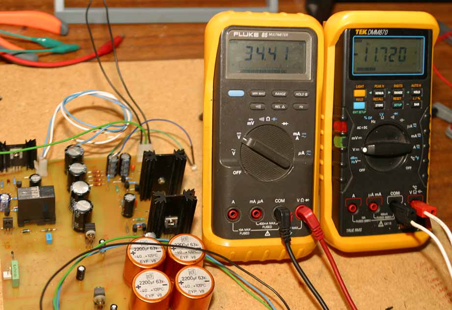

Ok I am under way.
I have disconnected the 15 v regulators, installed a dummy load, and the -35V rail is reading approximately -11.7V (see photo).
I have done the other checks and these are the results:
1. The 10V zener is on and OK (measure 10.04V)
2. Q42 (BC547) b-e 0.178V
3. Q44 (BC557) b-e 13.02V
4. Q46 (BC640) b-e 0.575V
5. Q48 (TIP32) b-e 0.642V
It would appear to me that there is a problem at Q42 and Q44.
I am looking forward to your response.
Thank you.
George.

Success!!!
The power supply is now fully functional, with all correct voltages present.
Replaced Q42 and 44 - that was the problem.
I suspect that where I went wrong, is that initially I was testing the power supply without any load.
Perhaps the P/S went into oscillation, and destroyed these transistors.
My earlier attempts to fix the problem included replacing these transistors, but I never had a load connected.
That may be why the problem replicated itself every time (had no load connected)
