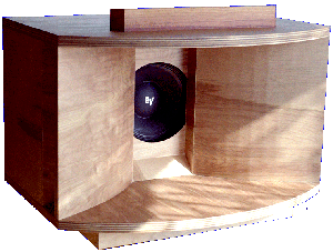

starting from scratch with a large format Synergy style horn along the lines of the DSL SH-50 or JH-90 (Jericho Horn).
I see now you were recommending build a synergy horn!
I'm afraid I doubt I could do something that complex. Would be nice someday but thinking baby steps first.
Actually, the building of a SH-50 Synergy is easier than the La Scala or some of the other folded horns.I see now you were recommending build a synergy horn!
The JH-90 is more difficult, as it incorporates a large FH (or TH, I'm too burnt after dealing with a rain/coal dirt flooded shop after a 13 hour day at work)with the conical mid/high horn.
Using passive crossovers with the Synergy type horns requires some genius to get right, using DSP is far easier but still requires measurement & integration skills.
Of course, proper optimization of Cobraflex and FH also requires measurement & integration skills 🙂.
I rough sketched a Belle to fit one 4'x8' sheet - look how an 1823M with ~30uF highpass performed on my Cobraflex vs 511 vs SM120 - wonder how much effect a curved baffle would have on the Cobraflex low end? SM120 looks pretty bad in this situation - was that from Z interaction? - short path? - both?
If you know of any plans for building a synergy horn I would love to try one for my own rig.
As far as designing and planning one from scratch, ... that "woosh" you hear is the entire modern sound industry flying away over my head...
-It seems like I just wasted a few evenings googling as much as I could about "synergy" and Unity type horns and I really came away from it bewildered.
Speakers, DIY and the PA industry have all seemed to have gotten so complicated I've decided it's not worth the race to keep up (It's like trying to have a current and non-obsolete computer 🙂
For this project (and my own PA projects too) I'm going to stick with what I know.
Therefore the cobraflex will work fine along with some basic reflex boxes with 15's in them. As that is exactly what I'm accomplishing everything right now and it works quite well and can perform much louder than they want to go!
I have an old Shure P4800 DSP running the setup for now and can actually boost the bass a bit if needed without eating up all the headroom I have. I was originally thinking one or 2 horns would replace the 4 boxes I'm using but in the long run I can slap together equivalent boxes cheap and easy without ever having to miter a single panel 🙂

Probably out of my range -hell, I don't even know what "FIR" is, or "IIR", or an "all-pass filter" and still wondering what's so damn important about an "end-fire" array yet everyone seems to think they are vitally important to good sound. All I know is that nobody has ever faulted me for a bad mix or poor sound on any of my installs 🙂Using passive crossovers with the Synergy type horns requires some genius to get right, using DSP is far easier but still requires measurement & integration skills.
Got that, -it took a while and a lot of back-and-forth running across the field to listen and verify but overall everyone is impressed. I really don't have a good measuring system here with me other than my ears🙂
