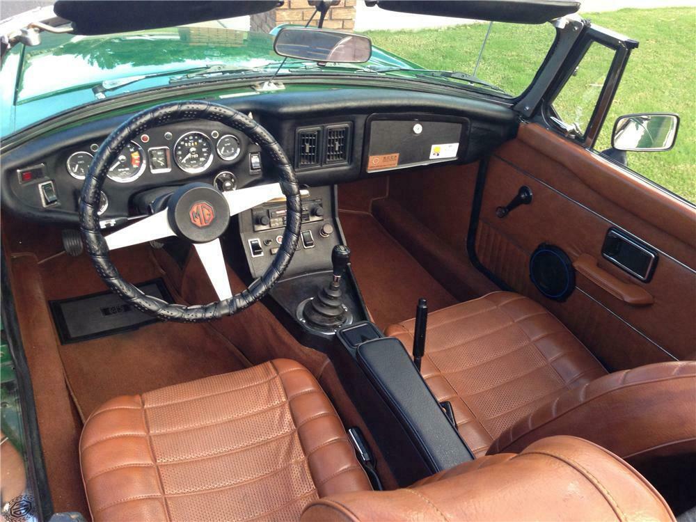

there aren’t many options in there!
what about underneath the dash of the passenger seat ?
speaker under the bonnet playing through the centre dash air vents ?
woofer under the seats ?
That looks almost identical to my interior, "Thank you" for posting this photo.
Yes, there is almost no room to work with. Your photo shows the speaker in the door. My panels were never cut for speakers. Yes, the metal behind it has the factory opening, but the panels are not cut. If I ever opt to restore this car to original condition, I can't be cutting them...
Unfortunately, those interior center dash vents are direct to the exterior. There's a metal grill in front of the windshield. If you are standing outside the car and look down inside this grill, you will see the top of the vent box. The only thing between the exterior and the interior is a metal plate on a hinge operated by a lever beside the steering wheel. Even when the plate is in it's closed position, air still flows (much slower) through those interior vents when driving.
Not under those seats, but the GT is a 2+2. Sort of.
HAHAHAHA, "sort of" Yes, you know the car!
To say it's a 2+2 is rather misleading. It's really more like 2 + a dog and a picnic basket. I'm willing to lay money down that NOBODY ever got pregnant in the back seat of one of these cars!
The bottom of the rear seat is nothing more than a board with some foam and a leatherette covering. You can unclip it and swing it forward to access the battery compartment. No way of putting anything under that seat that is thicker than a tabloid newspaper.
Under the main seats, a person "might" be able to slip a thin amplifier in there. The underside of the seat is webbing and flexes a lot. Hitting a bump, it is quite likely that you would feel an amplifier unless it was really thin. There's no way you'd get a speaker under it.

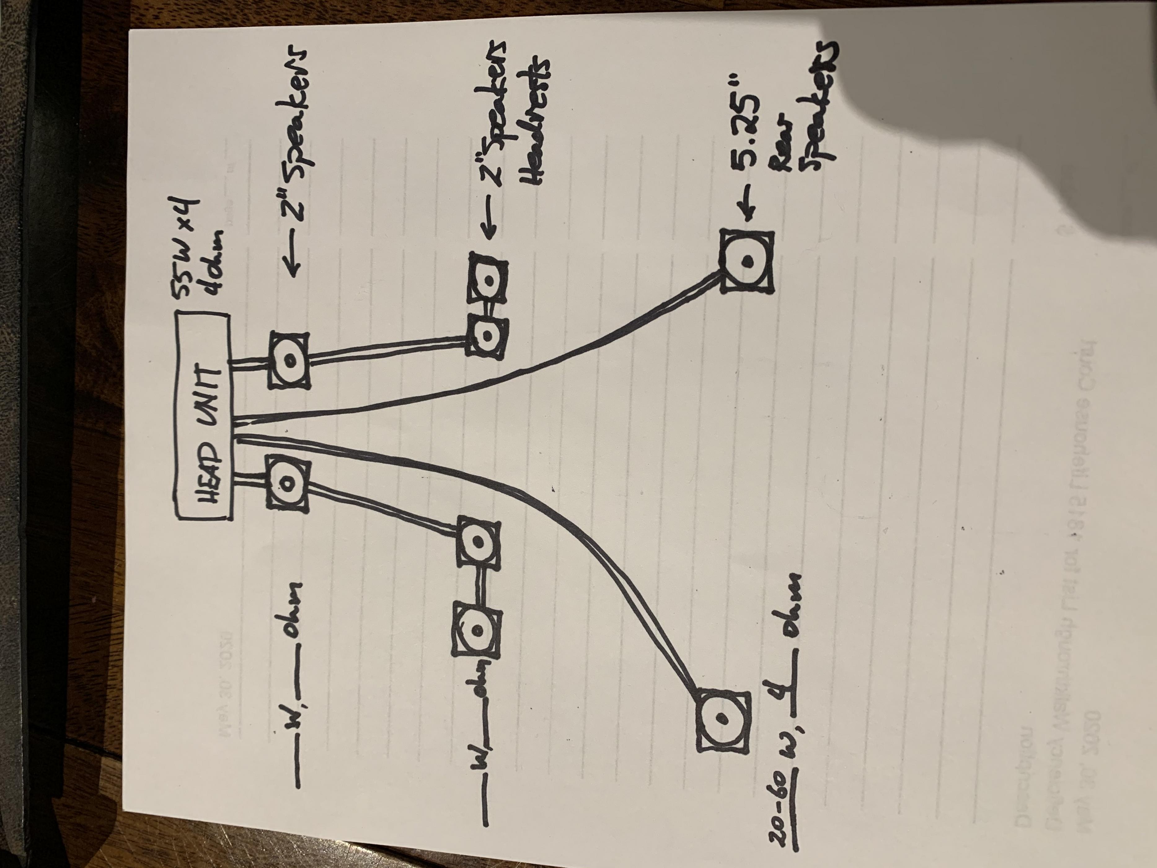

2 speakers in each headrest. I will lose stereo effect, given 1 channel will run the left headrest (speakers on both left and right side of the headrest). And 1 channel will run the 2 speakers in the right headrest.

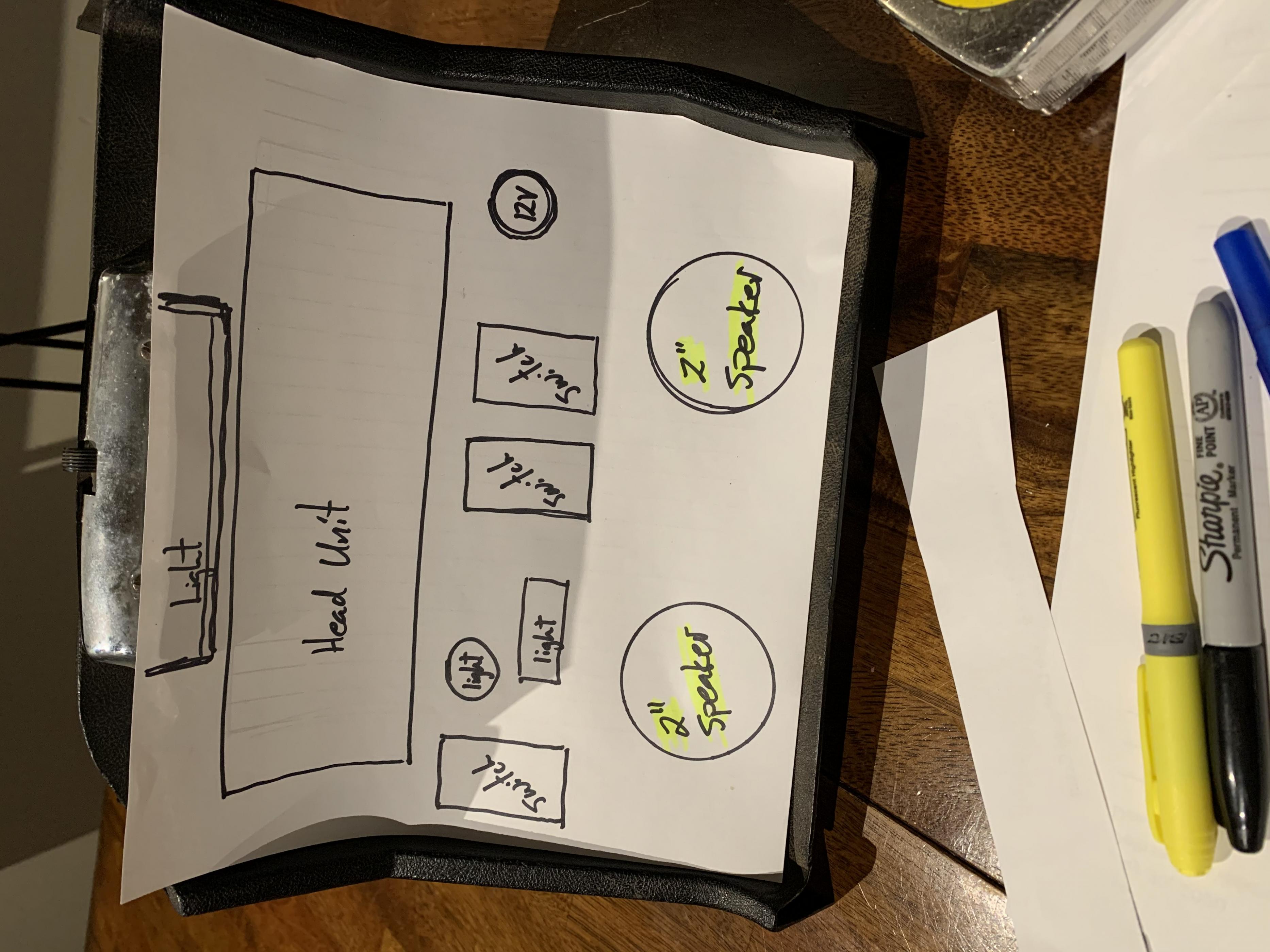

I'd love to have speakers up front, I just don't know how I could pull that off as I refuse to cut into the car. I'm willing to forego a lot to avoid cutting into the car... The butchered center console I have is absolutely fair game as I will need to modify this somewhat in order to slip in a new head unit anyway.
possible layout
Okay... Thank you to everyone who has responded. I am very appreciative of your input to my situation.
Please see the attached photo's.
Console:
I know that I will need to do something to fix the current radio cut out. My intention was to pick up a black HDPE cutting board like you would use in your kitchen. Cut and file it to shape and use heat to mould it into the curves. cut out the required holes for the switches and it would look relatively stock.
So many here are pushing for front sound and I absolutely agree. I'm just not sure how to accomplish that. There were comments on placing speakers in the lower console area below the switches. If I cut out this area, I know the hump for the transmission is almost touching the bottom of the plastic. There's simply not enough room. Instead of using HDPE, I can use wood... I have plenty of that laying around and if finished well, would provide a look that is fitting of a vintage British car.
So let's assume I can slip a 2" speaker (might be able to go just slightly larger) in this area. If built up with wood, I could gain an easy .5" to .75" in depth without it looking ridiculously out of place. I wish I knew exactly how much room was under that console. Let's assume another .5" (it may be closer to .75"). I need a speaker with a maximum lower depth of 1.25".
Headrest Speakers:
Each headrest to house (2) 2" speakers, speakers will be located on to outer portion of the headrest pointing forward.

Front Left channel to run left console speaker, driver's headrest speaker (x2).
Front Right channel to run right console speaker, passenger's headrest speaker (x2).
Rear Left channel to run 5.25" speaker
Rear Right channel to run 5.25" speaker
What speakers would you recommend (size, model, watts, ohms) and for the front, how would you wire them?
