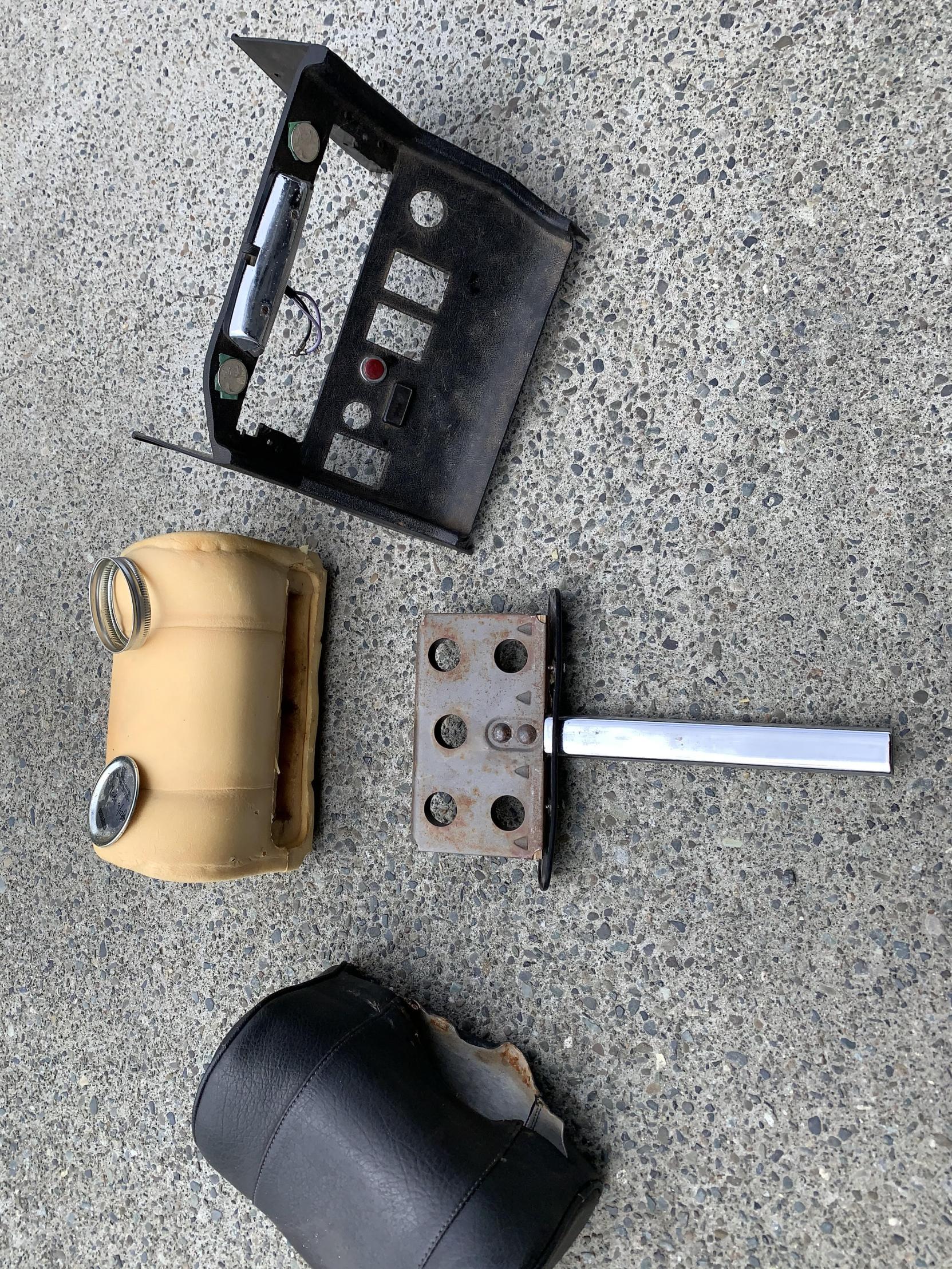

In my introduction post. The moderator has indicated that I can upload pictures. I will absolutely do a photo log in this thread for those who are interested in following along as I proceed with this build. That's certainly fair as I will be leaning on many of you to make this happen.

leadbelly, that's the problem. That sacrificial center console is not big enough to house much more than the head unit itself. Hence, I'm into a custom build... with lower power, headrest speakers make a tremendous amount of sense. To be heard, they don't need to be massive and won't require a lot of power.
I'm pretty sure I've seen custom work where the speaker is almost fully proud of the console. Making some fancy multi-part bezel to allow it to work still sounds easier to me, but not everybody I guess.

headrest and center console
Attached is a photo of the spare headrest I pulled apart and the semi-butchered center console I will be working with.
Center console:
You can see where I taped some $0.25 coins on either side of the map light. that's the space I have to work with... about 1.25" (32mm).
The space below where the switches are could possibly be utilized to some degree. The hump for the transmission fills up most of the space under this cover. Since I don't have the car here, I'm not sure how much space I may have to work with in this area. I know it's not much.
leadbelly mentioned doing a fully proud custom speaker enclosure. It would have to be on the outside as the console sides screw into the heater vent box to hold the console in place. An exterior console install could be done but it will seriously intrude on the side to side leg room. These cars are SMALL! haha. When my father-in-law or even my wife is in the car with me, we are practically touching shoulders.
Headrest:
I've placed a small canning jar lid on the foam. This lid is approximately 2.75". So again, you can see there's not a lot of room to work with here either. A 3.5" is out of the question. A 2" would work well and a 2.5" may also be an option. I want nothing in the middle area simply in case there is ever a rear end collision and that crush zone needs to be utilized for it's intended purpose.
I'm fully capable of creating a slightly larger headrest and sewing a new cover to accommodate it. The hardest part of that design is going to be matching the tan color of the factory seats that are in the car now.
Hope this gives a bit more understanding of what I'm up against of space.
