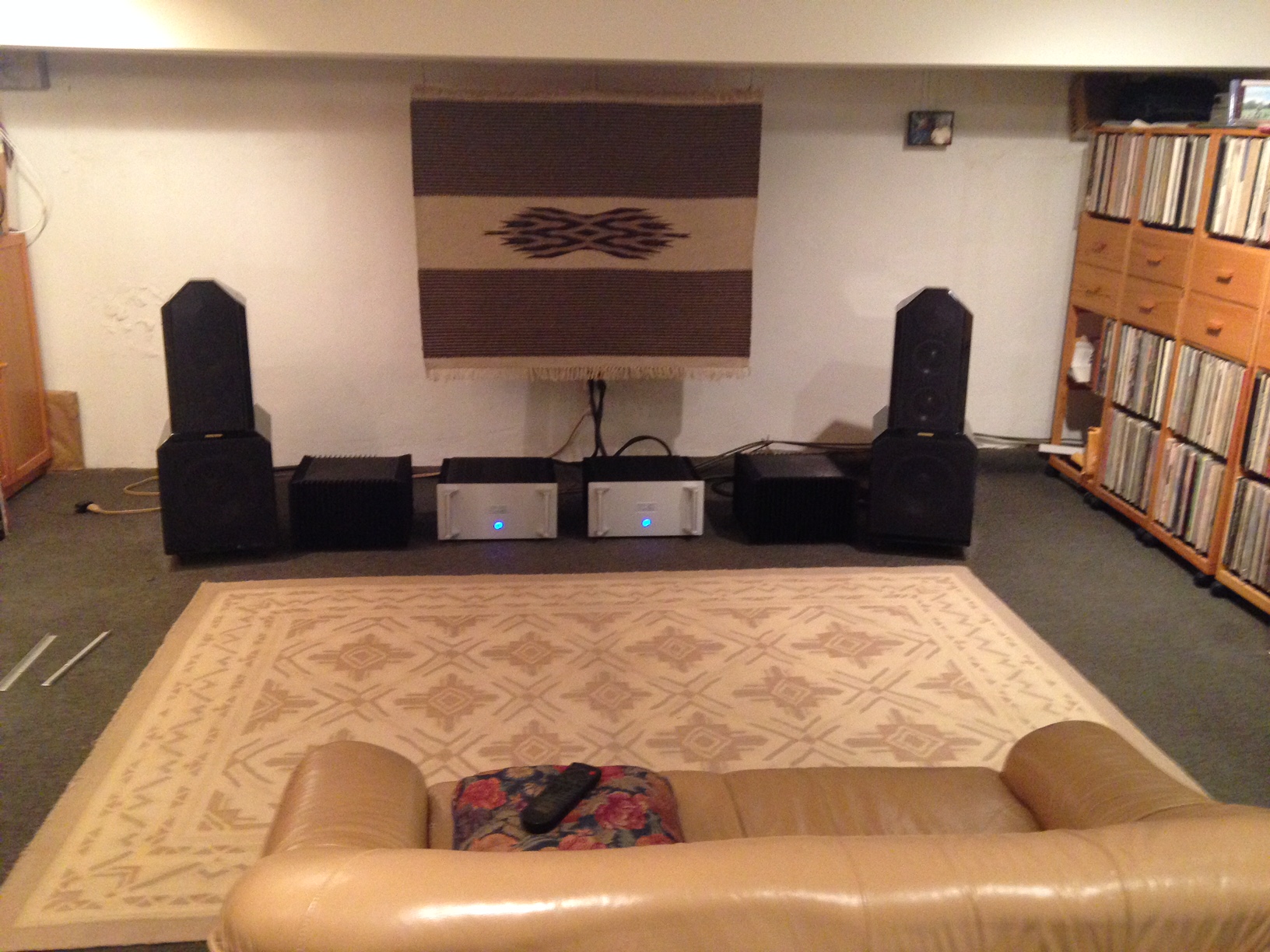

Been using illuminated see-saw type switch (back) to power my amps both 4 channel Leach Super Amp and F4 balanced. Front, both 1/4" DIY aluminum plate. My wife says I need to move the switch in front coz they're afraid to reach their hands at the back of amp chassis.

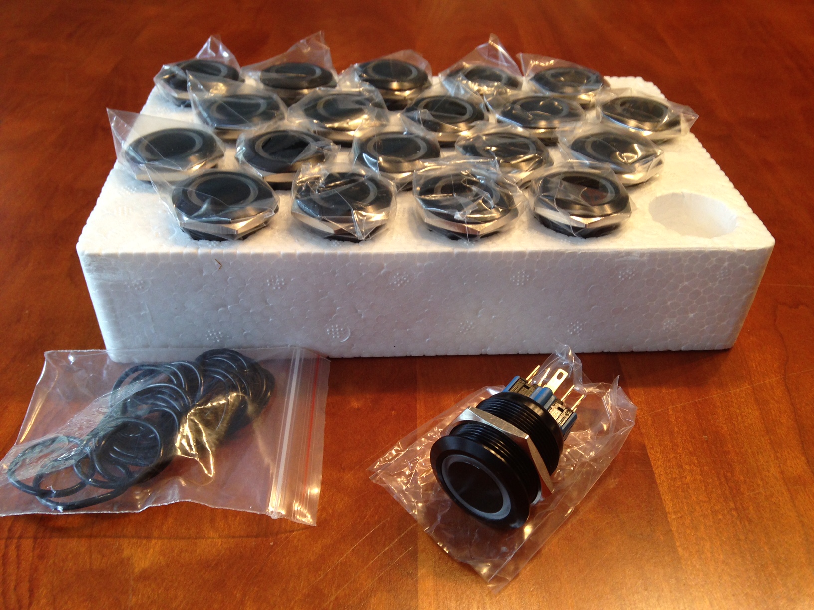

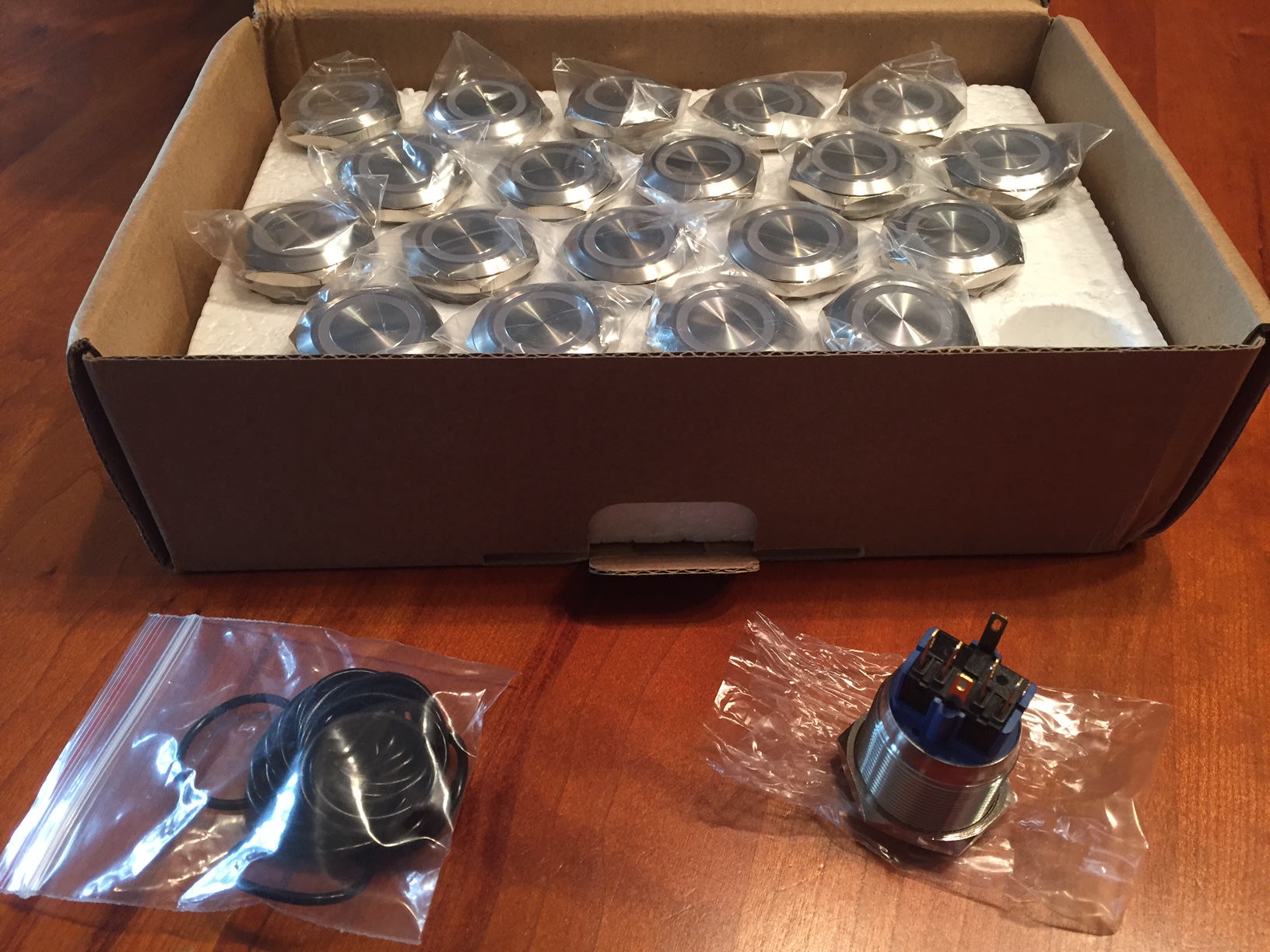

rolandong:
I have a particular affinity for illuminated anti-vandal switches and have hosted three small group buys to distribute them (see Large Illuminated Anti-Vandal Switch, Large Illuminated Stainless Steel Anti-Vandal Switches and, more recently, Large Illuminated Anti-Vandal Switches (Round 3)). If you like this sort of switch, you might consider hosting your own mini-group buy; my experience (admittedly in the US where a large market for these switches exists) has been very positive. I have found Langir to be very easy to work with. Langir's price per unit is about $8.00 (US) plus shipping.
Just a thought.
