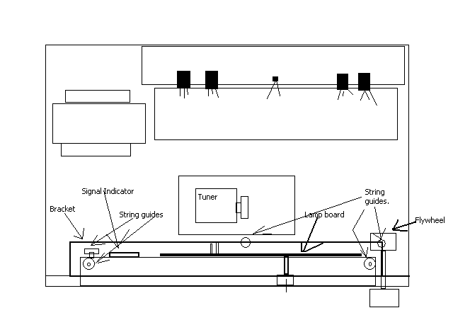

It can, but there is very little play in it... And the board itself is fragile. There are a couple of screws holding it in, but the back part of the indicator and display get in the way. Now if I remember correctly, there were actually two or three different versions of this (original, reissue, and maybe a tube version (I've heard rumors, but never saw one)).
I am including a picture I drew from memory (using paint prush). If I remember, the string for the tuner gets in the way if you try to approach the board from the back. You may have to remove the string., or try to get it out of the way enough to work on the lights. I know I am missing somthing else that makes approaching it from the back difficult, but cannot seem to remember what it is.
Wow, I'm impressed! Very well drawn from memory.
And you are right, taking the rail off from the back in problematic, for the reasons you mentioned, and I notice that the housing for the stereo indicator light is attached pretty well to the front metal plate that the tuner face was attached to, so the rail wouldn't detach easily from the metal plate anyway.
