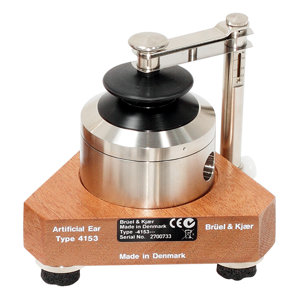

Acoustic measurements reveal a horrible frequency response - barely usable from 200hz to 3Khz.
HOW did you measure that?
Did you drive earphone from an amplifier, sweeping then Audio band with an oscillator and measured frequency response with a calibrated microphone some distance away?
Earphones are NOT meant to be used in open air but into a closed or semiclosed cavity, our ear canals, so there are specially built "artificial ears" for that.
https://www.bksv.com/en/transducers/simulators/ear-mouth-simulators/4153
Not what you´d expect:
