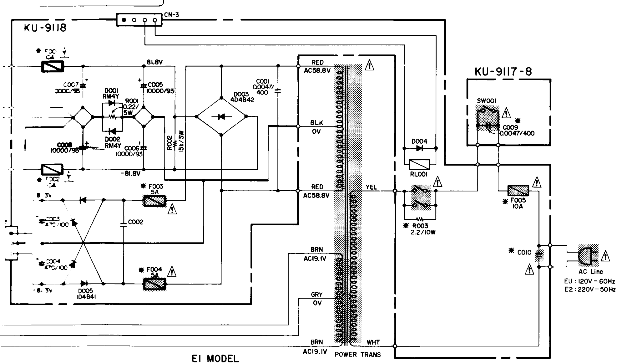

I know, the images are a lil rough... all that is available online and probably lucky to have this much. I was going to ask about that R003 resistor, if that is what you where referring to as being intriguing. I sorta thought it was bypassing the relay contacts for a control circuit on another board in the amp. In order for the relay coil to energize it would need power from somewhere and this is the only place it could come from.
Appears that R003 acts like a soft start to save the switch contacts and is then shorted out by the relay.
Seems this relay has a control transistor related to a plug marked remote. The back panel has a DC input, which may say remote, and the front a standby light.
http://www.amplimos.it/images/Denon POA-6600 Schematic.pdf

Thanks friendly. It is nice to have the schematic stitched together on a single page, mine is spit up over several.

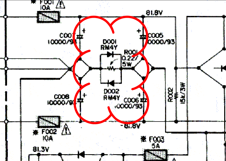

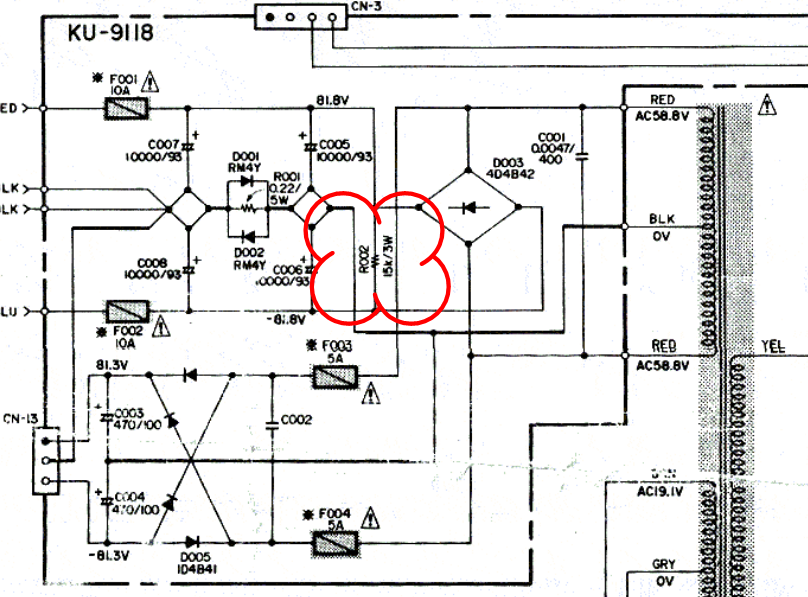

Like I mentioned in my OP my knowledge of electronics is very basic. Can i ask you what you think the purpose of this R002 resistor is for?
And this cute lil set of diodes and resistor between filter caps:
R002: Bleeder resistor for the big caps.Can i ask you what you think the purpose of this R002 resistor is for?
R001 +diodes might be a 'ground loop breaker.'
