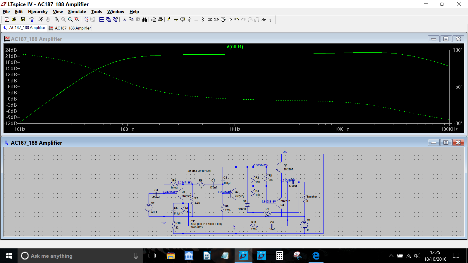

Identifying the relevant resistances will not be straightforward. For the cap between the first and second stage you have to consider the output impedance of the first stage and the input impedance of the second stage.
The first stage output impedance will be a bit less than 3.3k, because the resistor has the first BJT collector in parallel with it and there is negative feedback via the 1M resistor. The actual impedance here will depend to some extent on the impedance of the signal source. It all gets complicated, so I would assume 3k and not worry too much.
The input impedance of the second stage is set by its current (9mA?) and its current gain. Then in parallel with that there is the 120k resistor. Wild guess say around 5k.
Then there is the 1k series resistor so you get a total of 9k to combine with the 640nF cap.
DF96 explains it well. Everything interacts with everything else to put it simply.
I had the 3k3 as 33k (oops)

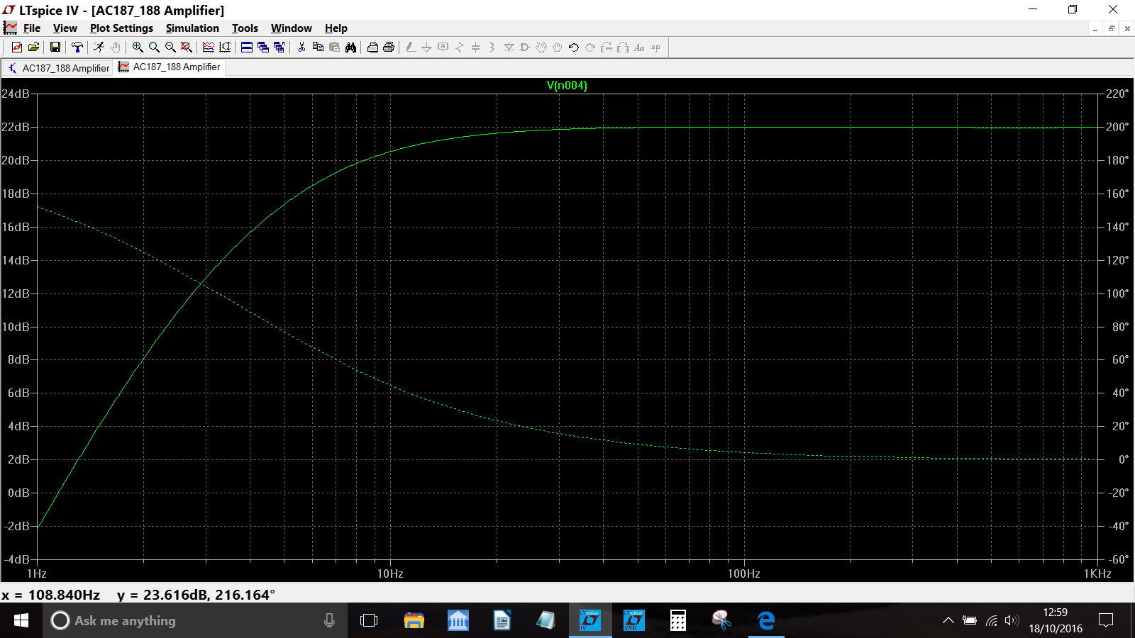

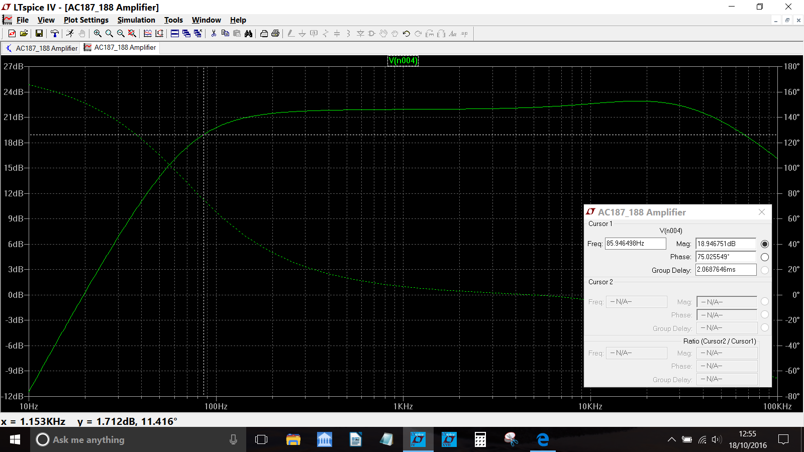

Do you want the simulation file to play with ? It will run straight off in LTspice. And here is the response with 3k3 instead of 33k.

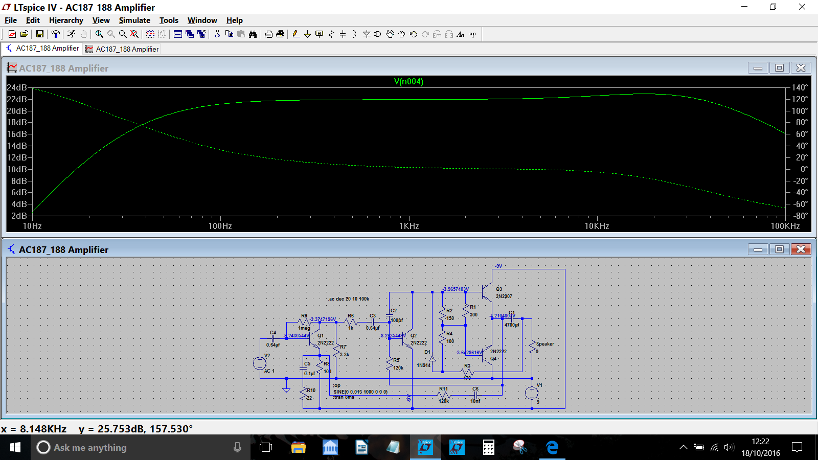

Can you please just try how it looks with 150nF input cap and 470nF for coupling? I promise I won't bug you anymore.
Bane

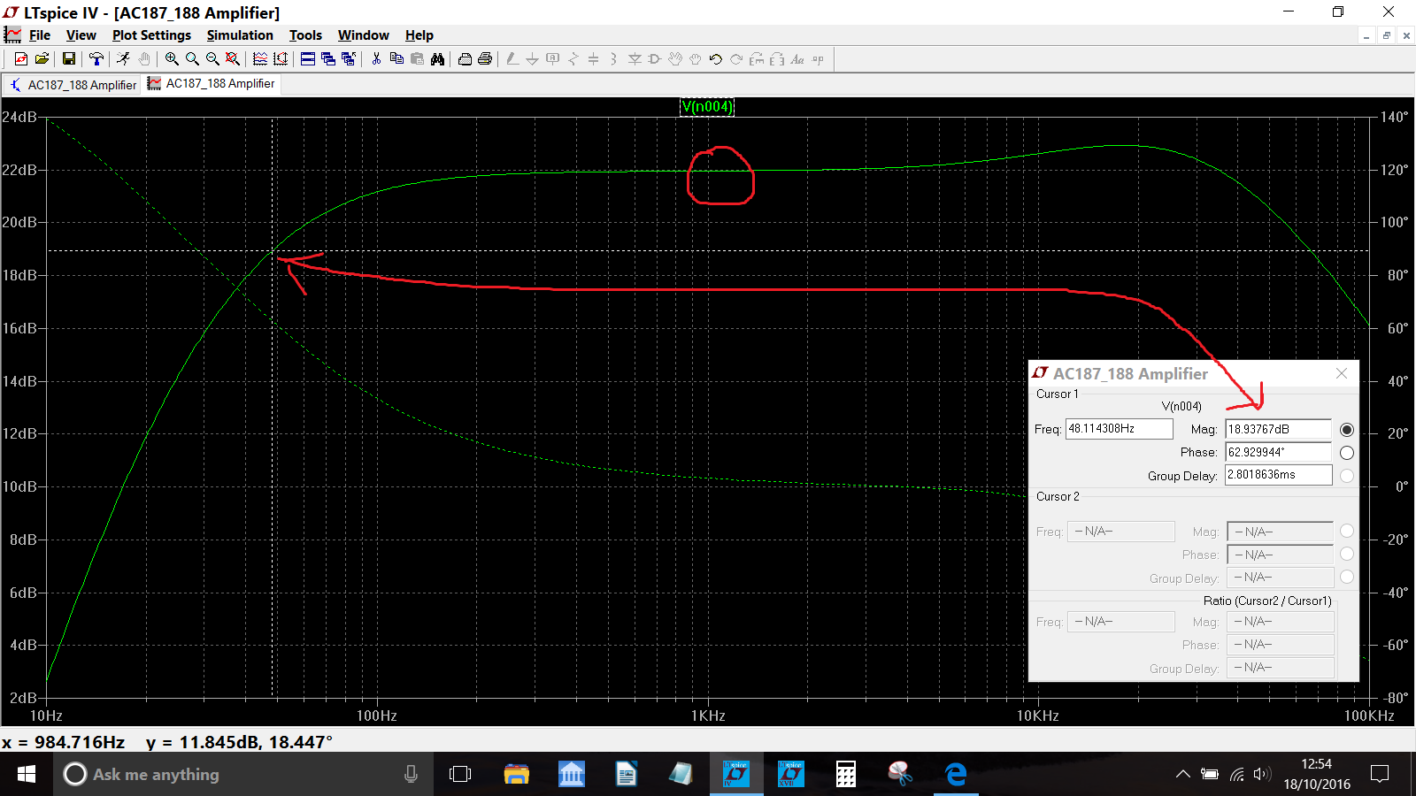

thank you, this is very helpful. I put the two plots on top of each other and stretched to match the scale. Looks like the roll-off starts around 300Hz in the second one and it's around 2db lower at 100Hz. I'll probably add some capacitance to flatten the response between 100Hz and 300Hz.
thanks again, I owe you a beer or whatever you like 🙂
:cheers: and your very welcome 🙂
Here is the original with 0.64uf and yours with 150/470nf. You can see where the response is 3db down from the 1kHz point.
Yes. Although, some bass roll-off is desirable here, otherwise it may sound farty or boomy when it gets overdriven by strong guitar signal. I'll try it tonight with my guitar speaker. It also has roll-off around 100Hz (plot is below). If there's not enough bass, I'll just add another capacitor in parallel with the existing ones. Btw, my output capacitor is 470uF instead of 400uF, so it may compensate for some of the bass loss 🙂
Cheers

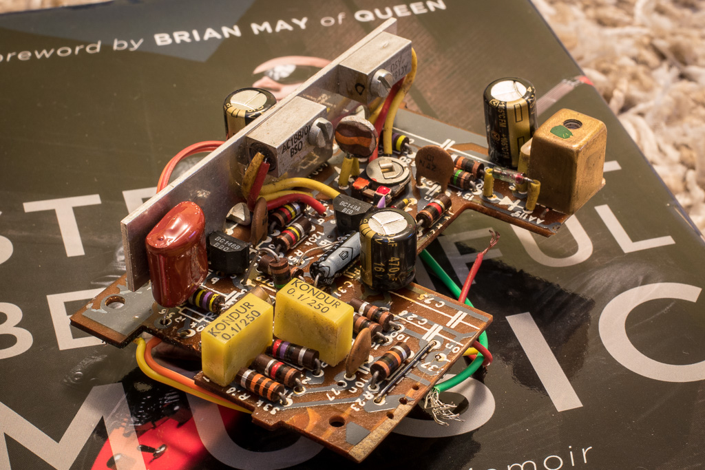

Reporting back, I tried two variations and I think there's slight difference in favor of higher capacitance and I stuck with 0.47uF in fist and 1uF in the second position. It sounds just awesome with my Strat guitar. Very clean and warm...and very similar to good tube amps. There's slight breakup when pushed hard, but it's very pleasant. And it's surprisingly loud. With my efficient guitar speaker it's much louder than the regular TV level. Even maybe too loud for apartment.
Thanks to both of you for your help.
I haven't seen carbon composition resistors like that since the mid 1970's when the last plant here closed. You might want to check the actual values before assuming the markings are correct, since their drift could be in the hundreds of % :dodgy:
yes. The couple I checked are in the +10-20% range...but I won't do anything about it as it sounds really good 🙂
in some tube amps I've played with, the old carbon comp resistors look kind of dry and crumbly, but these look really good. I have some new production carbon comp resistors and they look about the same.
